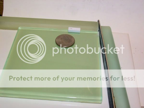

Starting a project I was faced with needing to file/sand styrene at 90°. I remembered a post in this thread and found it .. by '6100' .. on what he calls a 'Shooting Board'. I went to Lowes and in the discount section found some tiles that worked to make my own. The ceramic tiles were of little use since the edges are rough .. but the glass tiles .. are nice and smooth. A 6"x8" white ceramic tile for a base, a 4"x4" glass tile and a couple of glass trim pieces, some epoxy and I was set. THANKS! It works .. I get perfect right angles now.
Country: USA | Posts: 1945 Go to Top of Page
Posted - 07/24/2010 :  3:28:31 PM  Show Profile  Reply with Quote
Ed, that's a very interesting idea, using glass tile pieces for a right-angle set-up board.
Country: USA | Posts: 3694 Go to Top of Page
