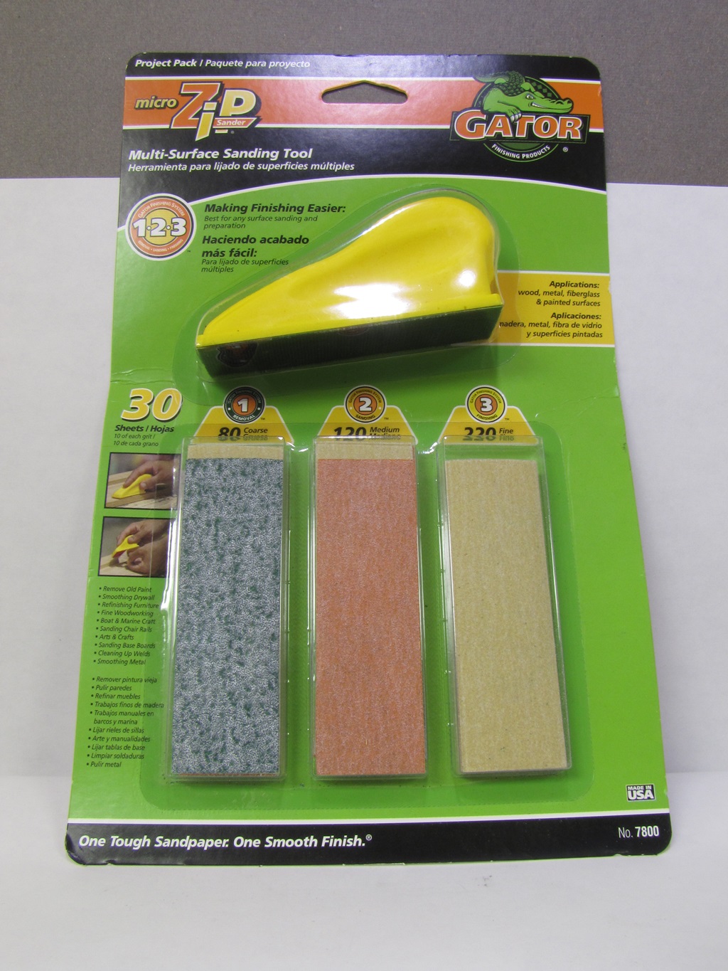

Had to go to the hardware store to get a bottle of glue. While there I like to go down the isles and see what might want to follow me home. Well in the same isles as the glue I saw this.
Being the ultimate DYIer I've discovered that in order to get anything done I need to stop trying to make my own tools and just break down a buy the tools. It sometimes takes me longer to build my own tools than buy them. Perhaps now I get some of the railroad related projects done.

I picked up one of those last month, but with only one type of grit. I will have to look for the one you found.

Posted - 11/11/2016 :  7:44:29 PM  Show Profile  Visit Bernd's Homepage  Reply with Quote
Jeff S.
I got mine at an Ace Hardware store. They also carry the refills. Best thing I've found so far for sanding small items.
WWG1WGA
Country: USA | Posts: 3605 Go to Top of Page
jschumaker
Posted - 11/16/2016 :  1:32:32 PM  Show Profile  Reply with Quote
I have found it works well sanding metal items. I have used it on some old HO Roundhouse all metal kits.

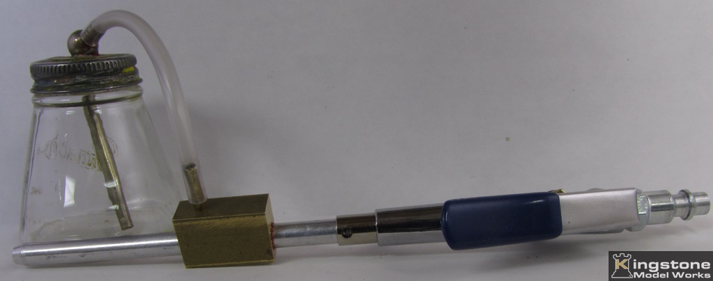

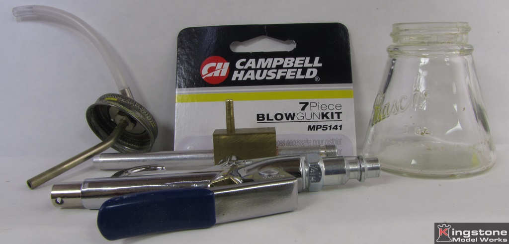

I couldn't remember this was an on going thread. I was looking at posting my home made baking soda blaster here. I'll move it here. I had originally posted it in the Geezer thread. So here goes.
I've looked at the Horror Freight one and think it costs a bit to much, so I made one. The pictures should show what's used. Any questions will be answered to the best I can.
I basically drilled out a block of brass to fit the blast pipe into. I Loctited it in place. Then I drilled a cross hole and stuck in a brass tube in. I'm using a Passche 3oz. paint jar.
All assembled and ready to go.
Now I have to get some baking soda and have at it.
WWG1WGA

I experimented a bit with a Harbor Freight Air Eraser using baking soda experimenting with eroding cracked plaster. Suppose a small stiff brush would have worked as well but .. shrug .. had the tool so why not? The biggest thing out of that is it needs to be used either outside or with a paint booth .. the dust from the baking soda is very heavy.

Bernd, I have a small sand blaster by Gilmour that I was never able to get sand for it. Are you saying that baking soda will do the same job for me?
I'm pretty sure it would work. Buy some soda and give it a try.
I just threw the one I pictured together quick like so I could get the boxcab's painted and done. The blast nozzle needs some refinement. It'll suck the 3oz. bottle empty in no time. I think I'll make a bigger hopper for it and a smaller nozzle. I'm hooked up to a 5hp 220volt two stage compressor with an 80 gallon tank in the garage.
Baking soda is a finer grit than the silica sand. It, baking soda, works nice on plastic. Gives it a bit of tooth also. Great for removing lettering too.
Also here is a link you might consider. http://www.letterville.com/steps/hines/ keeps the fog out of the basement.
Great find. I think I'll build me one of those.
@ Ed, ya it does fog up the basement. Then you have a salty taste in your mouth to. Looks like a sand blasting cabinet is in my future.
