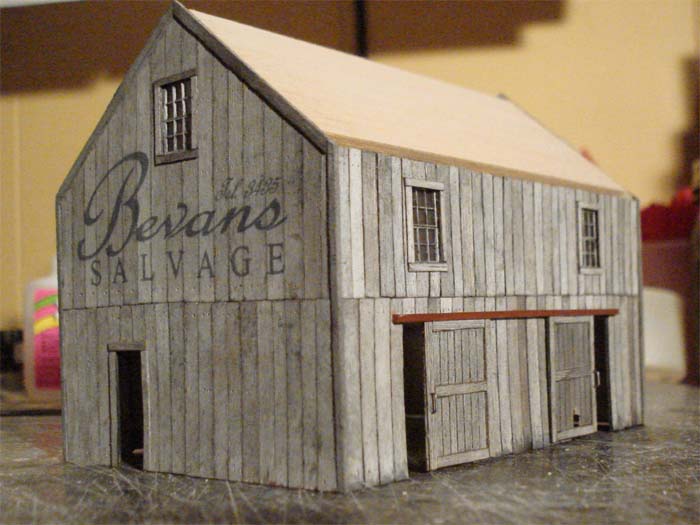

the walls were first painted with two coats of thinned white craft paint. Then when dry Alcohol/india ink was applied to get a grey look. Sorry I didnt take any pics of the walls in progress but here is one of another scratch I'm doing, the walls will have this colour more or less.
Then I used the terry cloth method to dab on the white paint. As you can see from the scrap at the bottom of the walls I dabbed off some paint before applying to the actual wall area.
I made up the colour in 3 or four layers as necessary to try and prevent any pattern showing and also variety. I also tried to add more paint to the top of the walls where the paint would be protected from the elements by the eaves and thus appear less weathered.
Hope that helps
Karl.A

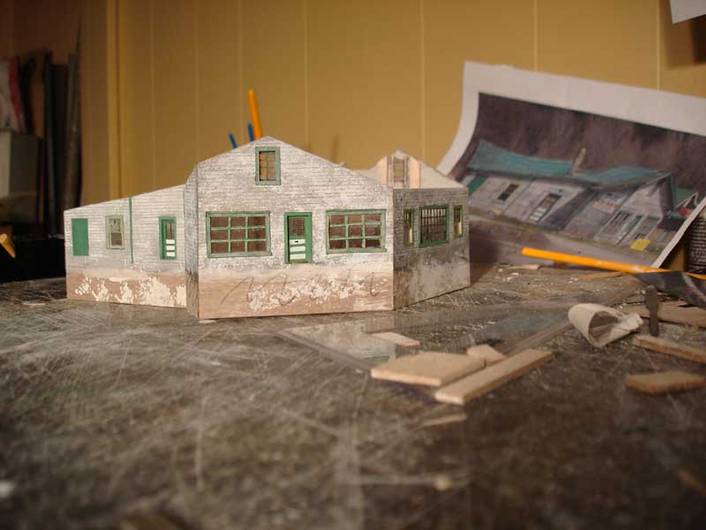

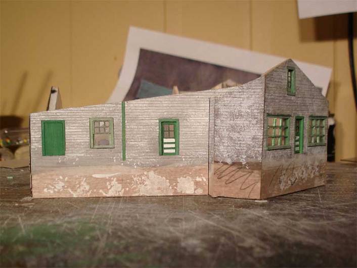

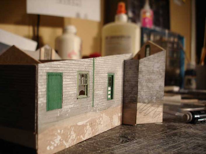

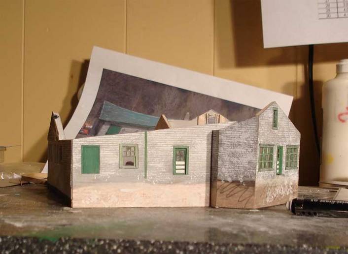

Thanks for the encouragement. This has got to be the hardest subject I have tried to photograph ( not that there are that many subjects or photos to compare to ), no matter which angle I point the camera from, everything looks 'skewiff', off kilter and to coin the title of this thread ... 'cockeyed'.
The building is basically just two rectangles side by side, all plumb, all true and all square (except for the two front walls of course).
Looking back at my photos, this one has got to be the most misleading and miss-representative of the bunch.
Its hard to see from that pic , but the wall where the freezer door is (far left) and the wall with the 36 pane window(far right) are actually at a 90degree angle !! Hopefully I'll post a scan of the actual footprint in the next day or two and a few 'elevated' shots so an overall view can be seen, which may make things clearer.
