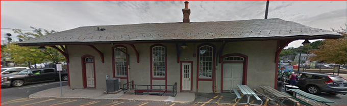

Cleaned up a 1 X 2 foot area to start this Challenge.

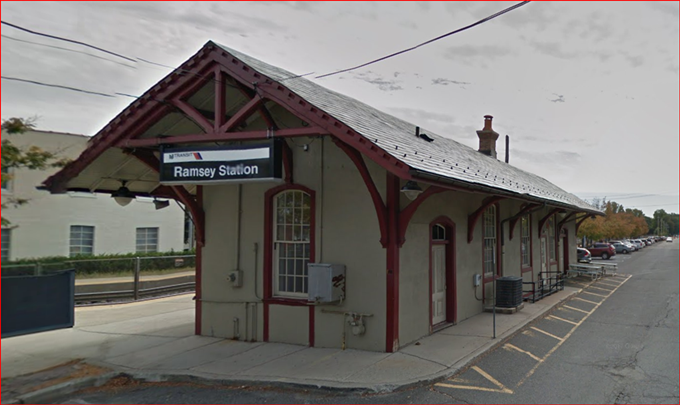

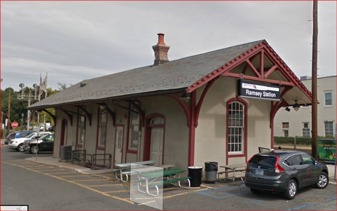

I did some research earlier to see if the station still stands. A Google map search showed it was still standing and in use by Amtrak.

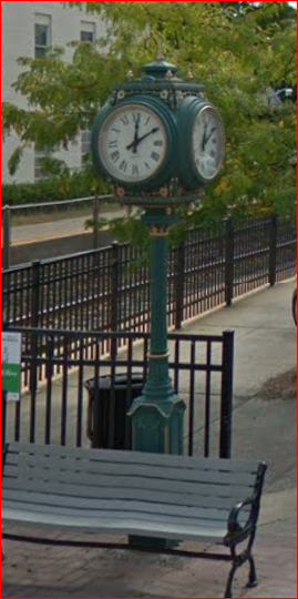

I'm debating as to whether I should try and model the clock.
There was a write up on the kit back in RMC on March 1983. Thanks to forum member wvrr, Chuck for that information. The write up was pretty spot on of the description of the kit. As simple as it looks it's definitely not a beginners kit. There are some minor flaws with the kit such as the pre-cut walls were not on the mark as far as length, plus the walls need to be pieced together. If it weren't for how the windows were laid out it would be hard to figure out what pieces mated to what. Also there is no dimensions given on the drawing as to building length. According to the write up one wall is longer than the other. You can get some idea of length and width from one of the drawings.
Note at the bottom it says that the elevation drawings are ½HO. So the building is approximately 8.240" or nearly 8¼" long. Also just noticed that the chimney looks like the original with a stack added to it. Drawing states that the modernized version had the chimney offset to the back.

I think there's a model close to the Ramsey station clock. Check the Walthers catalog, it might have come from a German company.
Country: USA | Posts: 6891 Go to Top of Page

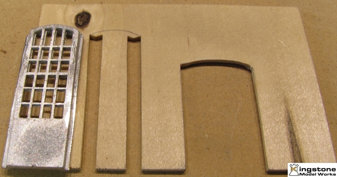

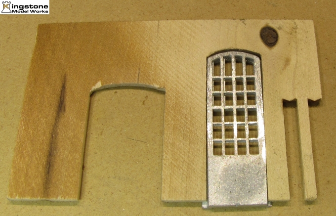

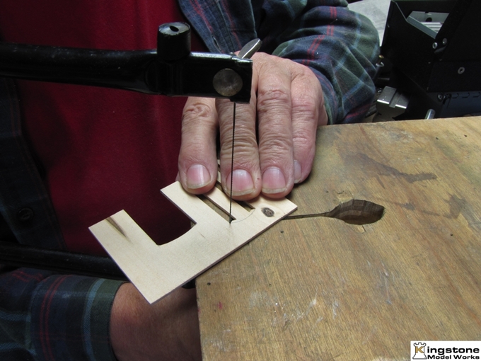

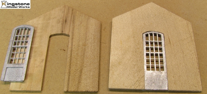

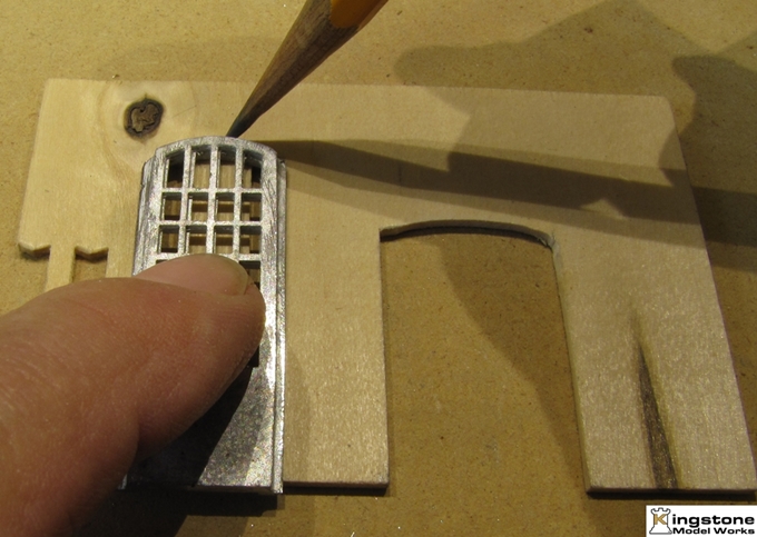

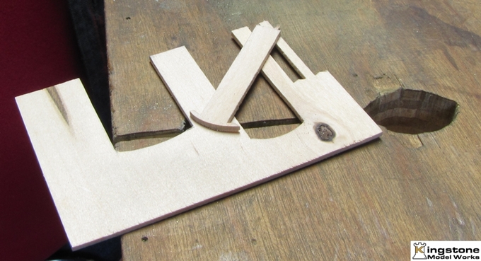

Had some free time after a bite to eat and the first cup of coffee so I went to the railroad shop and worked on the station. I started by cleaning up the soft metal castings. I then worked on fitting the castings into those cut outs the kit manufacturer made. So last night I did the two ends.
This one shows the front and back. The curved top was sanded to fit the window contour for a very close fit.
This one shows the cut out. Sort of redundant but everybody likes pictures, right?
So this morning I came up with a better way of removing the access material by making the curve between the two cut outs and using my fret saw with a fine toothed blade to cut out the material.
Now I just need to do a bit of sanding to make it fit.
That'll be it for a couple of days. Need to go out now and shovel the frozen water to move the vehicles back were they belong.

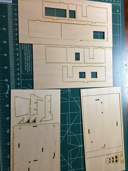

The Do-Drop-In construction has begun! First I try not to have the same buildings as everyone else, so I wanted to make it unique. After examining the kit the first thing I decided to do was flip the building which was easily done by turning the foundation piece over. The next step was to figure out where all the walls were going to go and I modified the location of the back door, bathroom and utility room.
