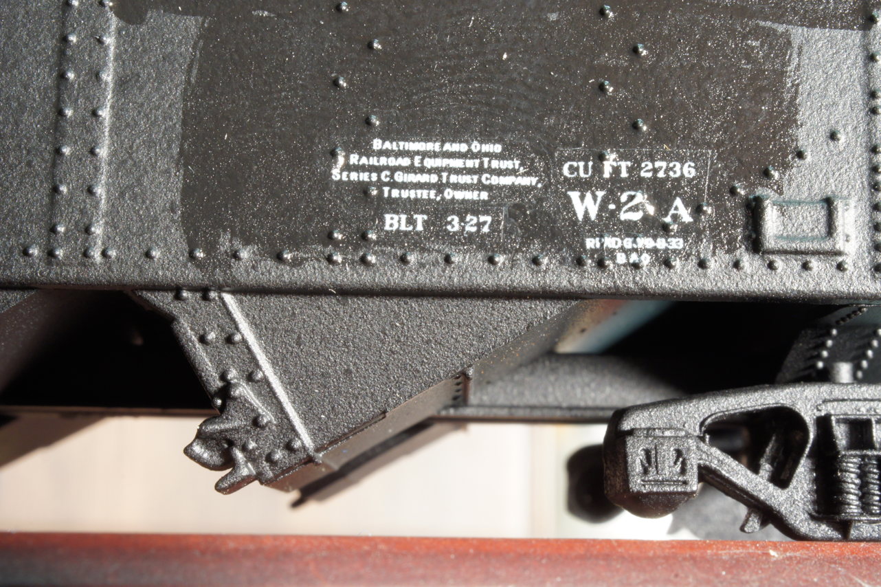

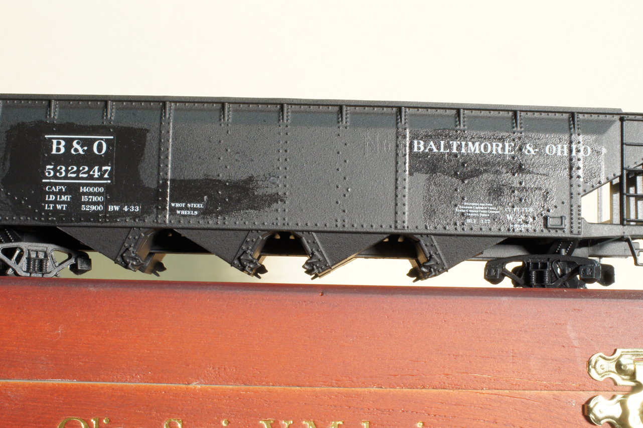

These aren't mine, they're from the guy who told me about this. This is his first run through the printer (HO scale)
A close-up to check resolution on the really small lettering

The 'cheap' model looks like you just get a white toner without the CMYK toners. The more elaborate kit for $1300+ is RTR. They are pretty sharp images.

Posted - 06/26/2017 :  8:20:05 PM  Show Profile  Reply with Quote
That's right, it's the white cartridge instead of the black cartridge.

Posted - 06/26/2017 :  10:06:17 PM  Show Profile  Visit jbvb's Homepage  Reply with Quote
The B&O decals look decent as best I can tell. I wish he'd done his test application to a body that had been thoroughly stripped and then carefully airbrushed.

Posted - 06/27/2017 :  06:17:49 AM  Show Profile  Reply with Quote
Dave, How were those B&O decals printed? Inkjet? laser?Did he use white toner? white decal paper and print black? ALPS?

Posted - 06/27/2017 :  4:30:07 PM  Show Profile  Reply with Quote
HP laser using the "Ghost Toner" cartridge. See my earlier post for the URL.
