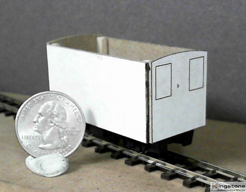

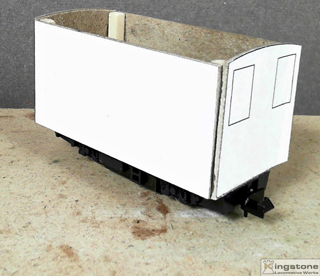

Posted - 01/01/2015 :  10:35:15 AM  Show Profile  Visit Bernd's Homepage
Ok, I'll jump in here with my entry.
Having choosen, #4:Imagineering, my entry will be the construction of three electric boxcab's for my "to be" quarry railroad, an HO 30" gauge line.
My inspiration came from several places. The Gazette ran a couple of scratchbuild articles on electric boxcabs. Another was a Japaneese modeler by the name of Junior Yamachi.
Some of his work.
http://on30center.com/on30/library/articles/JrYamachi/es/es.html
http://on30center.com/on30/gallery/jryamachi/eml.html
Plus a couple of pictures from surfing the net.
They are going to be two axle boxcabs for hauling stone from the rock bunker to the yard were they will be assmbled into a train to be hauled to a standard gauge interchange. That will be another project, designing and building a bigger road locomotive to haul the stones over the so called main line. Hopefuly this explains the inspiration and the research for ideas.

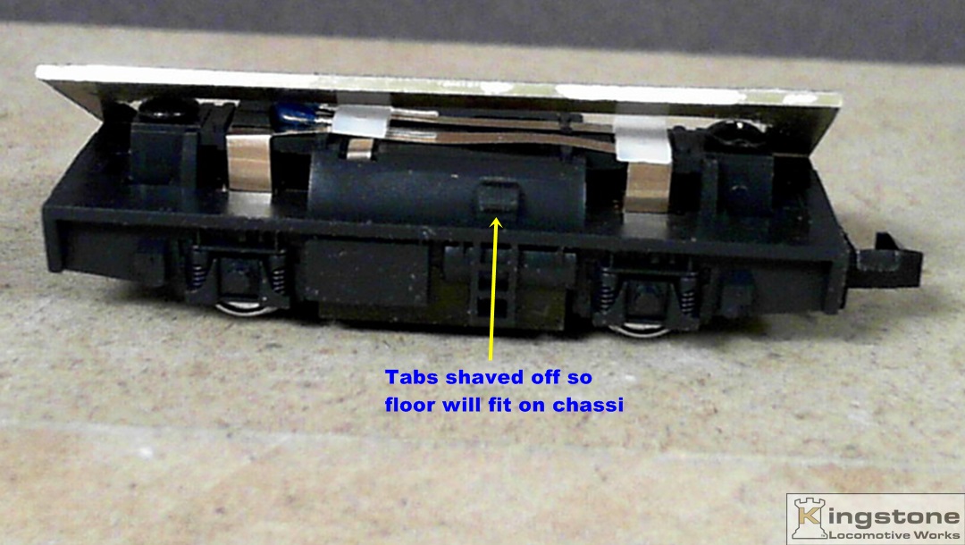

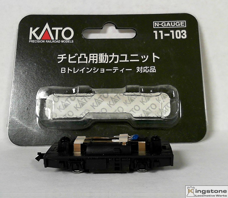

I was orginaly going to scratchbuild the chassis but figured I'd never get anything built if I didn't use something that was already to set a super structure on. I came across these somehow.
I took some basic dimensions from the chassis and drew a couple of rectangles in my CAD program, printed it out and cut out the center to fit over the chassis.I drilled holes in the corners and used a fret saw to cut out the center
There are tabs on the side of the chssais that need to be shaved off to make the frame bottom fit over the motor.
Here's a concept mock-up of the boxcab, plus one next to a quarter showing relative size.
I based the width on 2 Maine Two Foot gauge equipment. The width is around 7'6". The length I picked an abrbitraiery figure of 16' which seemed to foit the chassi well. The cardboard mock up gives me some idea of what it will look like.
That's it for now. Spent the last couple of days rebuilding the main disk drive after a "Maleware Attack".
Next installment should show the floor for all three power units.
P.S. I seem to behaving some picture problems here. Working on a fix.

Thanks George. Yes, it's going to be all brass. I will be using my CNC mill to do a majority of the work. It can also be done manually but with less accuracy in making multiple parts.

I'm working on getting the "new" 3 floors done today. Have the CNC mill all warmed up and ready to go.
