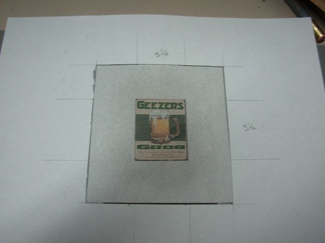

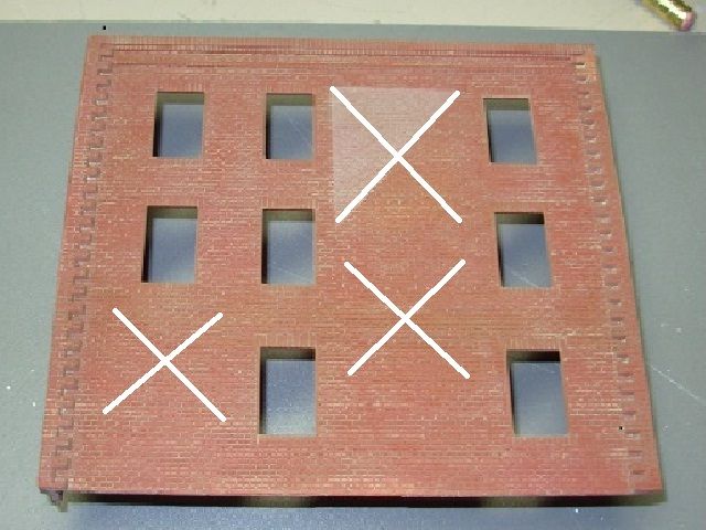

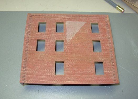

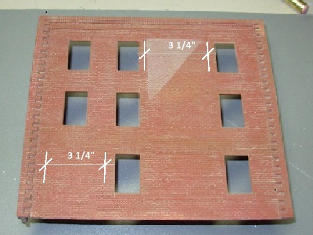

Step 1 - Identify an area on a wall where you want the sign.
The ďXĒ marks the areas I chose. Iím not going to go into great detail regarding the mortar between the bricks. Plain and simple I used artistís oil paints and mineral spirits to make a light wash and let it flow into the joints. You may have a different method and thatís fine but it should be done and allowed to dry thoroughly before you go any further.
Step 2 - Measure the area so that you can resize the digital image.
The areas marked above are the maximum size that I want the sign to be. Above is the first digital sign image that I want to use.

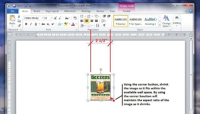

Step 4 Ė Resizing the image for the available space on the wall.

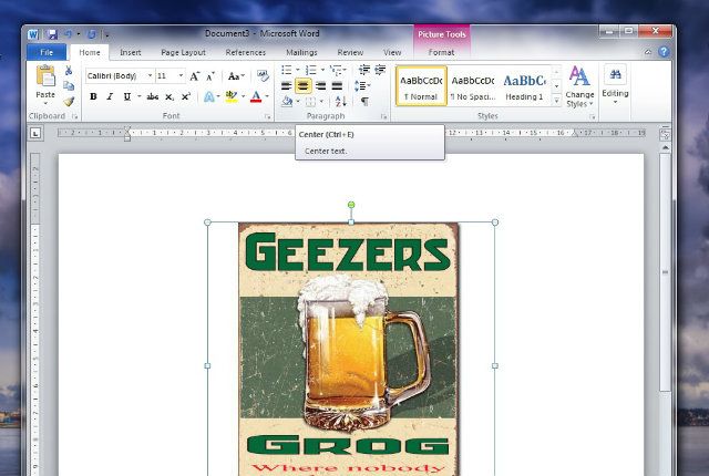

I used the word processor on my computer to resize the image. I this case itís Microsoft Word.
1)In the paragraph formatting section center the image on the page horizontally.
2)Make sure the page ruler is turned on to help you calculate the image size.
3)When you left click on the image a thin lined box will circle the image. On each side you will see little circles or button.
4)Left click and hold the bottom right button and move it in towards the image. This will force the image to get smaller. Keep an eye on the image and the ruler above to make sure your image is smaller than the available wall space.

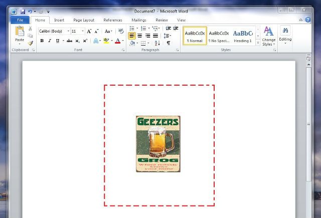

5) Once you figure youíve got the size you need, make a print of your work but not just any print.
6)Left click on ĎFileí and select ĎPrintí

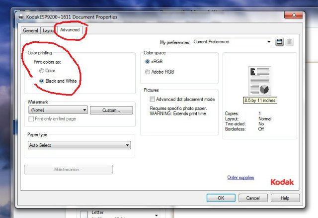

7)When the print window opens select the print ĎPropertiesí. When the properties window opens up there should be three tabs, General, Layout and Advanced.
8)In the General tab you need to change the Print Quality to ĎDraftí, as for the Page Orientation, it really doesnít matter if the printed page is Portrait or Landscape.
9)There is no point in wasting your coloured ink so in the Advanced tab you will need to change from Colour to Black and White. Once youíve made the changes, go ahead and make a print youíll need it for the next step.

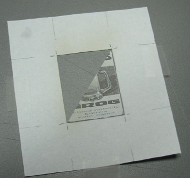

Step 5 - Once you have your black and white print you will have to draw a line all the way around the image keeping about one inch from the image on all four sides.
1)The next thing to do is to take a straight edge and you hobby knife with a new blade and cut along the line you drew around the image.
2)Now comes the Tracing Paper, there are two types or maybe more but the two that I used were Artists Tracing Paper and Architectural Tracing Paper.
The Artists paper is more on the opaque side and the Architectural paper is super transparent. Both are very thin and delicate. So here you will have to make a decision.
Do I want the sign just to look old and weathered or do I want it to look like its fading away? Here is where you have to make a decision. How transparent or opaque do you want your sign to be.
Step 6 - Whichever one you choose you need to cut a piece to replace the what you cut out. To hold it in place used the 3M Tape on the back side, and put it back in the paper supply tray and print the image again, but this time in colour and draft mode.

1)If you want to be able to read your sign completely and be not so old you will have to make a mask in order to spray a whitish background the exact size of your sign. I used the cut out from my black and white print, cutting along the edge of the sign leaving a hole where the sign used to be. Take this cut out with the hole in it and tape it so the hole is in the position you want your sign to be in.
I use an airbrush to spray a mixture of thinned acrylic paint, white or beige, through the opening.
This mixture is 10% acrylic to 90% acrylic thinner. You will have to spay multiple coats depending on how bright you want your sign.
2)If you want the sign to be old and fading away then do nothing or at the very least one coat of the above mixture.
Here is the cut out from the black and white print and I cut out half of the image diagonally
and used it as a mask to spray a beige background and allow it to dry overnight.
In hind sight I should have sprayed more than one coat.

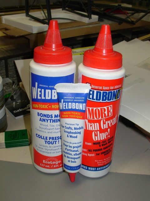

the White Glue

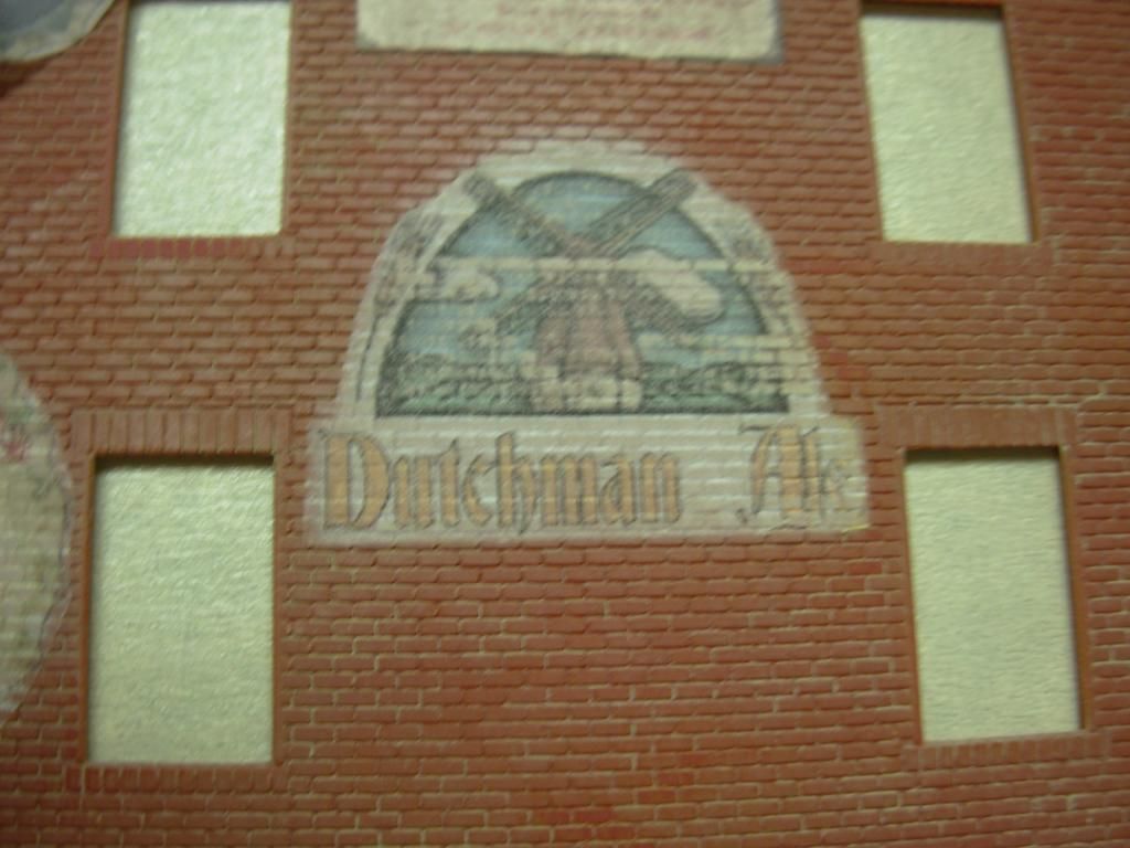

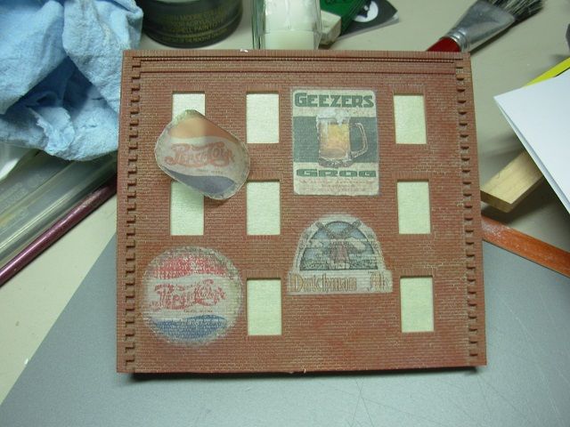

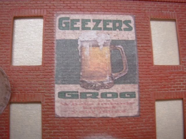

Step 7 Ė Now comes the true test if youíve done everything else right, adding your sign to the wall.

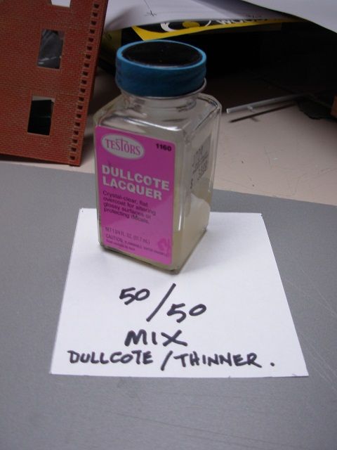

This sign is done with Artistís Tracing Paper. The sign was fixed with a spray of 50/50 mix of Testerís Dullcote and lacquer thinner to both sides to stop the ink from running when you apply the water based glue.
The Dutchman and the Pepsi signs are on Architectural Tracing Paper. They both got a very light coat of beige background colour on the wall before the signs were applied. Again before the application of the signs, a coat of Dullcote was applied front and back to seal the ink. Once the signs were applied they were allowed to dry overnight. The next morning I took a piece of emery paper and sanded all the signs lightly to affect some of the detail.
You be the judge, If you like how it looks or you feel you can use this process, feel free to use it or improve it.
Note: Keep this in mind, if you do improve on this process you have to tell me what you did so I can use it.
Notice in the photo above how transparent the spare Pepsi sign is, it was done on Architectural Tracing paper
One final coat of Dullcote and then the only thing left to do is to weather my wall and Iíll bet every one of you have your own way of weathering masonry walls so I wonít go into that.

One question - Do you use the white glue full strength or diluted? Well, maybe two questions - How do you get the print to settle into the brick? Finger, soft sponge, . . .

Bob, I use 50/50 mix of glue and water and note it does not have to be the glue I used. Any white wood glue will work. As for getting it to settle down into the cracks and crevasses I used my thumb and pressed down working from the center outward.
