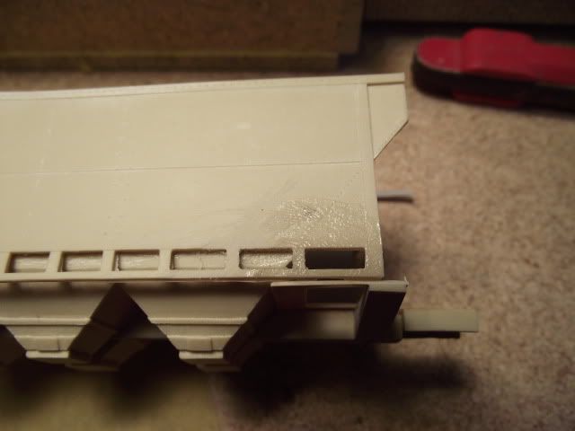

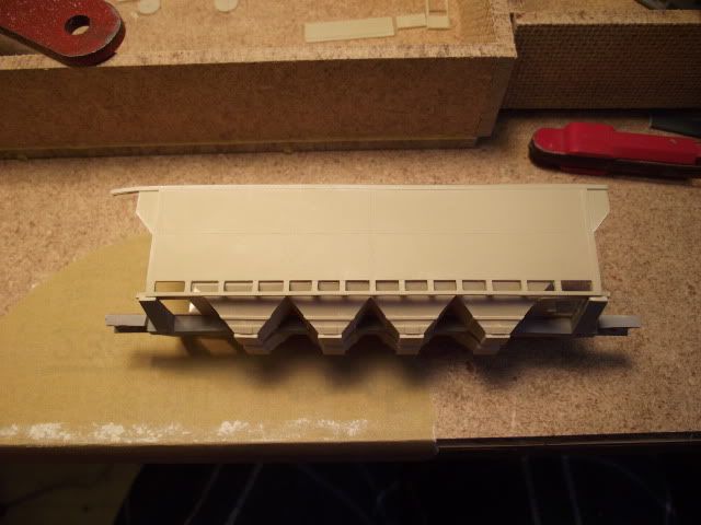

A bit of progress this morning, mixed with disaster.
I attached the side sheets:
But accidently glued my figure to the side, causing this:
Is there a solvent for CA that I could use to remove the fingerprint?

There are lots of choices especially when fresh, starting with acetone, BUT many options will also start dissolving your resin car and I have no clue as to its chemistry.
I'd do a test on some sprue or the rear of a sheet before any chemical attack.
If it hasn't bonded really well to the surface, if you freeze it down it may become brittle and can be abraded or chiselled and then the car side can be polished/sanded.
Unfortunately, everything depends on the characteristics of the car.

Glen, the only thing you can do with a finger print is use Bondo Glazing & Spot Putty spread over the fingerprint, then lightly sanded and when painted you will never know it was there.
When the glue hits your finger it is melting your print into the plastic.
Glen... You could make this a rusty spot on your car. Sand just enough to remove or disguise the finger print. Paint hides a lot of mistakes.
