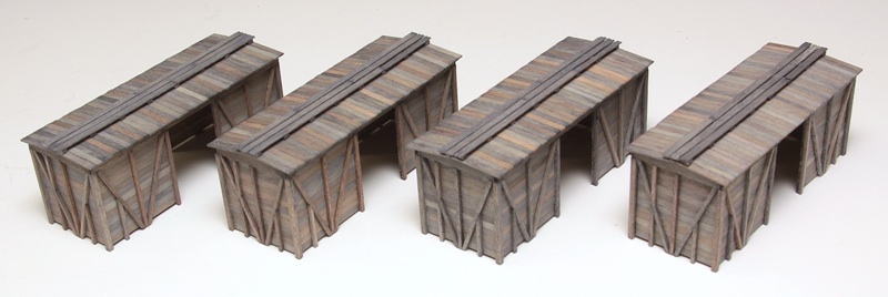

Thanks guys. For what it is worth, the roof walks are finished only with black leather dye diluted in alcohol. I roughed up the wood a bit beforehand, first dragging it with a razor saw and then also swiping it with some 100-grit to remove most of the fuzz and also create some finer graining. The knot holes were twisted in with either a new #11 x-acto blade or a dental pick. After I glued them up, but while still in my assembly fixture, I gave each a few good swipes with a worn out wire brush. I also picked at the ends a bit with the #11 before staining.

What's this? Progress on two consecutive nights? Indeed.
Not a lot, but it is moving forward. I glued up the planking on the next two roofs while watching (listening to) Downton Abby.
As before, the roof walks are just resting.
