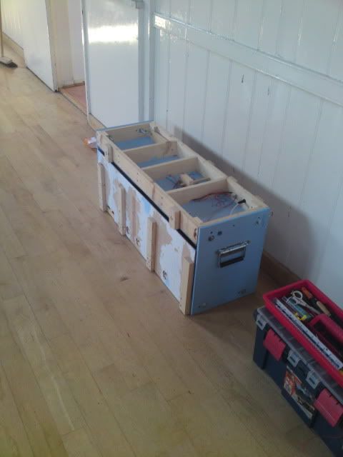

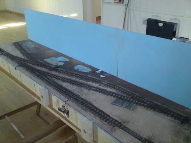

little update, as i said else where our club hired the hall we meet in for the whole sat, prime time for me to get the backboard up, with the layout on some legs (from another layout) and with plenty of extra hands to help.
anyway i got there at about half 9 (after forgetting... yes thats right the backboards.) and set about unpacking and getting the legs out of our damp shed (we are hoping we get one of the nice brick sheds, since a group that has one is leaving, so unless the hall finds another 5 day a week all day booker we might get it) and set up and started work.
our club chairman nick gave me a hand and we soon had them up after a little fiddleing about getting them lined up. keep in mind the blue paint is just to seal the MDF.
i also fidded little blocks made up of the same 2"x1" and mdf as on the backboard, this not only brings the front of the layput upto leval when being packed, but also protects the front.
and when boxed up its a neat tidy strong safe "coffin" (as some people call them) to ferry the layout around and store it in.
today i started fixing things down, im not 100% sure if i am doing it right, but i thought it would be easier to lay some tile grout before the buildings, ive fitted the farm suppler and the garage and it seams to have worked well so far, i think a bit easier then trying to lay grout around an already fixed building.
i also glued in the the rusty rails castings in the garage yard. and started to fill the joints, however while they where nice and flat when the grout was dry, since wetting and glueing its droped. so i'll have to go over it again when dry.
ive also "dry run" stuff like larger details and fences so it made a mark so i know where to fix them later.
any advice would be helpful. i think ive got things the right away around.

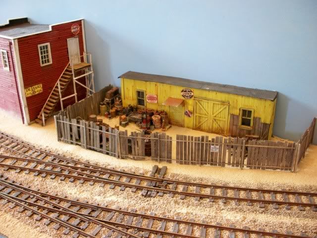

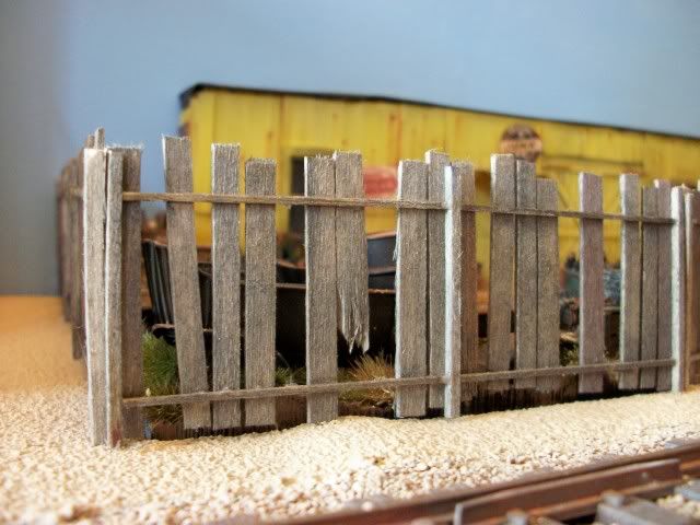

Posted - 07/13/2011 :  11:08:31 AM  Show Profile  Visit andykins's Homepage  Reply with Quote
thanks bill.
heres somemore.
the fencing isnt fixed
you can see what i mean by where the tile grout has diped in the joints around the bases of the castings. need a bit more work
bet the local kids get in this way, i suspect the hunt for parts to make carts.
its all very "mono tone" not helped by the fact its still wet, but i will go over with more grout, as well as real dirt, brown WS turf etc.

Very nice scene, Andy. Indeed, adding bushes in front of the fence will add interest. You don't need many to make the whole thing quite alive.
Country: France | Posts: 16452 Go to Top of Page
