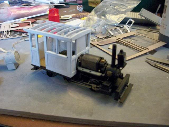

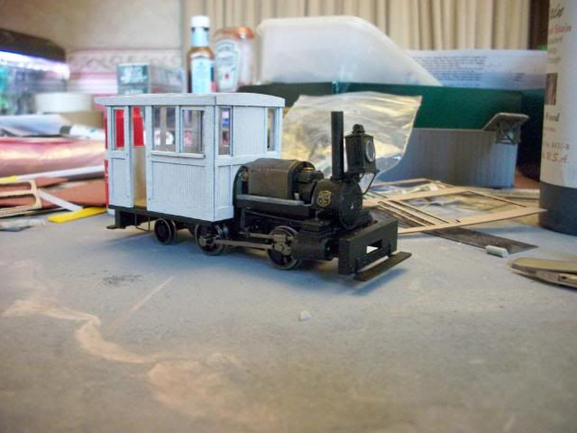

maybe time for some pics?
these show it as it was a couple days ago, still not fully striped with the headlamp, and smoke boxdetail to be removed as well as front beam, banta cab in primer, the side tanks sit about level with the bottoms of the windows.

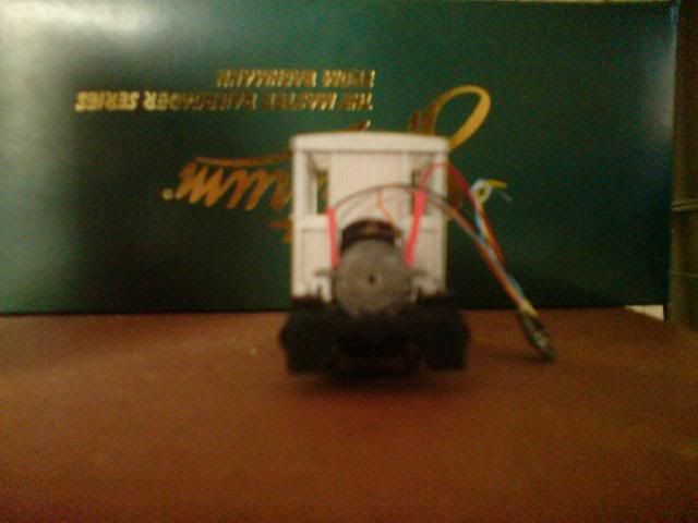

this rather rubbish mobile phone pic shows as it is now, DCC chip one front bean removed (well half of it) and alos shows the best i can get the cab to sit stright, maybe im just being OCD?
Posted - 11/06/2010 :  06:28:06 AM  Show Profile  Visit andykins's Homepage  Reply with Quote
and as bad as that last pic is, i can assure you the rest of the loco is level, across the tops of the cycliders is spot onwhen on a mirror, and track.

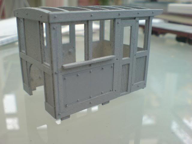

i desided to add some NBW castings to the cab, just to give it some extra releaf.
i also thought about what to do when it comes to numbering this loco, and thought id try some new decalls i got that are waterslide. when i did my HO buildings for my iowa layout, i had real trouble moveing waterslide decals onto wood, even painted wood, so, in my head at some point one of the panels got a bit of damage, and the works covered both panels with a sheet of thin metal, on bolted it in place, but i know its because it'll make my job of adding a decal easier, but i would like to try some rub on decals oneday.
all of the NBW apart from on the "metal" panel where lined up by eye, the plastic sheet that i cut to fit the panel was marker and drilled for NBW before i cut iff off the sheet, and glued inplace with ACC

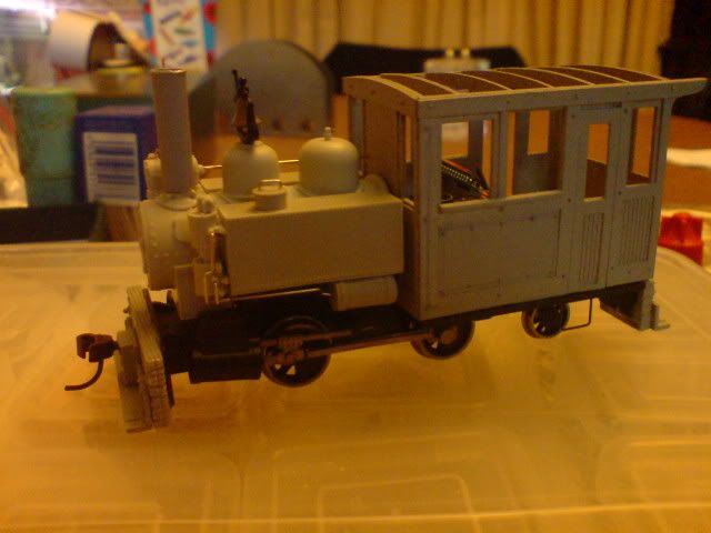

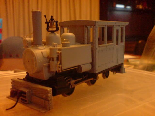

now that parts have landed on my door step, ive been a busy bee.
the backwoods side tank kit goes together really well. took a little work to get it to sit on the bachmann loco ok, even though the instrutions say you can hold the new top down with the bachmann scrws used to hold the bachmann tank i found it far to hard to get a drill bit to all but one, how ever with the nice tight fit over the ground down bachmann smokebox, this seams to hold very well.
all whitemetal parts where primed 1st with a spray can, end beams and chimy where all stuck with 5 min epoxy, this gave me a stong bond, but also around 15mins to play around and get them where i need them to be. all other glue joints where just superglue.
now that im able to fit the cab, and backwoods kit together on the chassis, im starting to get a real feel for this loco, nice and chucky and more bulky that bachmann's poter.
sorry about the bad pics, its getting dark here around 4pm.
