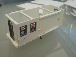

basicly, i made an other goose a while ago, while this was a nice model, its really a bit on the large side and lacked anywhere where i could add alot of detail.
so after a break from the darkside, the idea of building another, smaller goose came up, this is the story so far.
i got this chassis off ebay, it cost me 10, runs well, pick up on 3 axels, and has one axel with rubber triers to aid tracion, its has an 8 pin socket, oh and made by bachmann, even though it was used for was is really a toy, i think bachmann knew people would want to bash it
i was looking at the chivers line of boxcars, but due to poor health, now in limted supply (i understand the owners son will be taking over the on30 line under the name slim rails?) after a little look around and a few emails desided the BVM boxcar would suit it, and ordered, few weeks later it landed, and with in an hour of opening the box, i had the floor sitting on the chassis (followed by an oppise later)

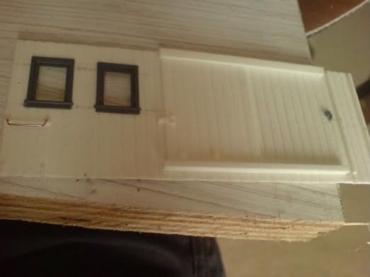

i wanted a door and some windows to add something to it, make it look as if inside there would be some kind of workshop, windows and doors where ordered from grandt line, this took a while to get here, but once again, with in a couple days i have all windows and doors fitted, the boxcar being made of resin, cut like butter, so was nice and easy to fit everything, i also fitted some door stops from grandtline too, just to add something
back to the chassis for one mo, theres a front and back to it, theres different "mounts" at the front and the back, so the floor can to be made to fit these, the idea being the truck that was driven would ne nearer the front, when i came to glue on the ends, i didnt check, it was a 50/50 chance and i lost :P so the drive is at the back of boxcar, i dont think it will mak any difference, it was more than happy pushing 2 HO boxcars around, once the sides where added, i had to add some bracing to keep everything stright.
i also got the truck im going to use on this build, the GAZ truck from unimodel. nice kit, should go together fine, i know a few people have had a hard time with it, but it seams this is mostly with the chassis, theres alot of parts for it, but since im only useing the chassis and cab, makes for an easy build, i have already started painting the motor to save me doing it after sticking it to the chassis
this gives you an idea of how it'll work out
the plan is, flat bed behind the truck, with a tank of some kind, shelves full of detail, drums etc, the normal junk, i may add a light to the top of the boxcar, but i am unsure, the boxcar i want to paint and wether as if its kind old, but not so much so that it wouldnt have been chosen in real life to make a goose i may add lettering too (but as if its even where the windows where cut, so more letter of what was, im ganna paint the windows and doors on their own and weather lighter, just so thay look newer then the boxcar, because they would be. i may add a coupler to the rear of the goose, not sure yet, im going to drill holes in the roof for when i hopfuly add sound, i may drill some in the floor too.
comments/ideas welcome. thanks to les and dallas too.
