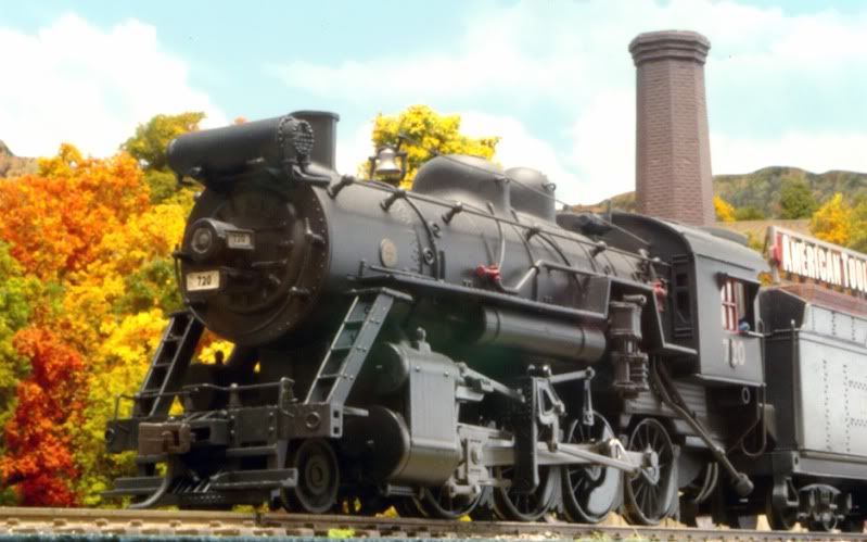

Here are a couple of shots I took this morning using a 28mm W/A lens I modified myself by inserting an f/55 pinhole witnin the lens system. I didn't spend much time on precise focusing this morning, so these images aren't really the best this particular lens can do.
I've used pinhole lenses of my own making for doing model railroad shots for many, many years now, but do so much less now in conjunction with my digital camera. This is because I can get nearly the same results employing modern UW/A lenses together with PhotoShop manipulation.

Your f/55 pinhole is a good one. Those impressive loco shots are quite sharp. I can't even tell what scale it is because there are no depth-of-field giveaways. (I'd guess HO because of the coupler.) How far back was the backdrop?

Dave, the loco is indeed HO and the backdrop was about 20"-24" behind it.

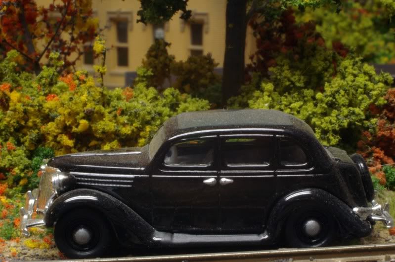

For comparison, I'm adding the quicky shot below made using my normal 19mm UW/A lens (please excuse the dust on the car!) to demonstrate what I said previously about non-pinhole UW/A lenses doing a nearly as good job for me these days. The lens was set at f/22 and front of the lens was only about 4"(!) from the car. Note, however, that the extreme background is not nearly as sharp as in the pinhole photo. Nevertheless, it's a much better shot than you would get with a Macro setting on a standard lens.

John, your automobile photo does confirm that modern digital cameras eliminate the need for pinholes in many cases. Even with my cheapo Kodak digital I can place the subject 4.7 inches from the lens and get a decent depth-of-field.
