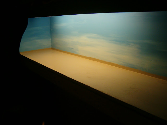

Posted - 03/07/2010 :  8:05:18 PM  Show Profile  Visit Graffen's Homepage  Reply with Quote
Now it's serious!
I have made the framework (300x42 cm) and had the electric work done, I opted for a built-in switch so I can turn on and off optional features.
A picture of the basic construction
The framework is built using 90x20 mm pine with 9mm MDF as a top.
I glued 20 mm styrofoam as a sound-dampener on top of the MDF.
Everything is glued with "No-Nails" from Pattex, which I think is a really good glue.
I used Pelly-consoles to attach the layout on the wall, it is a good system in my opinion.
It was very easy to mount the background and the shelf above the layout.
The shelf serves as the holder for the flourescent tubes and the light-valance.
The background is plain 1/8:th masonite glued with 18 x 18 mm strips on the back for stiffening it up.
I have also started painting the background and primed it with a blue color fading down to a light, almost white color.
I prefer to let the "chaos theory" rule when I paint my backgrounds, it gives me a bit to play with when I start with the detail painting (the clouds, etc.).
I want to get a framed effect when looking at the layout, and as it is in our living room,
I want it to have a certain "elegance furniture", which is difficult because I'm not a carpenter .
I have painted the front of the valance a neutral gray color (NCS 6000 N), it provides a rather neat appearance.
I have also primed the foam in an earth color to make it a little nicer in appearance than the original pink color.
I had some luck when the local "cheapy store" in the city sold matte latex paint in last years fashion-colors for $5 quart .
On top of it all it was the colors that was great to use as "earth" that was on sale .
I wanted to see how the buildings look "in situ", so I've placed them temporarily before commencing with track laying.
Now I'll just have to nail and glue the masonite on the fascia and cut it to match the landscape contours, then I´m ready to start with the trackwork.
Not so bad in just 3 days I think (it´s always nice to get rid of the hard work to start with).
