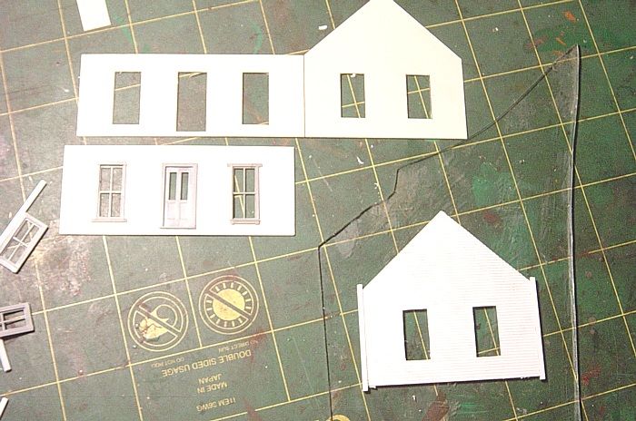

Without revealing too many details, the folks that run the Springfield show this winter have offered the 1/87 Vehicle Club a few tables for displaying our vehicles. We have come up with an idea to construct a few modules that will be coupled together with a continuous roadway. My initial thoughts on constructing my own module will be to build a New England farmhouse and barn. I have started on the farmhouse which is a simple 18' x 24' story and a half of styrene.
I began with Evergreen styrene clapboard at .040 spacing to give the claps very little reveal. The corners are .060 square rod which allow me to glue each wall together and provide a corner board at the same time. I also used the same rod up the rakes for the freize. The eave walls have a .060 x .080 rod at the top to give a slight overhang.
Windows and doors are Tichy. After the walls are glued together, I trim the rake boards to fit the eave end soffit and facia.

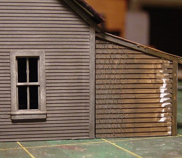

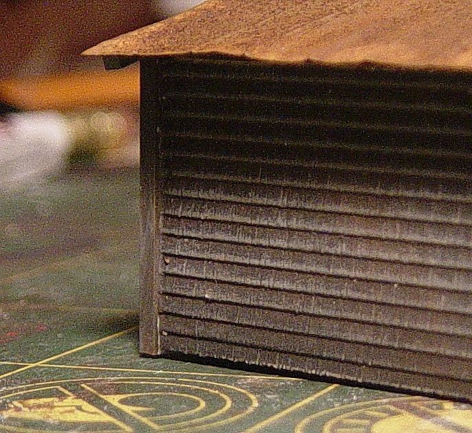

I built a small addition that will be the connection to the barn out of styrene. This time I used .060 spaced claps and scored the courses vertically to imitate shakes. I've not found a suitable shake finish for 1/87 scale and if one has the time and patience, this technique seems to be relatively successful. The second photo shows one wall that I finished the weathering on. The roof is scored brass foil that at the moment is a bit too orange. The small window frame will have a 4 light open sash in it but I didn't want to risk breaking it off so will wait to install it.

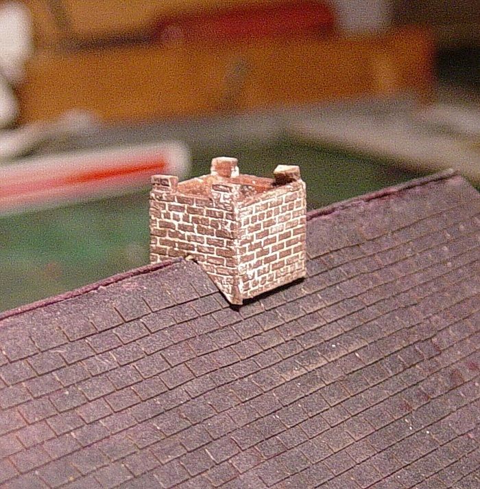

I experimented with some Evergreen styrene brick pattern for the chimney. It will have a flat stone cap much like many of the old houses near me here. Now I keep hearing that mortar should not be white but an off color but again, my observations have shown quite a lot of old brickwork has the old white Portland, lime and white sand mix that is quite a bright white. Here I used artists chalks mixed in alcohol and when dry merely wiped the excess of with my finger. I'm not sure I'm quite happy with the fit of the styrene but for now it stays.

Great additions to the structure Chester and a neat idea for the shingle effect, with your weathering it is looking terrific on the finished wall..
I also see alot of the 'whiter' mortar on older buildings around 'here'.... Like you I tend to not follow what is 'said' but follow what looks right to me, which is ultimately what I see around me as I'm driving to work or wherever.
I will now pay closer attention to chimneys specifically but I would imagine a soot build-up / wash off, maybe you already have this in mind, or maybe my assumption of this is wrong.

Yes, soot will be present and I need to flash the chimney to the roof shingles yet but am waiting to finish the interior glass and window coverings and then to fasten the roof permanently first. I've heard some folks use just plain scotch tape and paint it. I may give that a try.

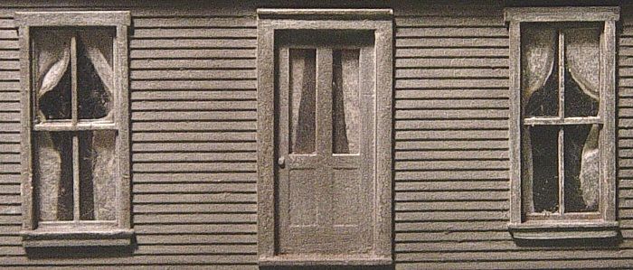

I'm really anxious to move on to the barn so I'm doing what I can to get the farmhouse to the point where anymore work can be done after it gets planted. So I glassed the windows with clear acrylic and hung some curtains. I used 1 ply tissue dipped in 50/50 water/wh. glue. I got the idea that the thin tissue would make a thin enough material for the flashing so I cut the pieces out and brushed the glue/water on the chimney and set them. Painted when dry. I still have to cap 1/2 of the ridge but the individual ridge shingles are a pain and I needed a break. The capstone is a very thin piece of Vermont slate. Slate has a grain in it like wood and can be split really thin.
