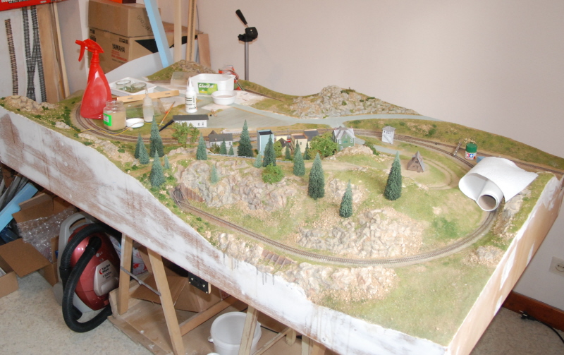

So 6 year ago i have started to built an amrican N scale layout named Turtle Field Railroad.
The theme is a very small junction town and his natural area.
The layout is an open grid 6*3 feet made in plywood 10mm thick.
The track is peco code 55 streamline, radius are 15", ramp max is 2.5 %.
electrical suply is a PH pro 5amp from NCE.
The goal was to creat a closed layout to run long train in the minimum of space, and to broke the oval shape apearance of this kind of track plan.
I also wanted to have the posibility to used this layout as a reverse loop later on a bigger layout without modification.
So the track plan i designed to fit the rules given highter :
The layout is not finshed you can see here the layout in is actual shape ...lot's job remain !

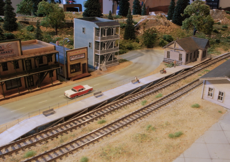

some view of the scenery :

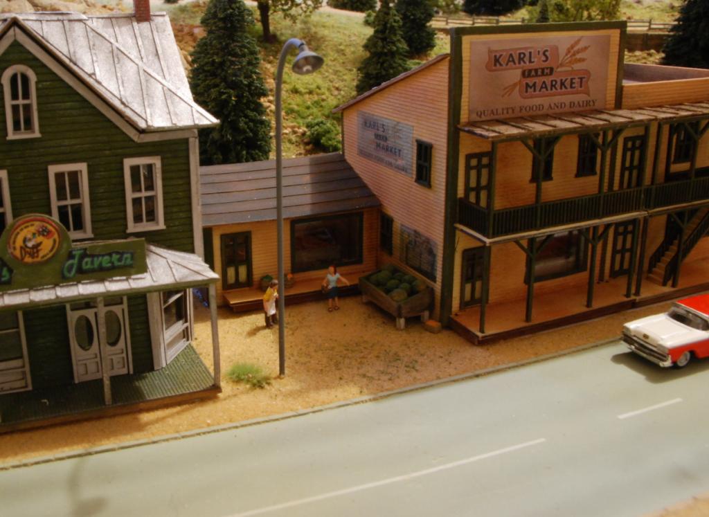

The shop-street :

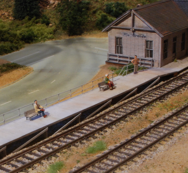

The station, the platform is a scratchbuilt one:

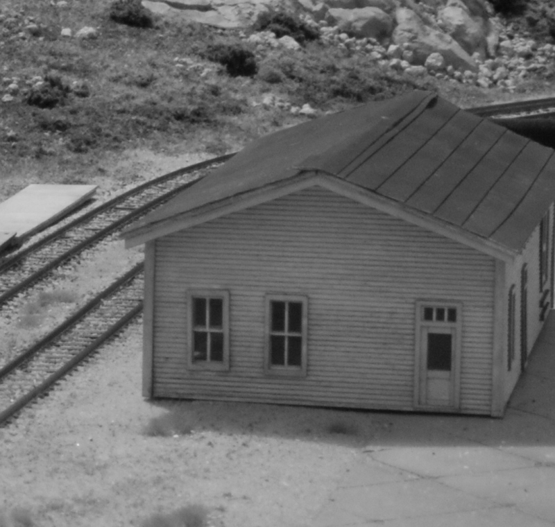

The warehouse of the transportation company:

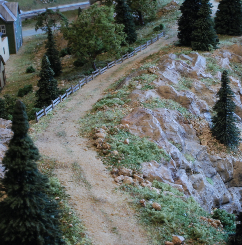

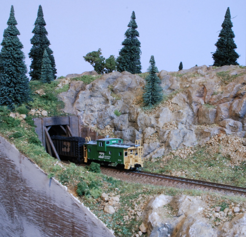

Natural area :
The fir's not at the level of the rest the scenery will be change for better soon !

Amazingly neat wiring and benchwork! I like the weight reducing holes cut in the plywood. The scenery is really good too.

You've done a beautiful job on your layout. The wood working, wiring and scenery are all top notch. Well Done!! Looking forward to the addition in the future!

You are doing a great job with both the structures and scenery on your railroad, and the wiring is terrific!

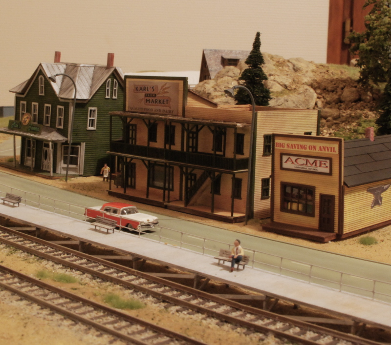

Again for fun :
I'm a fan of road runner cartoon by Chuck Jones.So i would like to do something on my layout on this theme.
and the result is this building from AMB :
It's the ACME general Store where the coyote loved order some toy . Notice that there is great price on anvil.
The front glaces was quite big so i needed to built the inside.
So i realised a little brass dynamite pack (favorite tool of the coyote) for it.
A euro cent is nearly same size than a US or CANDIAN dollard cent.
It's realy visible if you don't know it when you watch the layout...but if what great to do this work until that !!
The detail of the add on the side of the building :

I love the ACME store! That's very funny!!
