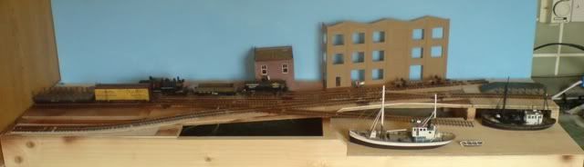

Posted - 08/01/2008 :  07:00:44 AM  Show Profile  Reply with Quote
Time for an update
I'm now pretty much back to where I was last week but also with a sky. It's a long weekend here so I'm going away with my girlfriend but I'm pleased to have made progress after last weeks let-down.
Once i attach the main bus to the track feeders I'll be able to start running some trains Tests of the trackwork so far show it is nice and smooth but the gaps in the railhead left by the insulating rail joiners are unacceptable (1-2mm) so I'll fill them with epoxy and file them down so stop the loud click the wheels make passing over the gaps.
Now the boring bit (for me) is nearly done and I'll be able to get on with the scenery and structures

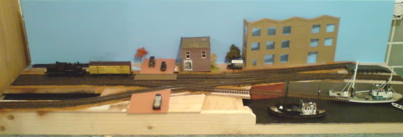

Posted - 08/11/2008 :  03:46:51 AM  Show Profile  Reply with Quote
Time for an update again
Sorry about the blurry photo. The lights weren't very bright.
Since my last update I have painted the rails (not something I'd like to do too often!), ballasted the track with a mix of WS cinders and dark grey ballast, started on the road (brick) and the quay wall (brick and cut stone) and built up the sub-base for the gently sloping ground between the harbour and the road.
I went to Dublin on Saturday and got some gloss medium so I can have a go at the water in the harbour, but I want to build the pier fist. At the moment the water is just painted plywood but the grain is a bit visible on the surface. Should I fill the grain before treatment or will it be covered over by the gloss medium when it is put on thickly enough to make waves?
