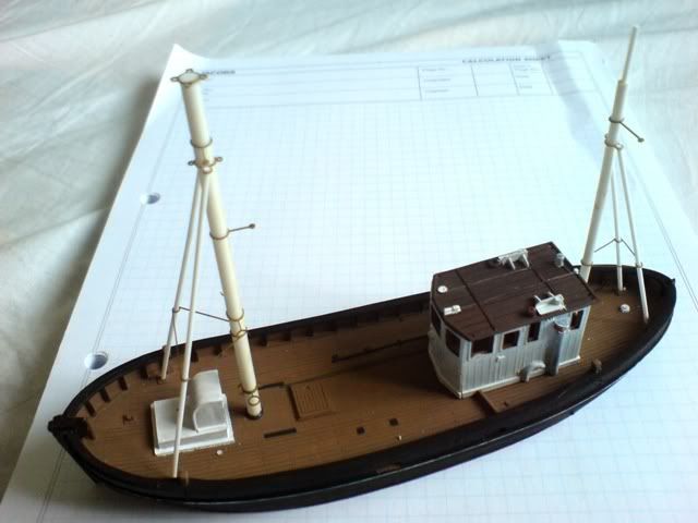

Mike, the Artitec boats are very nice kits. The barge is also an Artitec model but I added sides to the deck so it could carry coal or loose cargo.
The trawler and shrimp cutter fit together very well and the resin castings needed no clean up or filling. The only difficulty I had was that the etched brass details that fit to the mast were a loose fit around the styrene rods that is used for the masts. Most of the connections for the ropes etc. on the masts are etches brass rings that fit over the mast with etched brass loops for the ropes and stays however the loops on the trawler (white masts) had to be fitted with gel ACC and the trawler (grey masts) needed a strip of 10x20 thou styrene glued to it to pack out the gaps but it came out pretty invisibly.
You can see what parts i am referring to here and as you can see the fix doesn't really show
The instructions aren't great (two exploded diagrams) but they are simple enough kits to build so it's not a big deal.
I also have a kit of their harbour tug that i haven't built yet. It is an older kit and the etched brass is not as fine but the resin castings are still very very good.
The trawler is painted as per the box/instructions but the colour scheme they suggest for the shrimp cutter was a bit gaudy for the time I am modelling (dark blue hull and yellow masts) so I went for something far more utilitarian.
