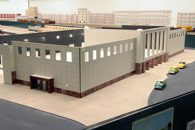

Well, it’s been a few weeks since my last post and I have managed to get quite a bit of work done.

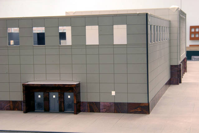

As I mentioned before, one of the many challenges in creating the NOUPT involved replicating the imported marble along the lower walls. To do this, I began with actual photos of the marble panels that were taken by Dr. Muff. I used Adobe Photoshop software to scale the sections down to HO size and printed them on semi-gloss photo paper. This gives a slight reflection to the marble as seen on the prototype. To avoid the white outer lines of the photo paper, I used a brown marker to color them. This also created a brown mortar effect along the joint lines.

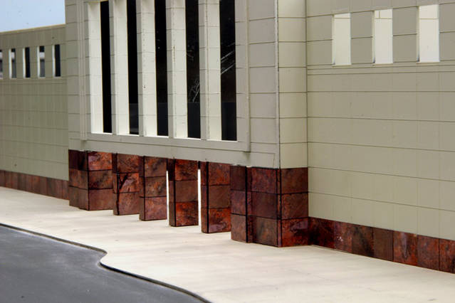

Compare this corner shot to the model thus far.

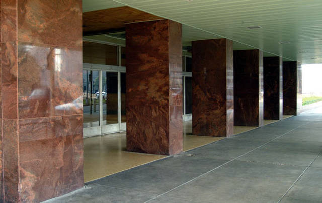

The front of the station had nice tile-covered columns. These have been finished as well.

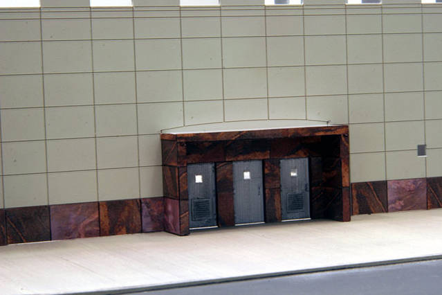

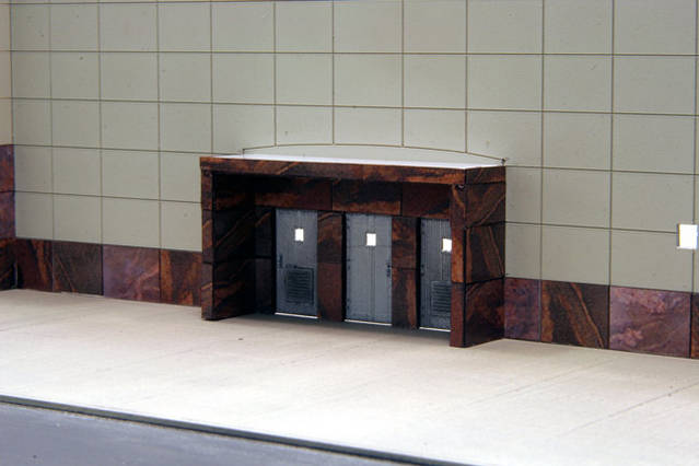

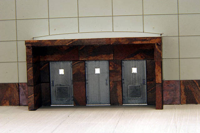

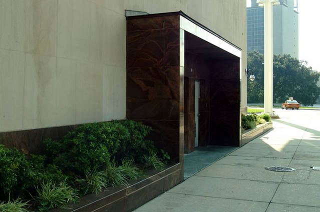

The side walls had three service doors that were covered by a marbled entry. These were more of a challenge because each piece of photo paper had to be custom cut and fit. It took longer than expected, but the results are very nice. I have not yet done the roof, but you can see the placement of the flashing laser-etched in the wall.

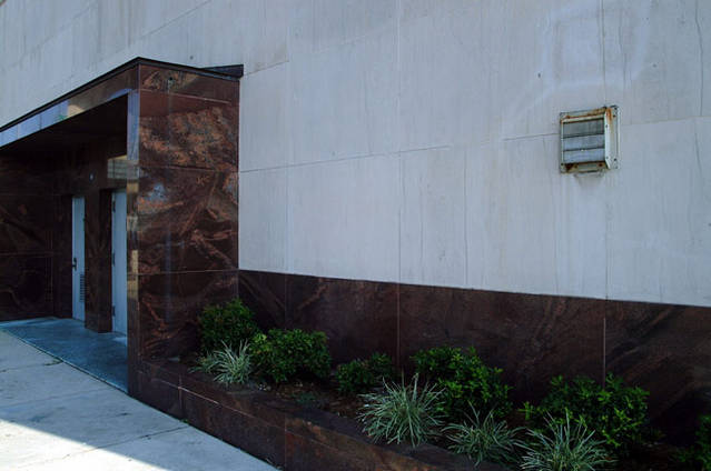

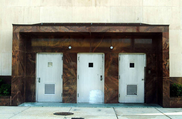

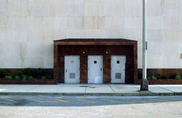

The doors were very nicely drawn by Dr. Muff and include the vertical ribs, hinges, door knobs, and even the key holes!!! I scratchbuilt the large vents from Campbell’s corrugated siding over a .010 styrene “frame”. Notice how well the finished section matches this prototype close-up!
Here are some other photos of the wall which show the planting bed which was also covered with marble. These have been laser cut as well and will be added once the walls are permanently glued in place.
I still have 3 more wall sections to complete before all of the marble is finished. I think the photo paper was the way to go. I could have never achieved those results with paint.
My next post should include the other three walls finished and possibly the concrete passenger platforms. I have been simultaneously working on them as well and they are about 80% complete.

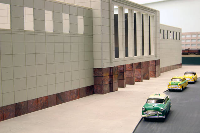

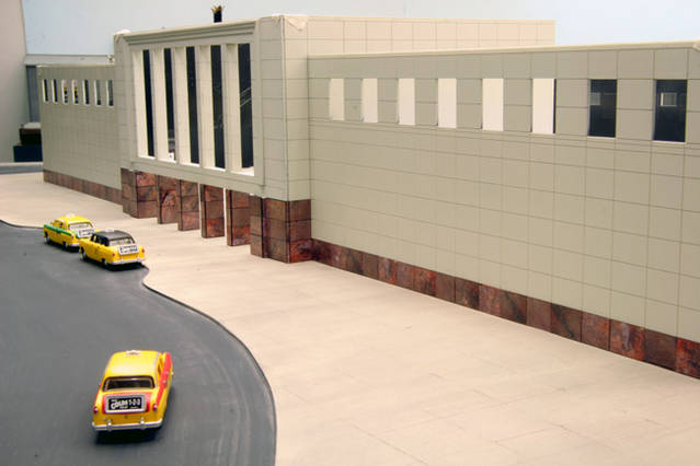

Here is the overall scene as of October 21, 2008. The taxis, btw, are by Athearn and incredibly nice. I have 8 so far and plan to double that number. See ya’ll next time!

Cliff, you never cease to amaze! Outstanding work. I always look foward to your postings. What a clever idea, taking pics of the marble and then printing them out on photo paper. It looks great!

This is fantastic, Clif. The modelling of the marble is wonderful, and the realism of the doors is great.
