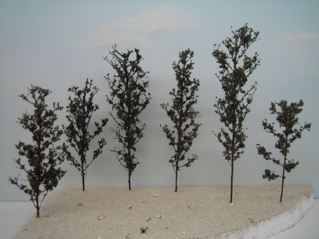

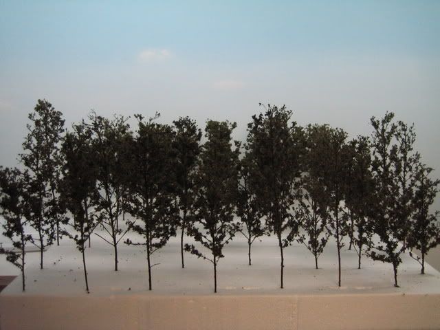

January was a busy time for me in the real world so I didn't get much done in the HO world. I have two projects I'm trying to finish now: a build of KingMill's Nella Country Store and 200 or so Carolina pines. The walls are braced and painted on the store but that's about it. The pines are nearly done; only a few more hours, thank goodness. Here's a couple of photos.

Arnold. The trees look great! Trees don't have to be perfect when you are using them to basically fill in the background. I remember my many trips to Florida on spring break and you are right about the pines looking pretty ugly. Do you have a lot of that spanish moss hanging from the pines and oaks like in Florida (I can't remember if I saw any of this in Georgia)? Looking forward to more pictures of your progress.

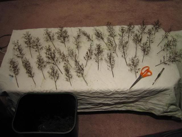

Thanks for the comments and interest in my pines. Tom, you're right, you have seen them in FL. They are prevalent in sandy soils along the coast, and inland you find them in that famous Georgia red clay. I don't know their true name but every year during the Masters one of the announcers will refer to them as "loblolly" pines. Anyway, here's an up-close shot of some near Savannah.
I think my technique is fairly standard stuff. I use the dried flowers of a weed that grows in open fields called horseweed or marestail. I've found it from NJ to SC. It looks like this in summer:
I harvest it around Thanksgiving when the stalks have turned brown or black and the leaves have dried. This is a winter photo after the leaves have fallen off. I don't wait that long as the flower is too brittle and has already lost some of its "branches."

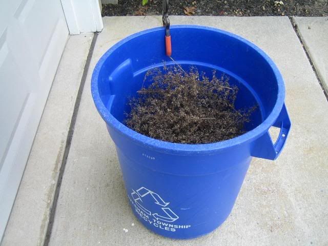

I gather a big bucket or two

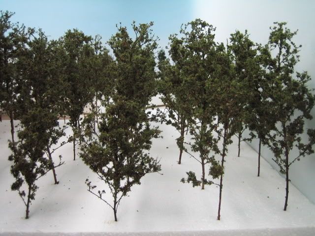

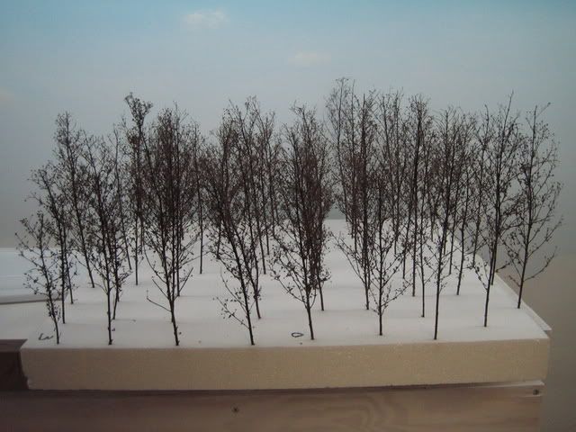

What's nice about this weed is that it already has the basic shape I'm looking for. I do a little pruning and then cut the bottom at a sharp angle so they will stick into the styrofoam.
Then I dunk them in dilute matte medium and stick them in large blocks of styrofoam to dry. They can stay this way a few weeks, so don't feel like you have to jump to the next step right away.

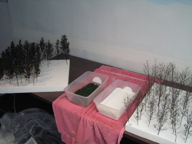

When I'm ready to dress them I set up an assembly line with a container of dilute matte medium and another of coarse ground foam. When I finish a session I just cover the containers and they are ready to go for the next time. (Hint: add a capful of Lysol or similar product to the matte medium to keep it from growing some additional "ground cover.")
After a dunk and a roll in the foam, I spray them with maximum strength hairspray and sprinkle on fine foam and flock. I like White Rain hairspray. The pump bottle puts out a very fine mist. I use Scenic Express Flock and Foam mixtures, especially Forest Floor for darker, background trees and Summer Pasture for lighter foreground ones. Another spritz of hairspray and a final dusting with various colors of fine foam, static grass, flock, etc. I try to mix it up so there's some variety.
Two bits of advice: wear gloves or your fingers will be green for a week and spread out plastic, newspapers, cardboard, etc. to catch the overspray from the hairspray. If not, you'll have a real mess on the floor.

Nice stand of trees, Arnold. Have you really made 200? Can you tell how you built them?
Hi Frederic,
Those blocks of styrofoam hold 35-45 stalks each depending on the size and I have 5 of them to finish this winter. Thankfully I only have one more to go. It's pretty work.
