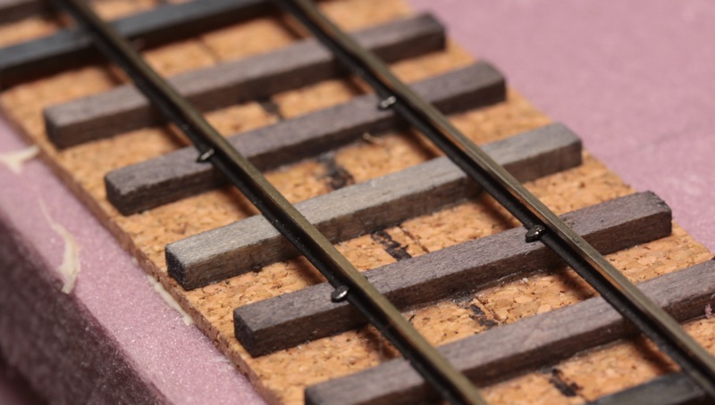

thayer Posted - 12/08/2020 : 12:54:13 PM
Pine will work as well, though there is a wide range in that family. The Eastern White Pine we have in the northeastern corner of the US works great, and is much like bass and poplar, if not slightly softer. Some of our southern pines are much harder, and I expect would be more challenging to spike.
Yannis Posted - 12/08/2020 : 12:40:18 PM
Yes if i go with 3x3 wooden ties, the stock plastic ones are 2mm high so I can push them down.
Nice table saw there, unfortunately i do not have a friend with one. I ll just get pre-cut strips, i also found some from wooden ship construction but i don't know how well they take nails. Basswood and pine are more regular choices i guess. Truth be told, the balsa i have, is too soft, i can easily compress it with light pressure.
thayer Posted - 12/08/2020 : 12:23:30 PM
Are the wood ties taller than the plastic? Can you just push down on them to break them free, and then slide them out?
As for sourcing ties, do you have a friend with a table saw? I cut all my ties using the small table saw made by Jim Byrnes and it went quite quickly. I have found the Byrnes table saw to be the most used power tool in my shop.
https://www.byrnesmodelmachines.com/tablesaw5.html
A new blade and zero clearance plate, along with suitable safety precautions, will do the job nicely.
Thayer
Yannis Posted - 12/08/2020 : 12:01:12 PM
Thayer,
I did some tests just a bit earlier on, and indeed balsa is too soft (or at least the balsa i had). Foam will make things cheaper/faster/lighter for me for sure, so if foam + cork is good enough then i got no quarrel against using it (vs plywood).
I think i can get pine or basswood strips (3mm x 3mm or 3mm x 2mm).
The plastic ties acting as spacers are good advice from another fellow modeller. After fixing the tracks in place (ie nailing them down to the wooden ties), you remove the plastic ties.
thayer Posted - 12/08/2020 : 11:52:14 AM
I used Micro Engineering 1/4" small spikes, and driving them was quite easy. I did not predrill holes, and did not split any ties. I used a pair of needle nose pliers that I notched with my dremel. The Poplar ties are glued to the cork, and hold the spikes, and thus the rail, very securely.
And yes, I do wish I had weathered the ties before spiking. I am actually considering pulling 1000 spikes, as I think removing the rail would make it easier to distress them.
thayer Posted - 12/08/2020 : 11:46:09 AM
Yannis,
I used 2-in foam and (nominally) 3mm cork, on my latest effort though cut my ties from Poplar instead of balsa. My gut says balsa will be too soft, and fuzzy, for satisfactory ties. I would recommend a harder, fine grain wood, such as Poplar or Bass/Linden.
For what it is worth, I stripped this rail stock from Atlas flex track, and used a few shop made track gauges to hold the rail while I spiked it. I like the idea of using the factory ties though. Can you talk about your plan to remove the "spacer ties" after the fact? That sounds like it could be a bit of a struggle.
Thayer
Yannis Posted - 12/08/2020 : 11:29:54 AM
Thanks Mike,
I would rather have plywood cookie cutter subroadbed but as I said i cannot drive nails into it. Maybe 5mm cork + 5mm foam insulation (the underfloor soundproofing type) and then the plywood? So that the track nails hold on to the cork/foam and not the plywood.

Yannis Posted - 12/08/2020 : 09:23:56 AM
Out of curiosity so that i do not start a separate thread on this, (or should I?), for subroadbed, if I plan on installing semi-handlaid tracks (peco code 83 flextrack but with spiked wooden ties from balsa, and then subsequent removal of the plastic "spacer" ties), would 5mm cork + 2" foamboard work?
I find it difficult to drive SL14 track nails into plywood given my experience from my HO layout. Maybe I could use two layers of 5mm cork so that the nails never reach the plywood.
