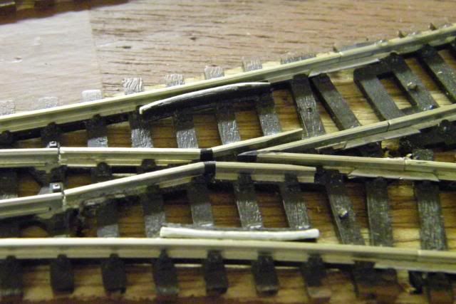

Russell, When you look at Louis' pic, you can see just how "generous" the flangeway is on those Peco's.
I haven't looked at their Code 83 line, so I can't speak to how they look/work.
I have also done the same thing on many of my Peco curved turnouts.
Even having to make that mod on some of them, I still prefer them over other brands.
Just my experience.
Mike O.

rhpd42002 Posted - 05/27/2012 : 11:22:17 AM
Martin, I was wrong when I told you I had no problems with my Peco, 3-way turnout. I was looking at my trackage last night while switching the yard and realized that I have added styrene strips to my small Peco Wye's and to the 3-way.
Here are a couple pics to illustrate what I've done. Sorry about my mis-speaking about the issue.
The 3-way
The small wye
Mike O.

rhpd42002 Posted - 05/23/2012 : 07:53:34 AM
I've got one, insulfrog, and I've not had any derailment issues, either.
As has been mentioned, check the wheel gauges, 1st.
If you still have problems, I would glue a very thin strip of styrene to the guardrail(s) between the metal rail and the face of the guardrail. I've had to do that to a few of my Peco, curved turnouts.
Mike O.
