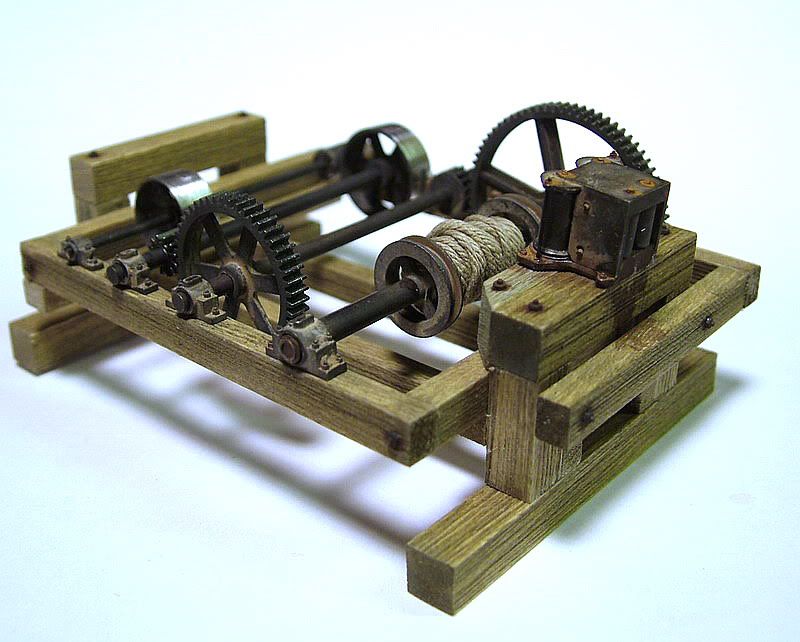

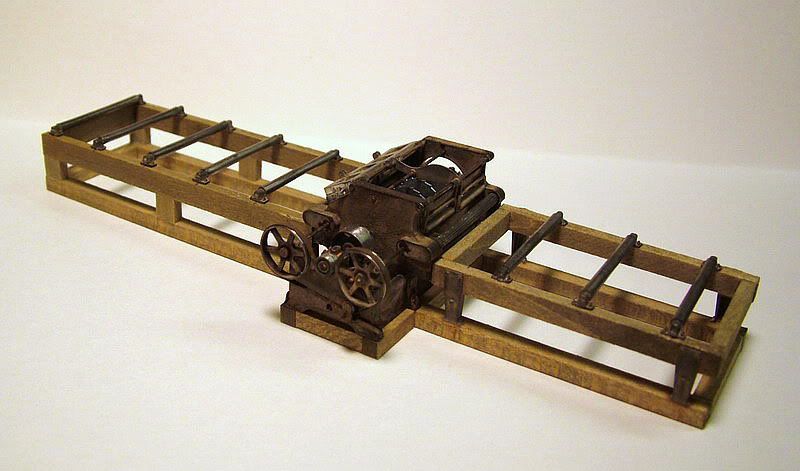

closetguy Posted - 01/23/2011 : 3:50:13 PM
Hi Phillip
The first pic, shows the brass un-dipped. The following pic's show the brass sanded and than dipped for 30 minutes in a reused solution of blacken-it. If you scrape the brass with something sharp,it will show bright brass again. However, it is not a fuzzy finish and it will not flake off. This is the first time I've gotten blacken-it to work properly. IACC glue adheres to this finish. The 50-50 mixture is supposed to be done with distilled water. The brass tube and rod are good old fashioned brass stock that I guess has a clear coat on it. The sanding with 220 aluminum oxide paper removes the clear finish. The 50-50 will still darken pot metal castings really fast. I found also that i need to wash everything to remove grease from the surface. The blacken-it does not like grease and you get bare spots.
Mike M
