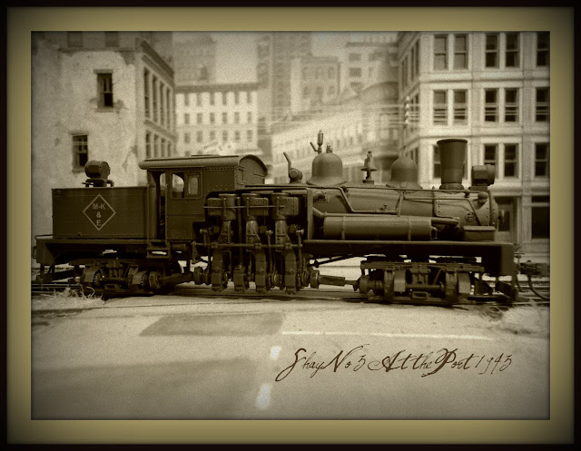

Here is my converted B-mann Shay:
Itīs way nicer to run now
