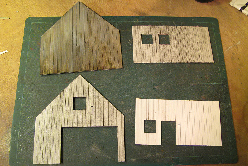

Frederic Testard Posted - 11/20/2011 : 7:15:06 PM
Thanks for the comments my friends.
Pat, Kris, Troels' influence is certainly strong, but it is mainly a matter of watching his DVD and the shots in his Coast Line topics. And clearly there's the moment when you have to dare try things, and he probably helped to this too. No Kris, no personnal painting lesson.
Arthur, I know snails that walk faster than I run...
I have continued the planking of the inside of the walls yesterday and today, and added the trimming around the windows and doors, following some good advice...
I can feel the return of the modelling mood. Even if I forced myself not to plank the inside wall which really can't be seen when the dio is installed on the layout, I'm starting to consider adding a few hints of an interior to this initially planned empty hoist house...
hon3_rr Posted - 11/18/2011 : 10:10:46 PM
Love to see this coming alive again and that you are keeping the modeling skills 'fresh' to keep the old modeling spirit alive by moving to the Canson paper. The coloring looks really, really good. And just how much time did you spend with Troels??? I'm thinking you somehow got some 'personal' painting lessons.

Martin Welberg Posted - 11/17/2011 : 6:38:08 PM
Great color on the backwall Frederic! And I must say that I think the same in this distressin matter altough it is a bit place depending. In sandy winy places wood will be more distressed as the sand blown by the wind will sand the softer parts away..
Frederic Testard Posted - 11/17/2011 : 6:28:27 PM
Ten months later...
As I mentionned elsewhere, while all the Canson strips were readily available, I decided to cover the subwalls of the hoist house. I still wonder weather I will make an interior since the structure will be in a location difficult to see. In any case, if I make one it will probably not be very important.
Here are the walls in three different stages. One is essentially done, two are simply india inked and the white one has simply been lightly brushed with a brass brush. I have been more and more convinced that our distressing of the wood is much heavier than what nature does.
