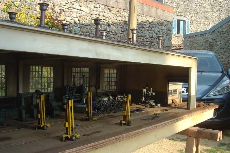

One of the members of the french forum "Forum US" dedicated to modelling american trains (mainly USA and Canada) has recently posted an amazing series of images describing his scratchbuilt machinery, which he does for a living, as an "independent artist". His name is Christophe Le Corre, he is 37. He allowed me to post on RR-Line these pictures and translate the most important elements of his messages, in particular the description of his construction techniques. He started this job four years ago, his goal was to provide some material to populate industrial areas that he found too empty on many layouts.
Among the documents he uses to do his work are :
- the 1941 US railroad encyclopedia, which last pages describe the layout of machines in a loco shop ;
- photos he took for instance at Strasburg on the East Broad Top, or when he visited shops in Germany, or that he simply downloaded on the web ;
- concerning the building of lathes, a very documented internet site at http://www.lathes.co.uk .
His first topic was devoted to machinery found in machine shops.
Although he is perfectly aware of the availability of excellent material such as Western Scale Models line of machines, he was after some more modern looking models.
He describes his modelling strategy this way :

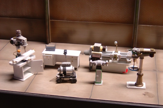

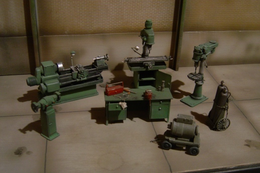

1. You must understand how the machine you want to build works.
2. You must gather as many parts as possible, from the most various sources (military kits, gears, lighter striker wheel, lots of styrene - he must be one of the best customers of Evergreen..., brake wheels, small electric wires, 0.02" diameter brass rod).
Then it's time to build and with the help of the gathered documentation - and of a steady hand - , one obtains this kind of thing.
The picture features a lathe (a small one : a loco shop would feature more huge machines, able to handle the turning of loco wheels), a mill, a drill press, a grinder and an arc welder on a cart.
Then comes the time to paint the models. The basic color is an industrial green : ref. Humbrol Mat 120. After spraying a first coat, the paint is allowed to dry for 24 hours, then a weathering wash is applied, and after this one has dried, a final coat of metallic color is drybrushed. The result looks like this.
Don't forget to sprinkle some metallic shavings in front of the machines to add realism to the scenes.

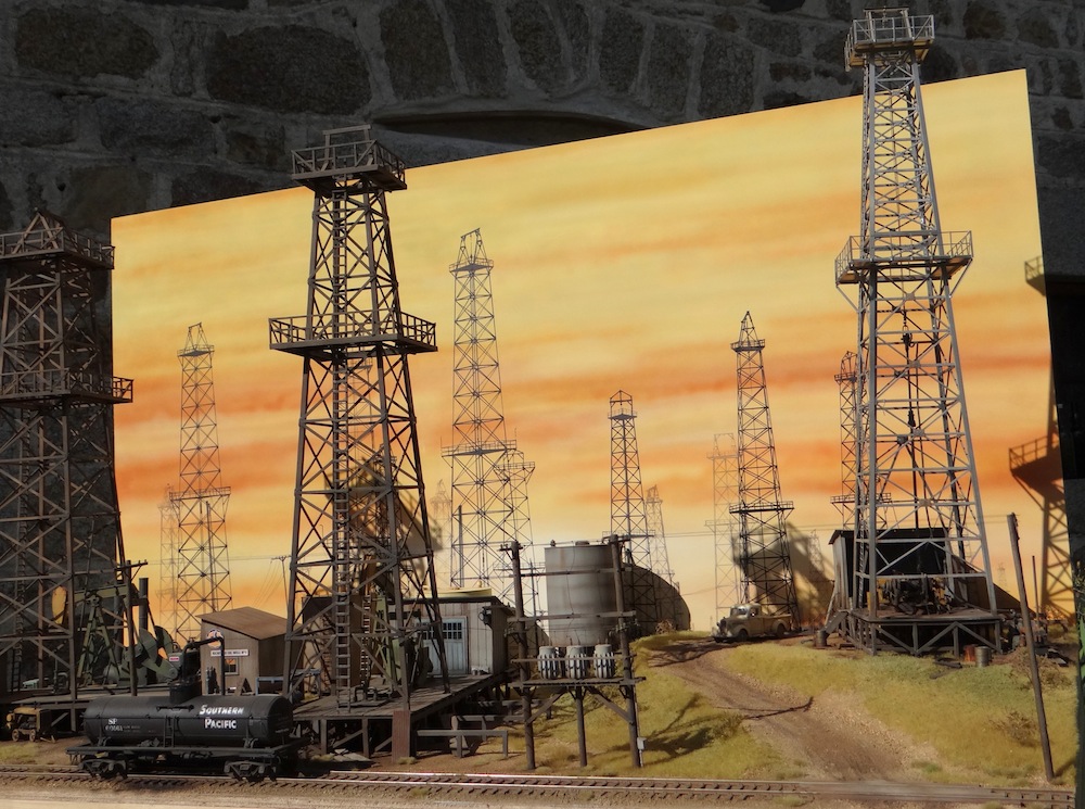

You can see it here http://teamtrack.xooit.com/t712-OIL-FIELD.htm

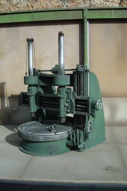

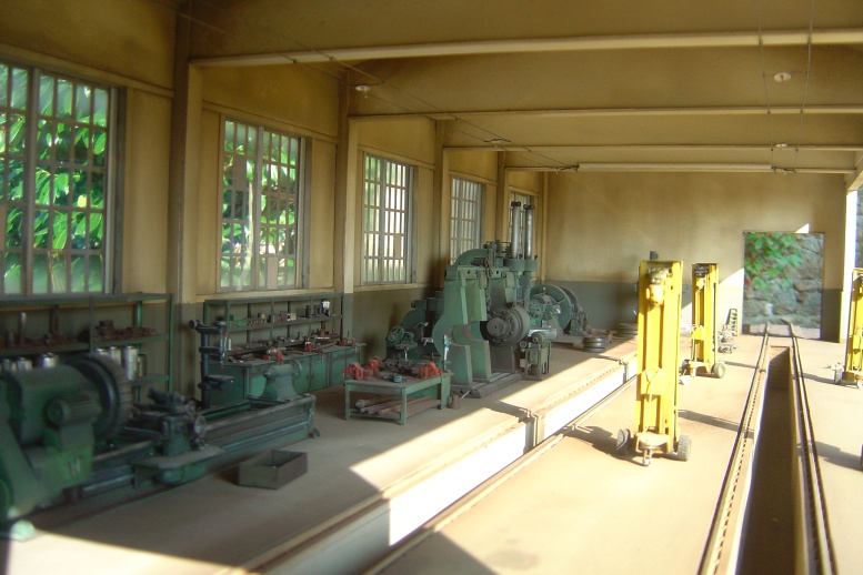

This post will describe some heavier pieces of machinery. A machine shop where big engines are being maintained needs some powerful tools.
Vertical wheel lathe and mill boring machine : perfectly suitable for machining tyres.
