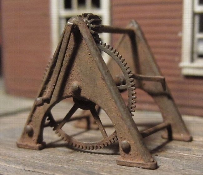

Chester Posted - 06/10/2012 : 09:38:06 AM
No not the little crustaceans with pinchers but a machine that sat behind my grandfathers barn for as long as I can remember that was fondly referred to as the crab. I'm now told that this is the name used to describe a single reduction hand cranked winch. This one is built entirely from styrene except for the gears which are from an old watch. To finish I painted with Floquil RR Tie Brown folowed with a coat of PolyScale Oily Black. I then misted with clear matte finish and when dry, used an acrylic wash of burnt sienna, while that was still wet, I sprinkled rust powder and Indian Red chalk. All was dusted with yellow ochre chalk finally.

dnhman Posted - 07/14/2012 : 08:59:09 AM
You captured the rust look very well. great coloring and patina,,
The guys from American Pickers wll be looking snatch this up!!!:)

Chester, I missed this back in June, so I'm glad that it resurfaced.
Great model all around. As the guys have said, the rust looks 'right', and you have given us enough information to try it on our own.

Glen Haasdyk Posted - 07/14/2012 : 12:34:18 AM
The rust texture is very impressive, as is the minturization. It looks like you could crank it over

Pennman Posted - 06/11/2012 : 1:42:52 PM
Chester,
Thanks for the rust technique. I will have to try it, but I think you've got it mastered.
