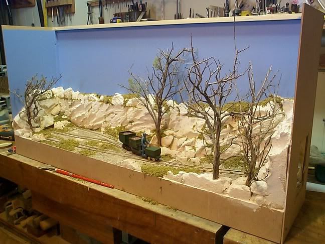

I am putting together a mini Gn15 layout and as a result of seeing the site about foam rocks I thought that I would give it a go here is the first cut so to speak. the layout is 1/24th scale and is an inglenook switching layout 40 inches long by 9 inches wide.

10254 Posts
Posted - 03/19/2005 :  9:59:22 PM  Show Profile  Reply with Quote
Looking good Michael! Please start a thread in this forum so you can keep us up to date with your progress. This is just the sort of thing this forum was started for and I'm sure there will be a lot of interest in your layout.

Originally posted by 6100
I am putting together a mini Gn15 layout and as a result of seeing the site about foam rocks regards Michael
Michael....thankyou for having a go to make some "FRocks"...
Could I suggest you that make separate, various size "FRocks" away from the layout, using the technique as per updated "FRocks" clinic on my web site.
http://members.westnet.com.au/mjbd/html/foam_rocks_-_frocks.html
Trust me mate.....if you make separate finished "FRocks" and fix to the layout with liquid nails., you will end up with 3D rock formation. Finished "FRocks" can be moved around your layout before fixing.
Happy to help anytime on this forum or offline....
