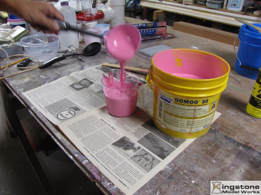

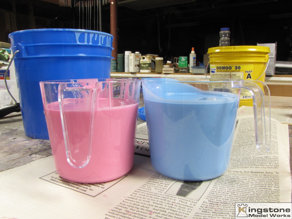

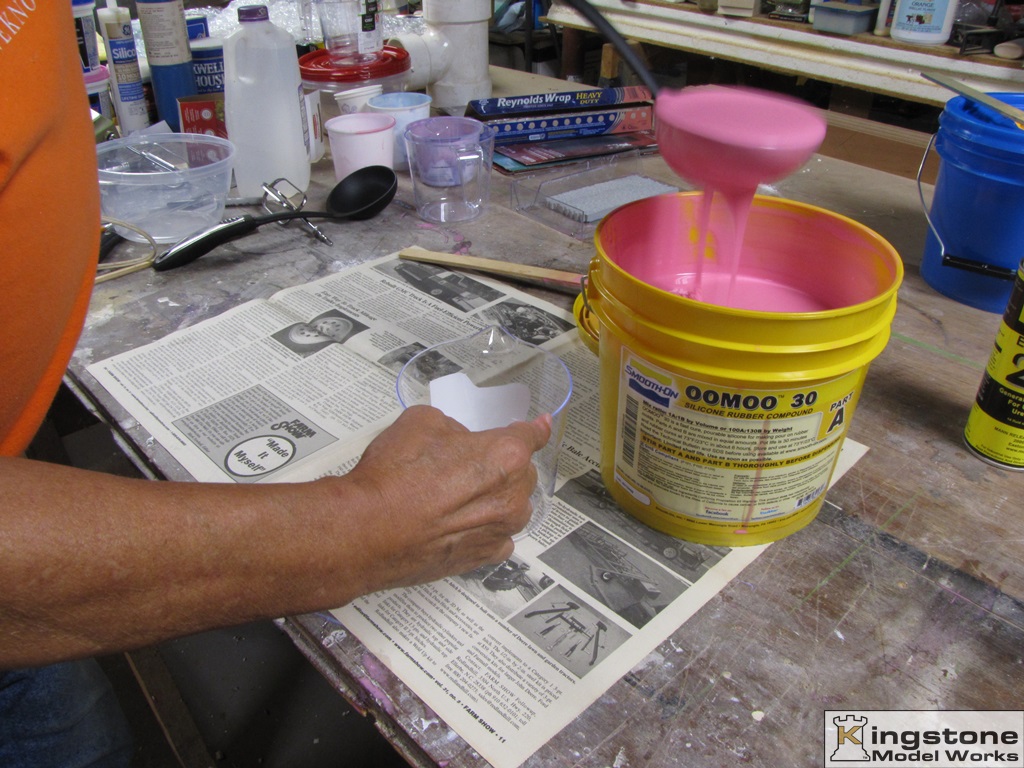

Trying out using a dipper for the Part A. This is heavier than the Part B. The measuring cup has a line at 2 ½ cups, that’s the goal.

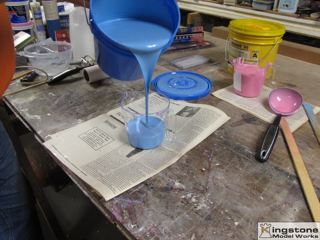

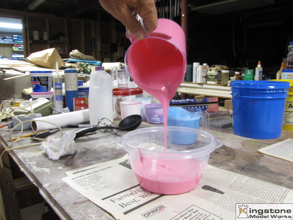

Pouring Part B straight from the container. Works better and is less messy.
The numbers are very hard to see on the measuring cups. A quick side by side shows I need to take a bit out of the Part B measuring cup.

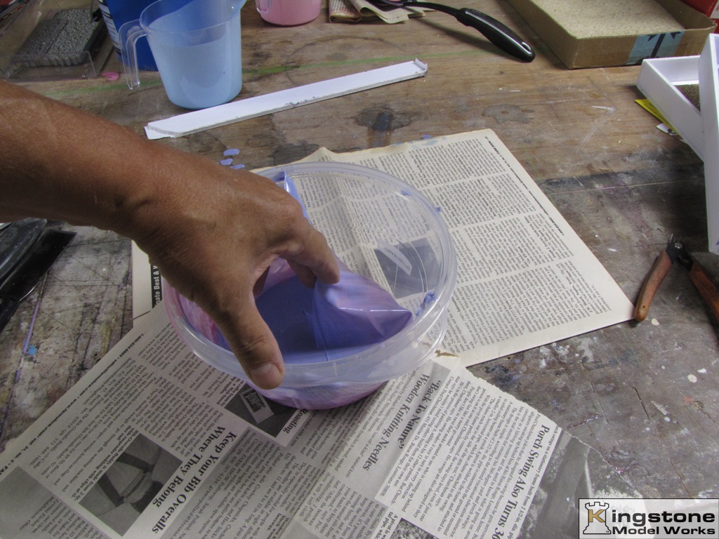

Into the 5 cup mixing bowl.

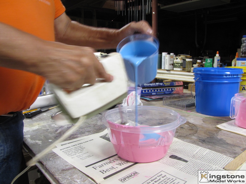

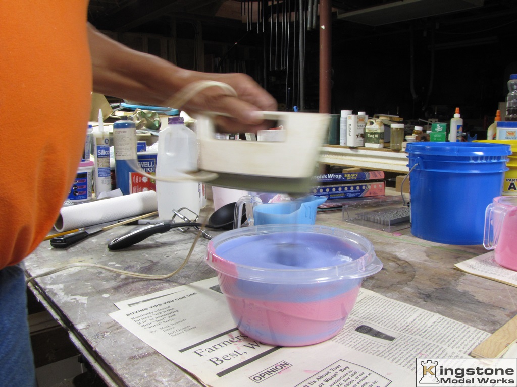

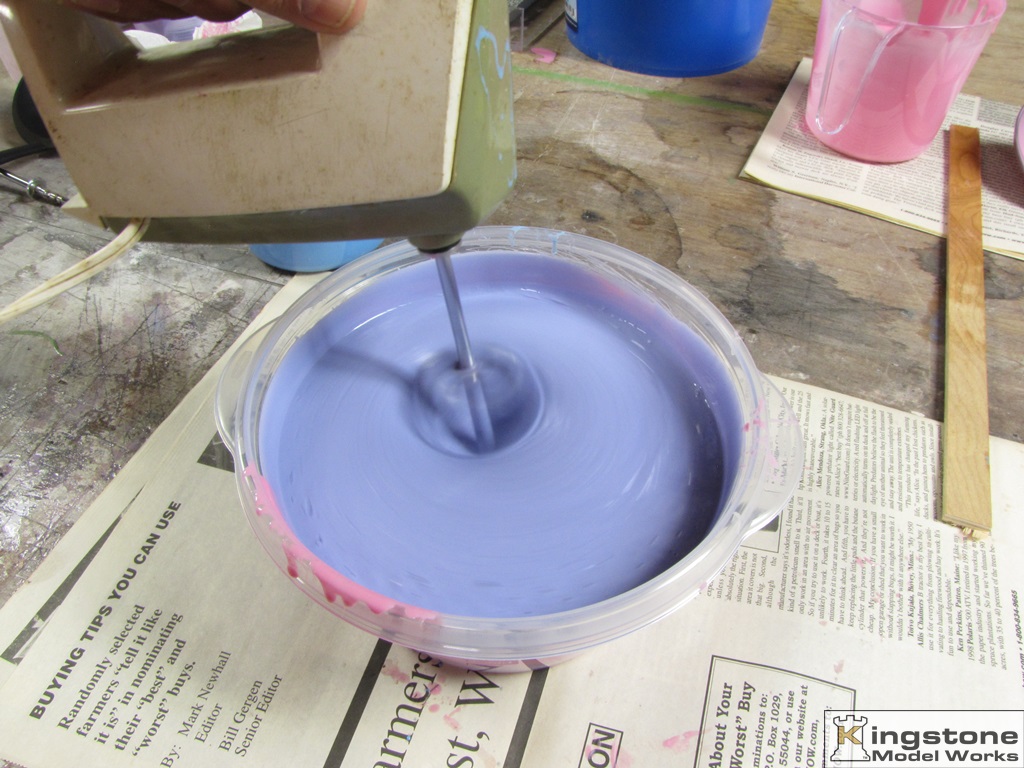

Here’s where the fun part begins. I’m pouring in Part B while using the mixer with one beater to stir (beat) the two parts together.
Once it’s all poured in a good mixing ensues.
The two parts are mixing very good here. I have the mixer on its lowest speed.

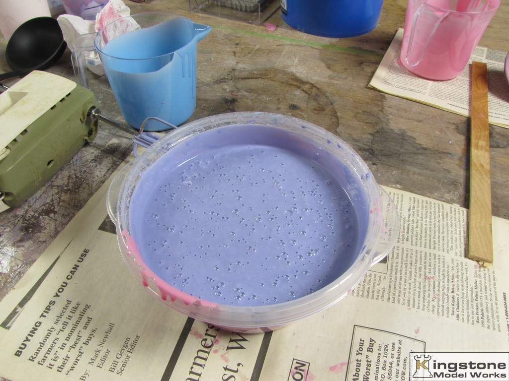

Looks like I added to much yeast. <BG> I figured I’d have bubbles, but this many?

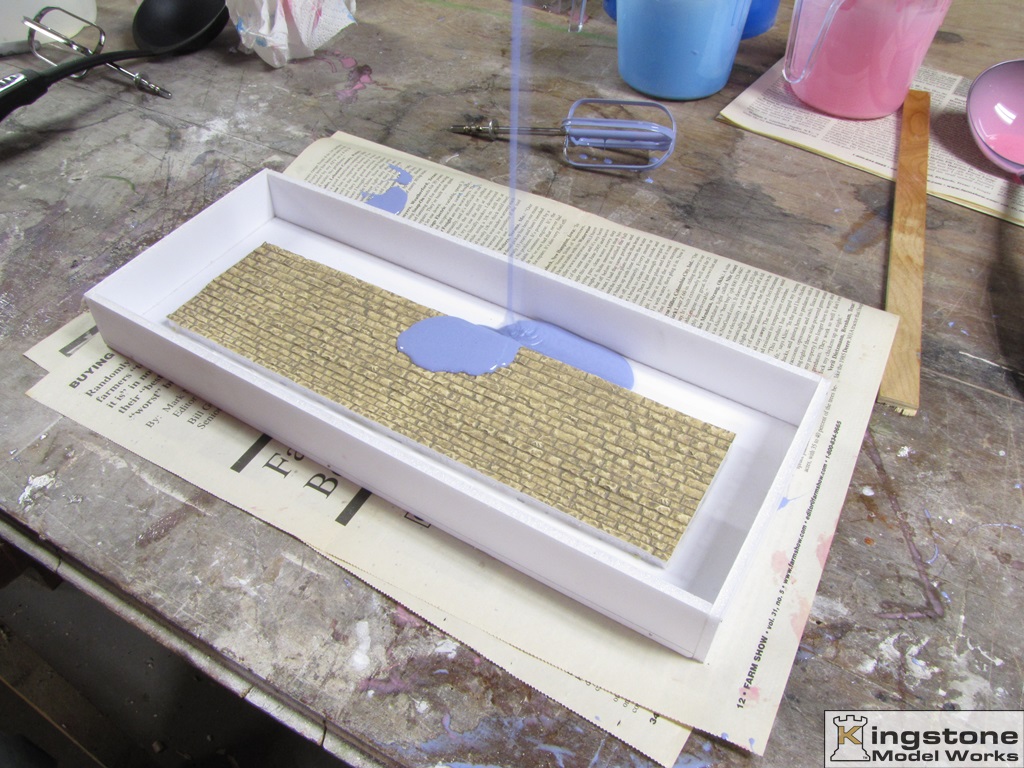

Before I started pouring the rubber I let it sit for a few minuets before pouring over the master. Pouring from about 1 to 1.5 feet up helps eliminate many of the bubbles. Also just pouring a thin layer over the master and letting the bubbles surface helps.

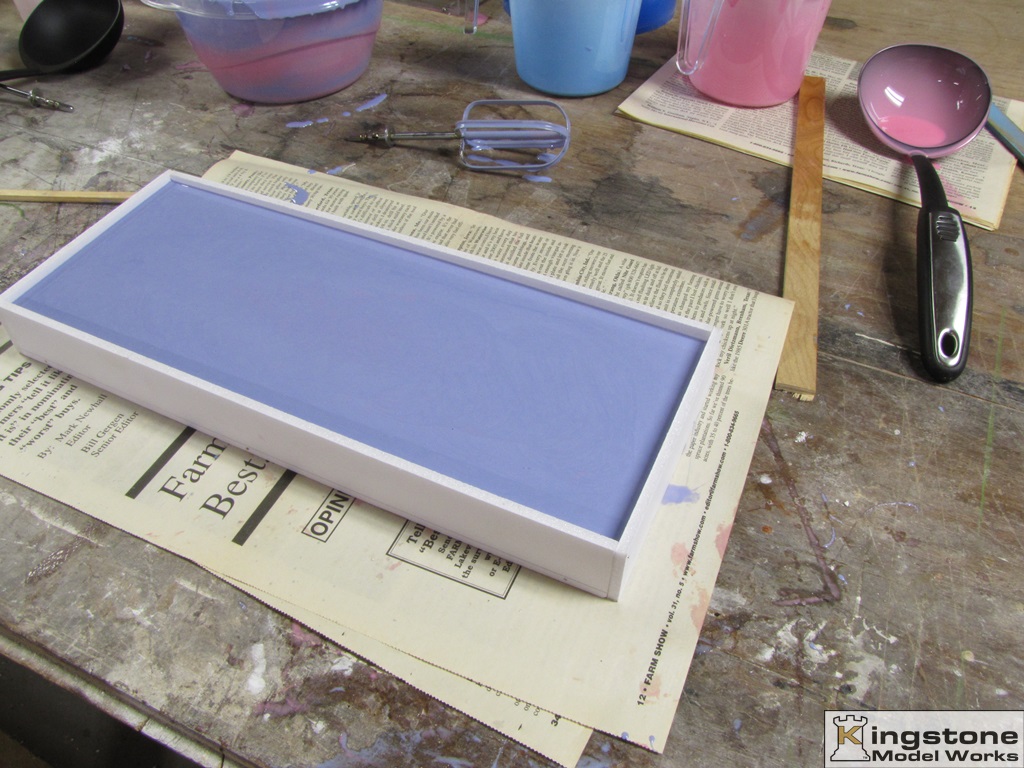

And after 5 cups of RTV the mold is not quite filled up. In 24 hours I’ll de-mold it and we’ll see what we have.

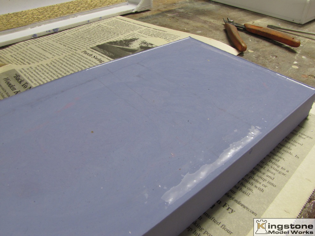

So this morning I pulled the mold.
A quick close up shows no bubbles in sight.
Here’s the impression. I can’t find a bubble anywhere, can you? The sides need to be trimmed a bit.
I did destroy one of the sides. No problem. I’ll just make a new one the next time I need this mold. Hopefully it’ll be a long time.

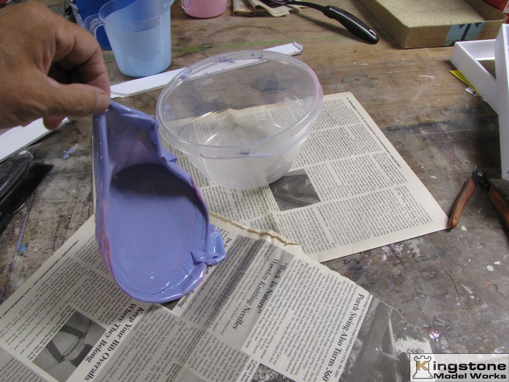

Cleaning out the bowl is quite easy the next day. Just pull the remaining material from the plastic bowl.
