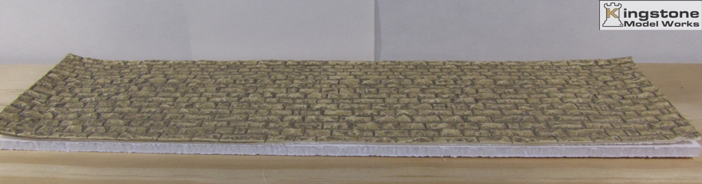

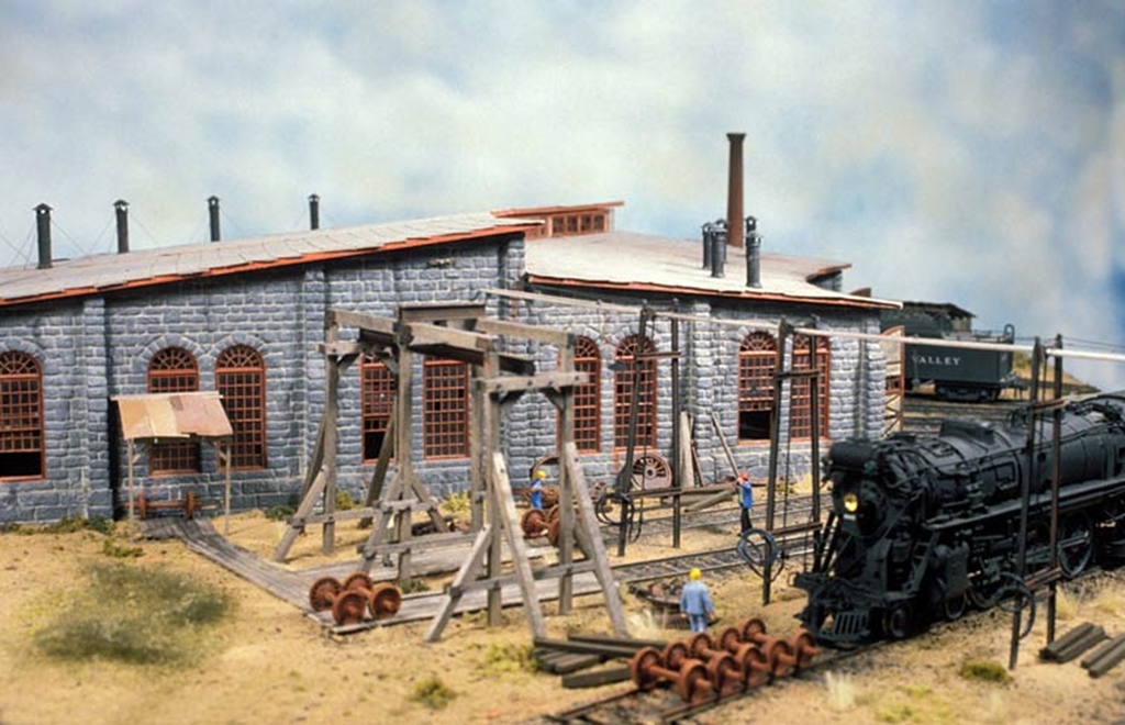

I didn't state it right as to what I want to accomplish. Here's a picture of the South River Model Works block roundhouse.
Notice the two bottom rows of blocks. They are quite even in size all along the length of the wall. They also seems to stand a bit proud of the stones above. I also want to attain a more balanced look. If they had ever sold individual stone molds I would have bought those and not have to cut the stones from a solid wall casting. It'll be kind of like I did the walls on the rock-crusher, individual blocks.
I refer you to the pictures on the first page of the different vinyl rock wall products. I will be making plaster castings of these and cut out the individual stones to assemble into a master mold. A lot of work? Yup, but I'm hoping I'll be able to attain a look I like.

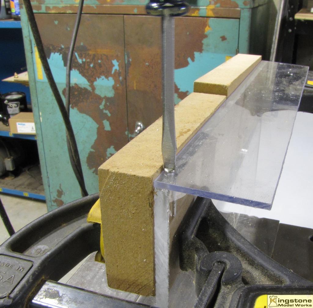

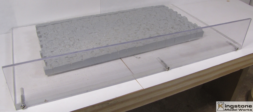

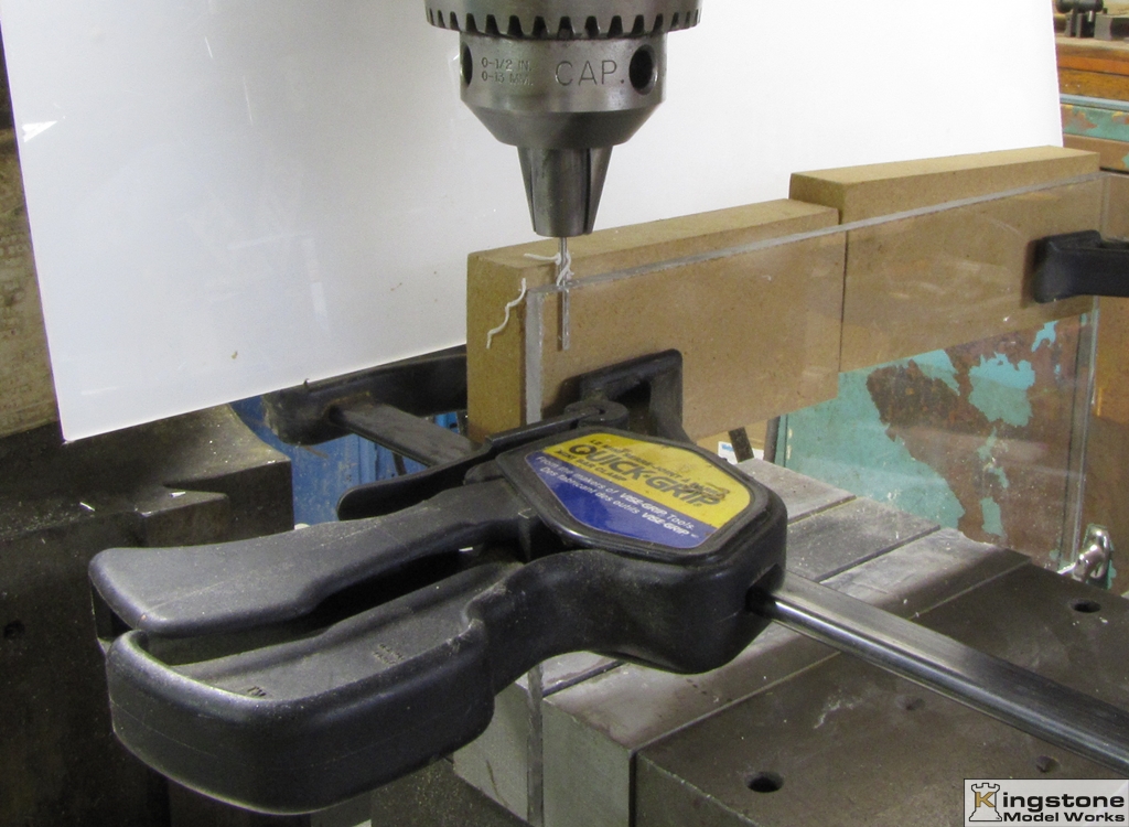

Ok, it rained very early this morning and the rest of the day is supposed to have some rain so I called a "rain day" to do some modeling. I couldn't decide which project to work on. I decided to work on the master rock mold.

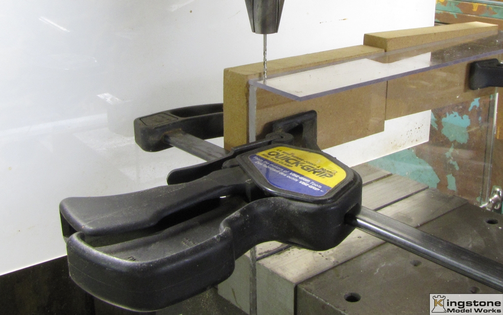

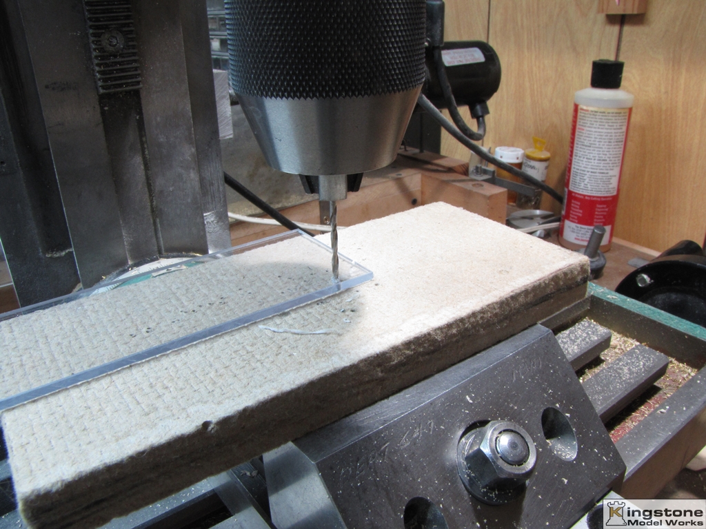

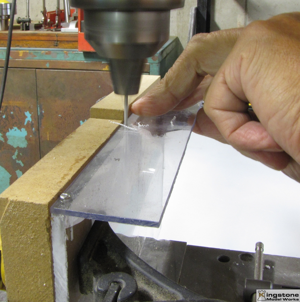

When I left off on the last page I showed how I was going to drill the holes in the Acrylic so they match. What I'm going to show is called match drilling, at least that's what they called it back at work.

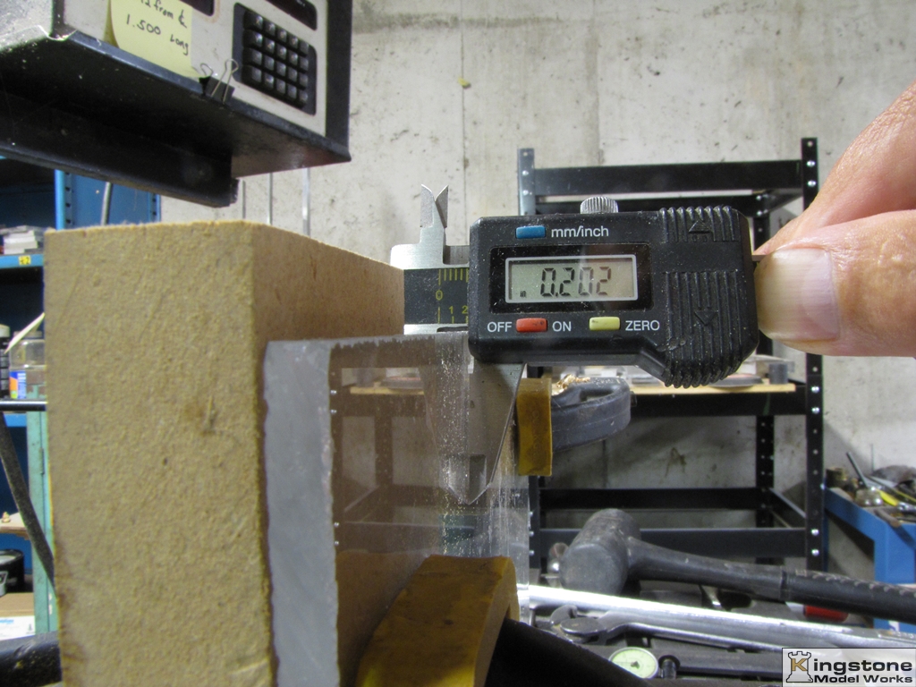

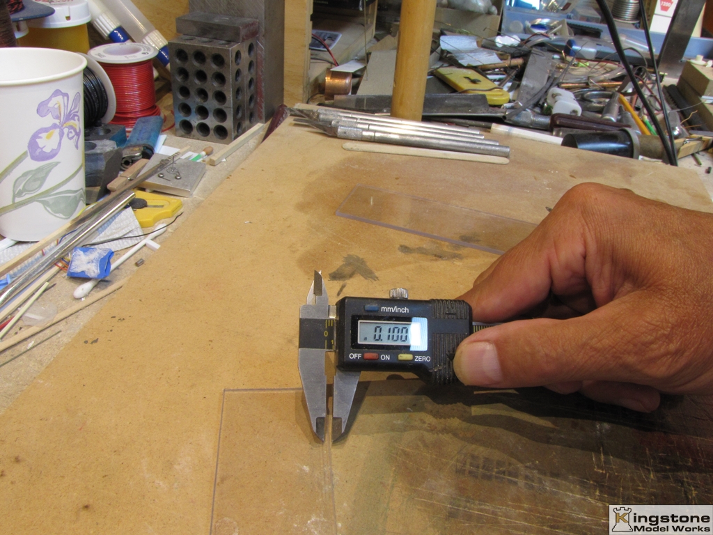

First I found what the thickness of the base plate is.
Taking half of that figure, .100", I scribed a short line on where to drill a #50 (.070" dia.) hole in the side panel.

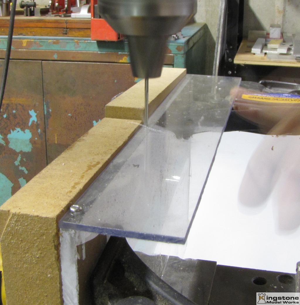

Set up my mini-mill with a #50 drill and drilled a hole .100" from the bottom edge.
Back at the Bridgeport I eye-balled the side plate in from the end and from the back stop. Made sure everything was flush.
Drilled down the full length of the flutes on the drill.

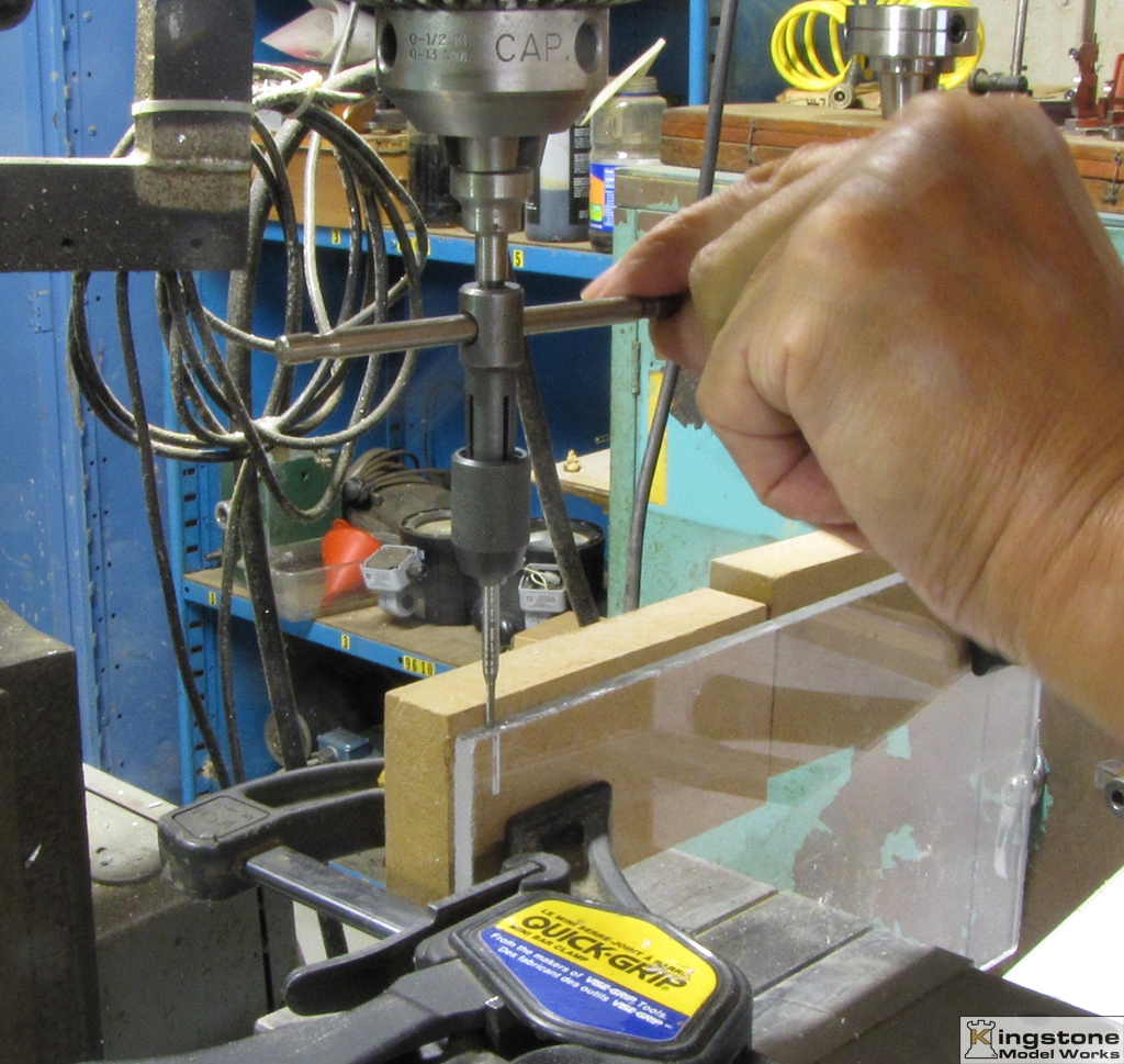

Next I used a center in the drill chuck to hold the tap handle square to the hole and proceeded to tap the hole with hand power.
Open up the #50 hole to a clearance hole for the #2-56 screw and tightened down the side panel.
This allowed me to hold the piece in place with one screw while drilling the second hole.
Holding the side piece against the back stop helps keep everything in alignment.
And the end result. Only three more sides to do.
I know some are thinking this is more work than it's worth, but hey, it's a master mold right?

Bernd.
Where is the "Mr Safety Poster" in that spinning drill bit / finger photo? Glad to see your 'auxiliary' work area is neater than mine. Keep up the great work! It's going to be terrific.
The Safety Poster is behind the machine where you can't see it. Will detail this project to the "bitter" end. [:-smile_green]

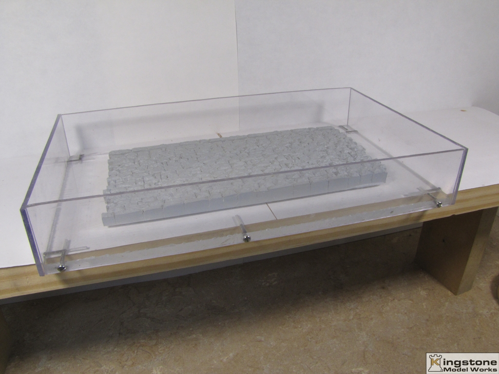

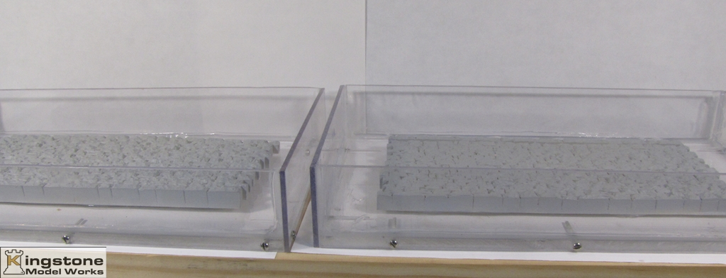

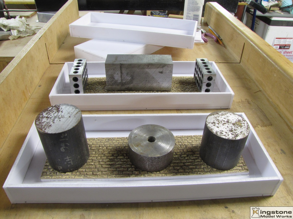

Ok, final picture of the mold box and wall portion. I haven't decided if I wan to screw the wall down or use silicone sealant. The sealant doesn't stick to the acrylic to good.
I have a second mold box to make. I'll wind up with two of these walls. Then I have several more to make for the other wall sections I want to try and make plaster walls from. In total that'll be 7 more mold boxes. Once the mold boxes are all done I'll order the silicone rubber to pour the molds.

So to start off the modeling season I finished up the first two mold boxes. The sides have been sealed with silicone sealant and the walls have been glued down with same. Hopefully they'll hold.
I have four more mold boxes to make before I pour the rubber molds.

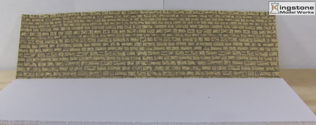

After posting that last post I started on the second set of walls. These are the vinyl walls from Chooch Enterprises.
I was going to use 1/4" thick acrylic to mount the wall to but didn't have any left, so I decided to use gator board. Cut up a couple of pieces.
Now I'm in a quandary, do I make a mold box for these like I did for the first walls or just cut up some gator board and glue the pieces together? Before I decide what to do I need to get some spray adhesive to glue down the vinyl walls to the gator board.

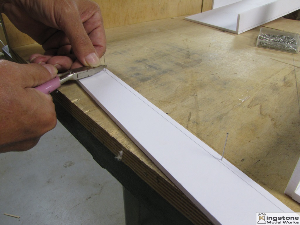

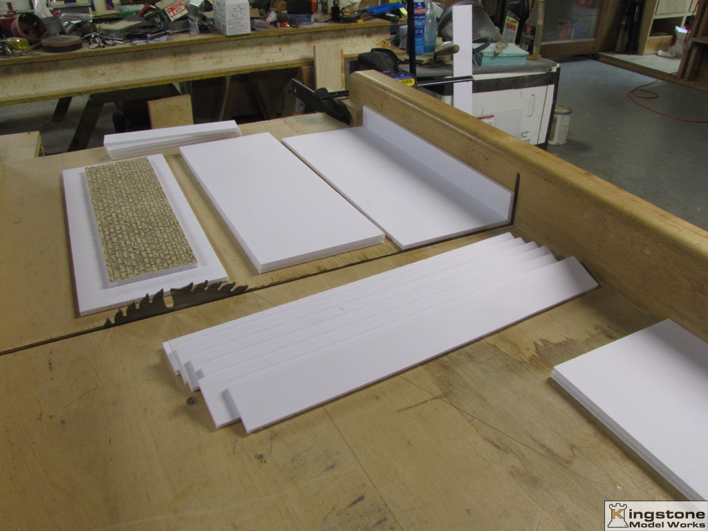

Well, I decided to go all out and use gator board for the mold boxes. The acrylic was to much work and why do I need such a complex mold box for the few times it'll get used to make a mold.
So I used my table saw to cut up pieces for four more mold boxes.
The side walls are pinned together with straight pins and white carpenters glue. The pins help keep the everything in alignment.
I glued the vinyl wall backed with gatorboard into the mold boxes.
I've got two more vinyl walls to mount to gatorboard and then it'll be time to order the rubber mold compound.
