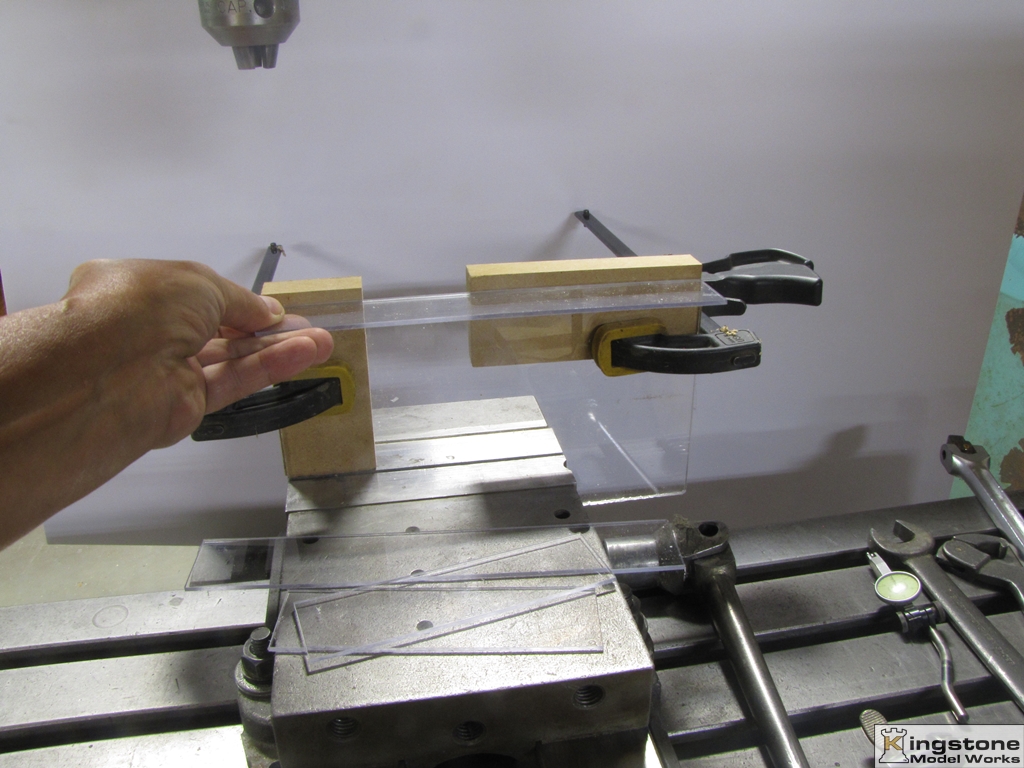

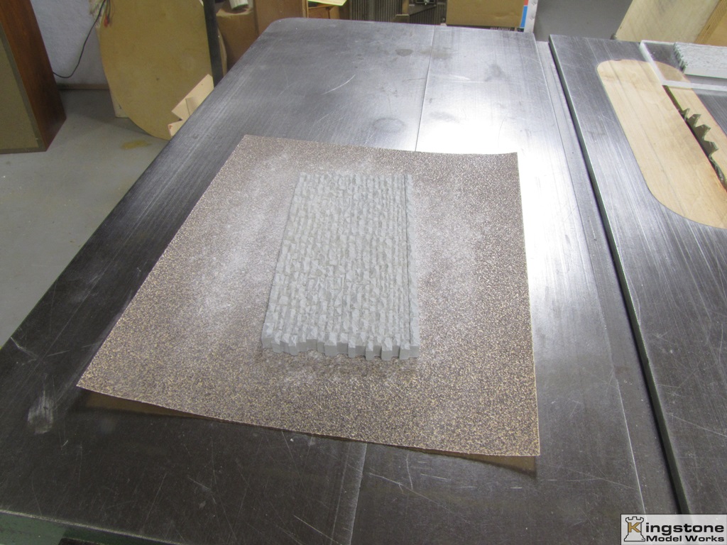

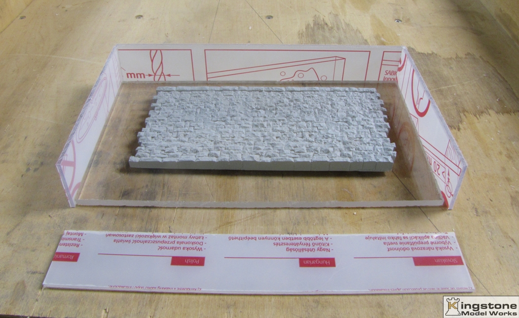

Quick update on the roundhouse project.
Have finalized how I'm going to make the master mold for the stone wall blocks. This will be the first of a set of molds to make the stone walls.
The backs of the, I believe, resin cast walls had a slight depression in the middle and when put on a flat surface would rock some. Using 80 grit sand paper I carefully sanded the backs some what flat so they wouldn't rock any more. Using the flat surface of my table saw to do the work.
I'm using 1/4" thick Plexiglas with a 1" border to glue, maybe screw, the rock wall to.
The sides are 3/32" thick Plexiglas that will be both glued and screwed to the bottom.
I'm using my Bridgeport milling machine with the mold base set on edge to drill holes for 2-56 screws. I'm holding the 3/32" sides so I can drill a hole through both the side and into the bottom of the mold. This will ensure proper alignment of the 3'32" sides.
I know the question, "Why are you doing so much work on a mold?" As I said I'm making a master mold that the stone blocks will be cut out and then a second master mold will be made of the wall for the roundhouse walls. If you don't start with something that is near perfect the end result will not be good looking. Yes it takes time but "near" perfection does take time.

So let me get this straight. You're making a mold of the walls and then you're going to cut the blocks apart and reconstruct new walls.

Bernd, I find it really useful to buy a stone tile (not ceramic, the stone is honed flat) and permanently sprayglue sandpaper to that stone. I think I have 2 different grits done that way. It's a necessity for working with castings to get a smooth and even surface.
Interesting to see your drilling setup!
Yes, you are correct. This way I get to control the size and position of where I want the blocks to be placed. Those molded walls is the closest I could find to the type of blocks I wanted. Also once finished with the walls I'm hoping that the roundhouse will have a different look from the kits out there.

That's a great idea on gluing down the sandpaper. Since I'll be doing some sanding on the plaster walls I'll have to look into that idea. Thanks.
The drilling set up comes from years spent in the machine industry. This way the holes will match when you assemble the parts. I'll do a more in-depth post when I get around to doing that.

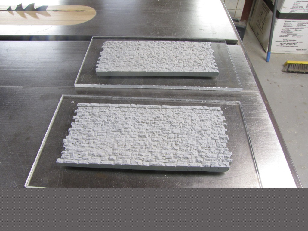

Nice progress Bernd! I like your choice for the stone wall blocks of the roundhouse. Looks as though you are putting a lot of work into this project.
Thanks Louis. I've a few more samples of stone walls that I'm going to use. These are the first two molds. I have six, probably 7 more molds to make. See the pictures of the items near the top of the first page.
I want to make all the molds first before I order a large amount of casting rubber and pour the molds all at once.

Bernd, just a thought...instead of cutting apart the wall into individual stones after casting it,
would it work as well to use a variety of tools (Dremel, hobby knife, small gouge and chisel to slightly change
the faces of stones so they don't look like they did originally? Then you'll have walls that don't look like any
others, but still a solid one piece casting overall?
