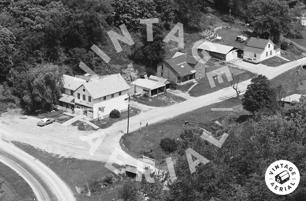

RyanAK
302 Posts
Posted - 01/15/2020 :  10:10:25 AM  Show Profile  Reply with Quote
Interesting views:
I'd guess this is from the church bell tower or whatever the structure is shown on Rob's map to the east of the church. The white building in the background is pretty prominent.
Here's an aerial view decades later.
