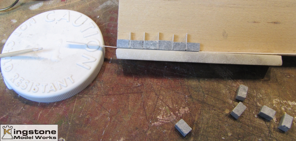

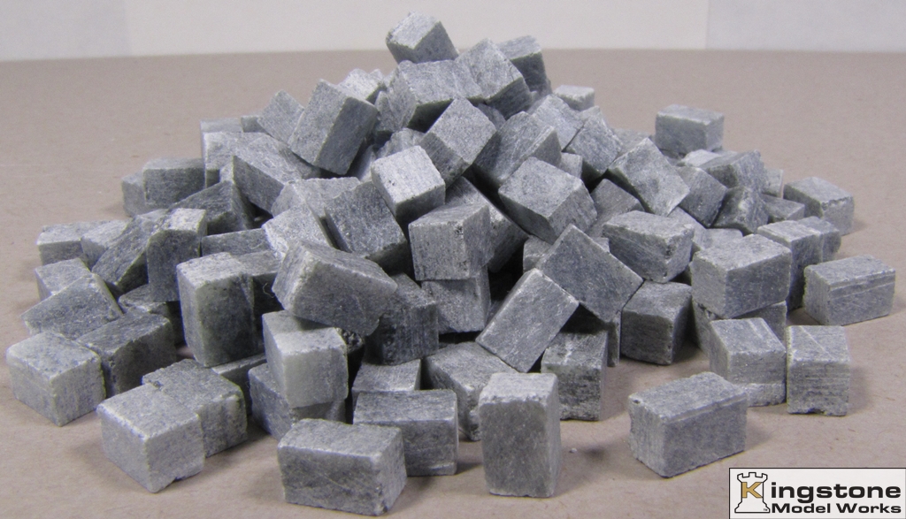

We left off with the sticks of soapstone being cut to length in a jig I made. Ive got all of the sticks cut to length now and gave them a bath to get the dust from cutting off of them.
Heres the pile after a nice cold bath.

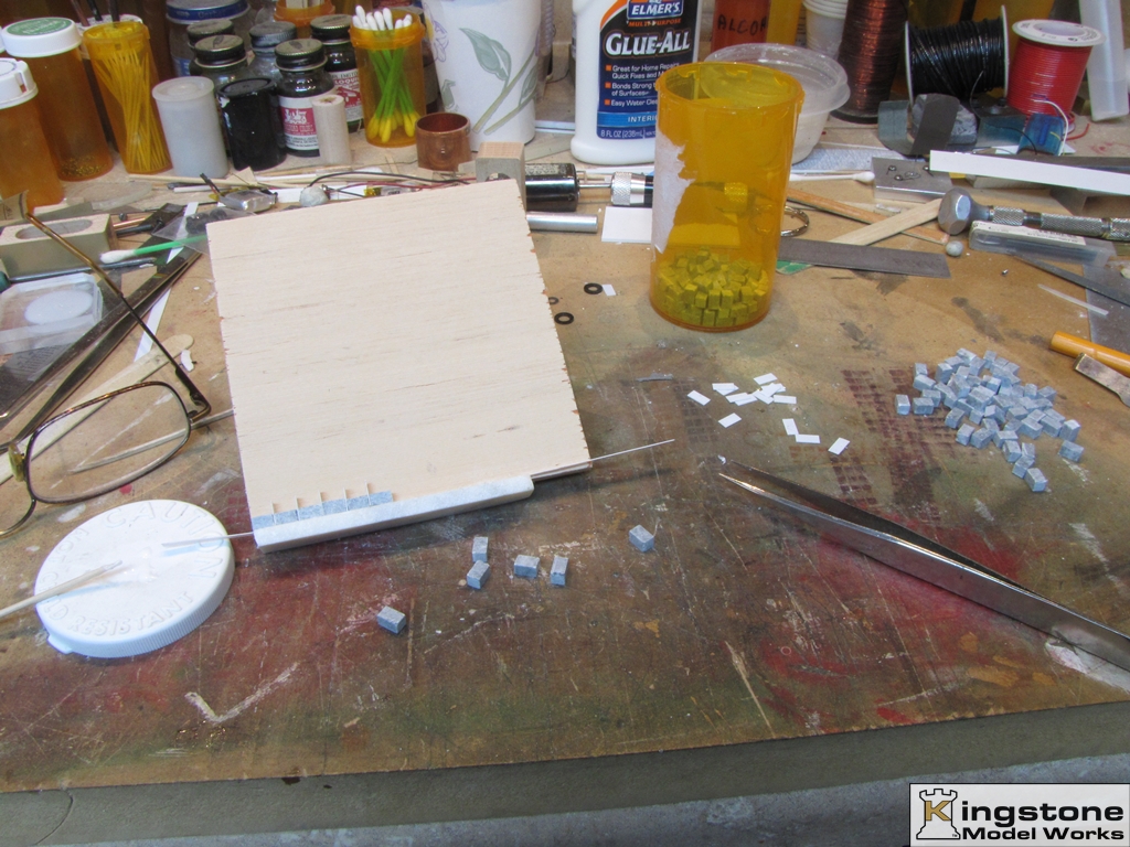

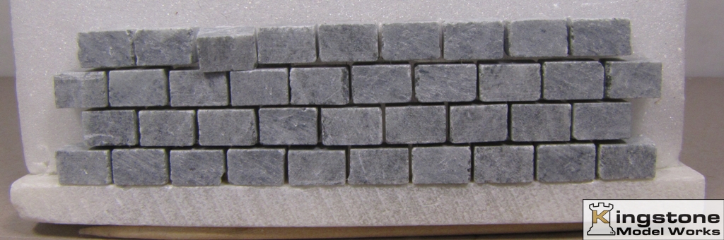

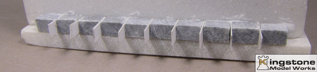

The mock up of the crusher building was made from a foam board with paper backing and just plain foam. I thought Id try the just foam board to glue the blocks to using Aleenes original tacky glue. I used .010 thick styrene spacers between the blocks for motor lines. There will also be one long strip of .010 laid on top of the blocks give a horizontal motor line. The large foundation white block is one of the soapstone used for marking metal.
The glue stuck to the soapstone pretty good, but not so good to the foam board. Notice the third block from the left has come loose just from pulling out the horizontal strip I used for a motor line. Time for some contemplating on what to use. I needed something also that is less flexible than the thin, 1/8 thick, foam board.
After some head scratching and searching around the basement I came up with using .190 Lauan flooring. One side seems to have some kind of a primer on it. I figure that would make a good material to see if the tacky glue would stick to it. I also remembered to add a .010 thick horizontal strip of styrene on the base before gluing the blocks to the wood.

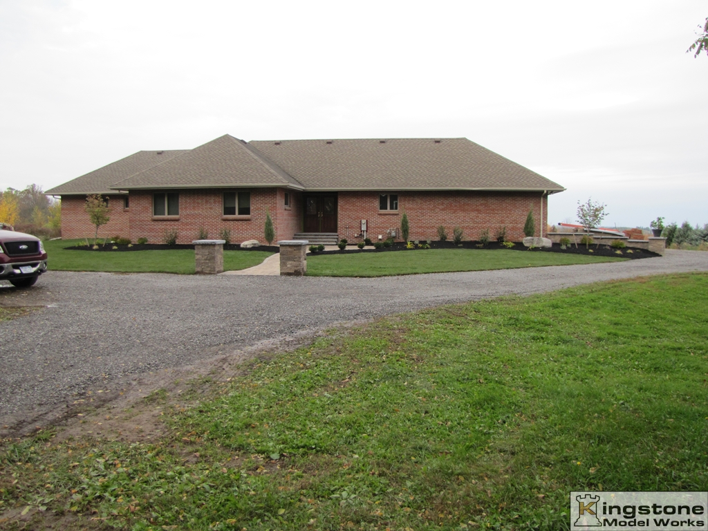

I remember some conversation about HO scale bricks and how its hard to tell from a certain viewing distance the mortar lines. Heres an example. Im about 75 to 100 feet from my house. Notice how the texture of the bricks sort of disappears. Even the pillar blocks that are about 25 feet away from me, its hard to tell where the mortar lines are and that they have a rough surface.
And yes, I laid all the bricks on the house. All the way around too!

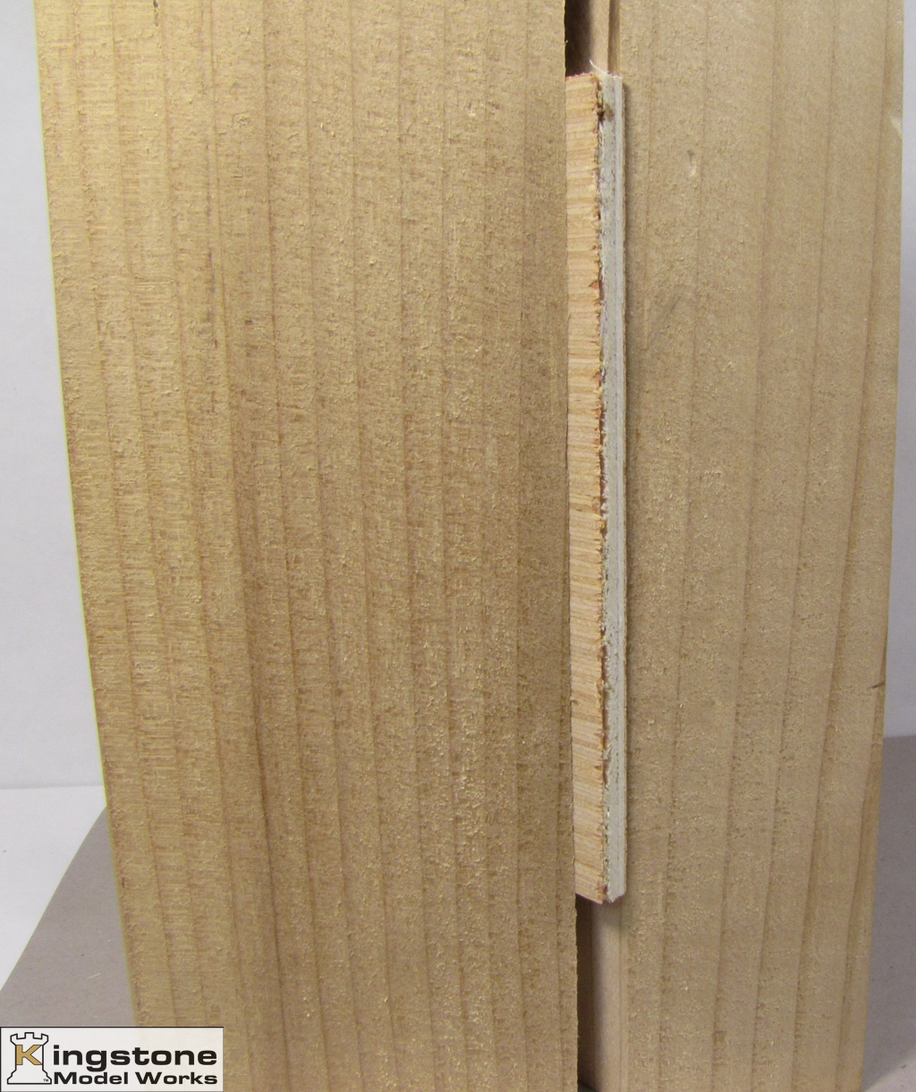

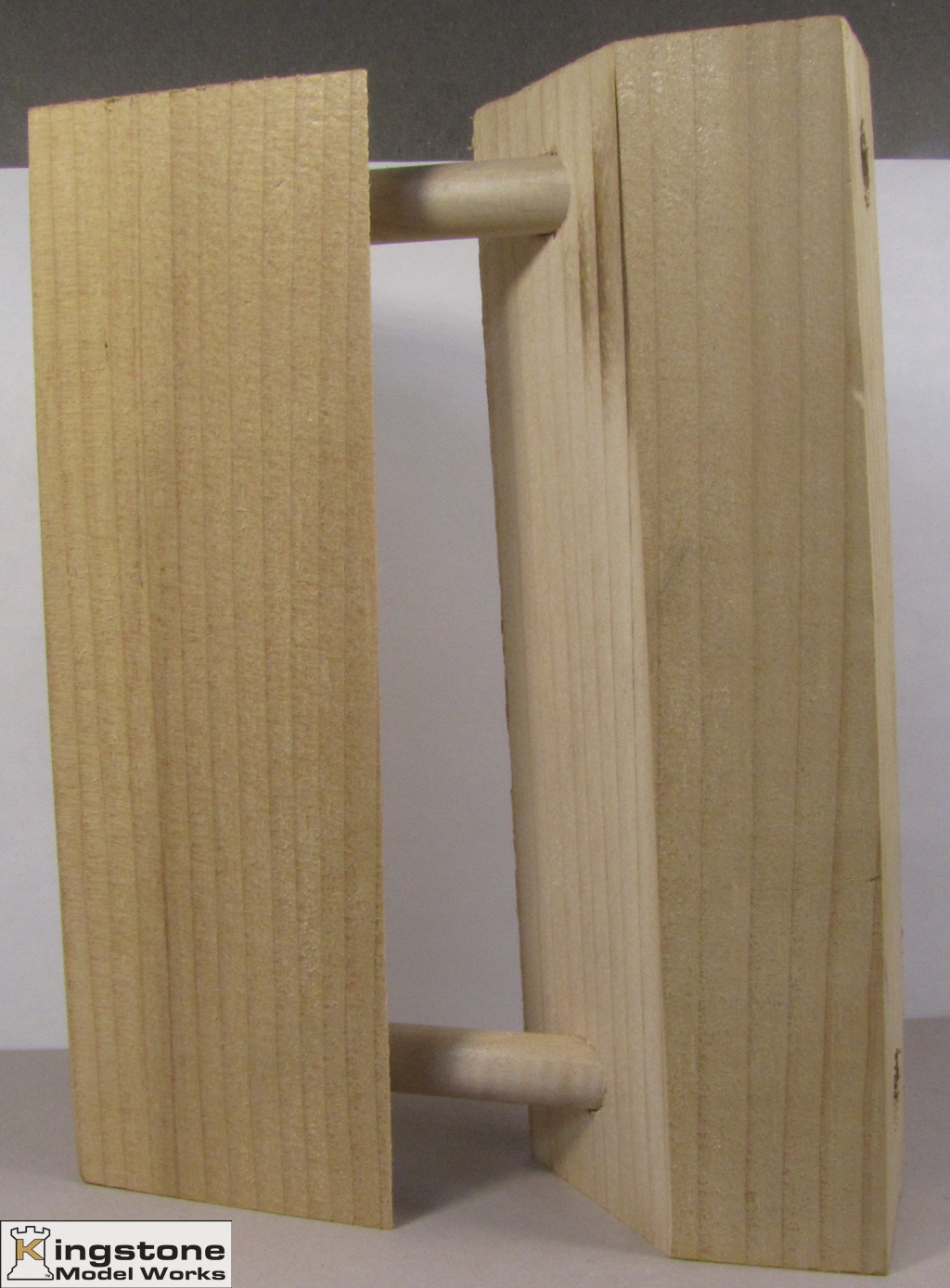

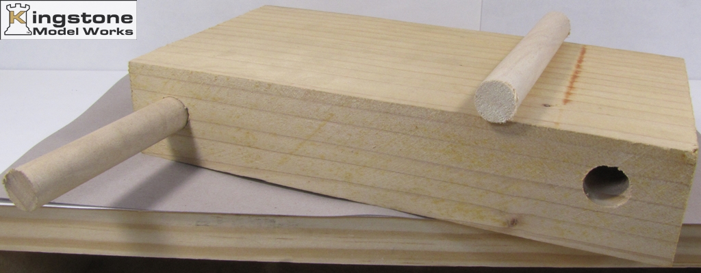

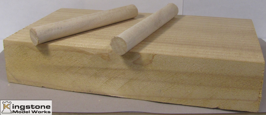

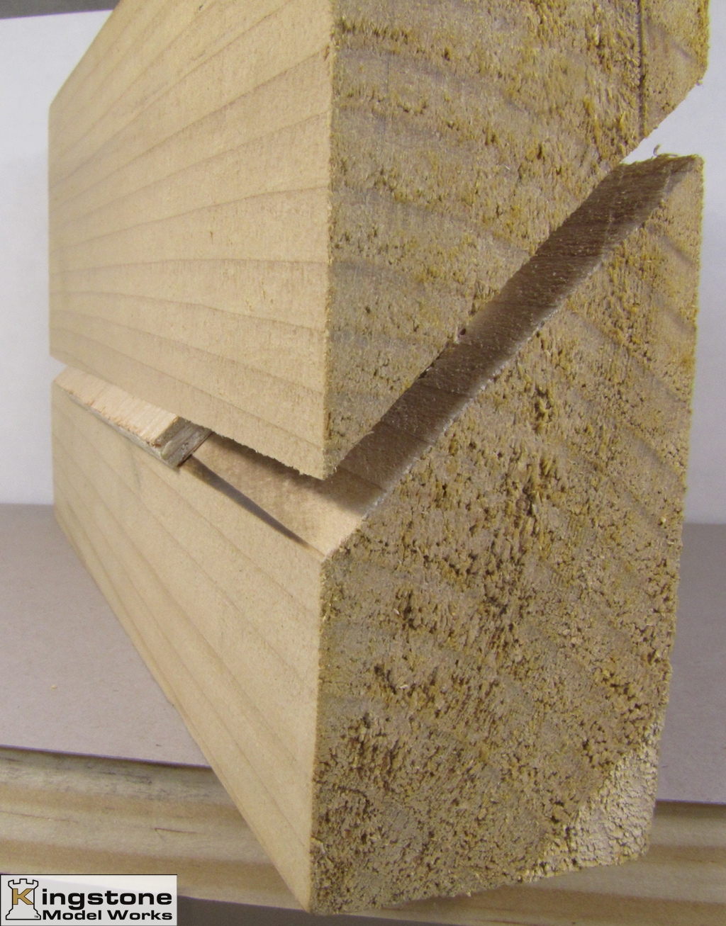

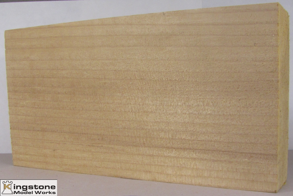

Im going to try Lauan plywood for the core of the building that has the blocks glued to it. In putting it together Im going to use 45 corners. I could cut the 45 angles on the table saw except it doesnt give clean cut on the plywood. So I made a fixture to get better corners. I used a piece of wood 4 X 7 X 1 5/8 as a jig.
The piece of wood.
Two dowels.
I drilled two holes on either side before cutting the 45 angle. This will keep the two pieces aligned when slide together.
A side view to give a better idea of how it looks.
Two views of a piece of Lauan held in the jig/fixture.
