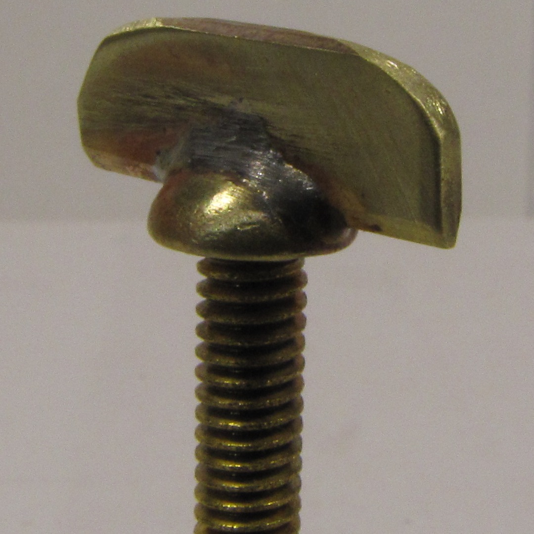

Here's my solution to the screw problem. First I'd drill and tap some new holes with a standard size thread close to what is used now. Then I would use a brass screw with a piece of brass plate solder in the slot of the screw head. Now you don't have to worry about finding the right size Allen wrench or screw driver to fit the screw head.
Here's a pic of what I made for one of my jigs. It's a 10-32 slotted screw with a pieces of brass bar soldered in the slot head. You could also buy a "winged" nut at the hardware store.

Nelson458
3151 Posts
Posted - 10/17/2019 :  10:42:48 AM  Show Profile  Visit Nelson458's Homepage  Reply with Quote
Wow, Bernd, that must have taken a bit of finagling to get that on right. I would not have thought about doing that. I had left a review on MicroMarks page about the screw, the box is great, the screw needs replacing. Still, a unique solution to a common problem. Thank you for sharing.

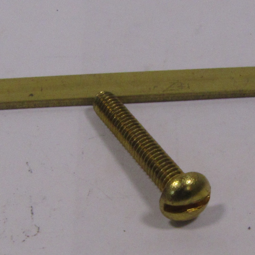

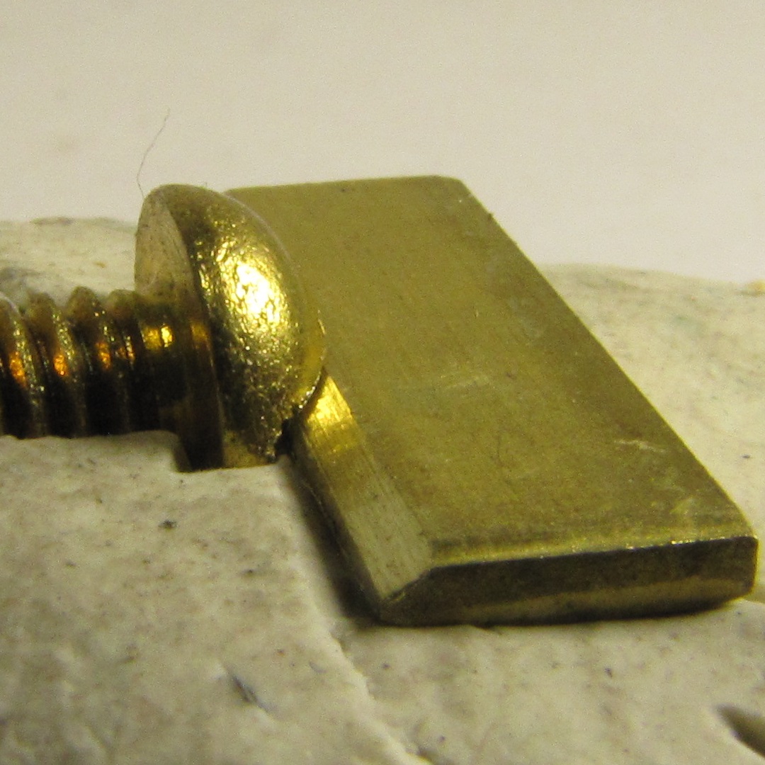

Thanks Nelson & Dave.
Here's how easy it is to make.
I used a 10-32 screw and a piece of 1/4" wide by 1/16" thick K&S brass.
I cut a piece about 5/8" long, file a sort of knife shape on one edge and use a 3 cornered file to open the slot on the screw head so the piece of 5/8" long brass piece fits in the slot.
And then solder the piece of brass in the slot.
That's all that's to it. Hope this helped. Oh, it works on all sizes of screws, even metric. Just make sure to use brass.

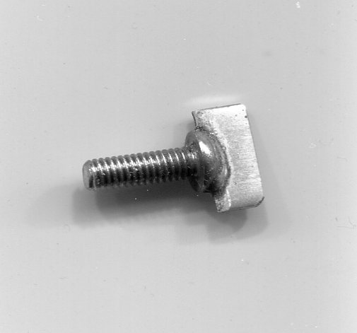

3629 Posts
Posted - 10/18/2019 :  1:17:14 PM  Show Profile  Visit Bernd's Homepage  Reply with Quote
Tony,
The first picture is black and white. The winged bolt is made totally of brass. I did it on the scanner. The one I show in the second set of pictures is total brass also. I think you can solder brass to steal. Might need a bit more heat.
I haven't seen any brass metric screws either. I think $15 for 30 is a bit high. I always buy the longest screws I can get. It's easier to shorten them than trying to lengthen them. Hard to do, lengthening them.
