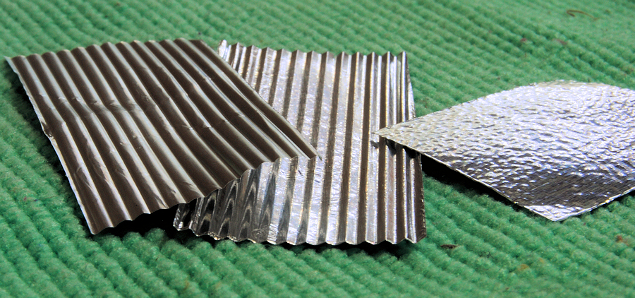

Fassett Studios 1:48 Corrugated Metal Die - $8.99 including shipping -
What I got:
  • An instruction sheet for those that can't figure out that you either (1) rub the foil against the corrugations .. or (2) press the foil between the two dies.
  • Two plastic dies
  • A 1:48 triangle (freebie)
Everything out of the plastic and a piece of 4-ft x 8-ft aluminum waiting. The back of the dies has a pattern on it ...
The die. The corrugations are triangular you notice - CNC milled?
The top piece was formed by rubbing my thumb over the aluminum and pressing into the die. The lower one by pressing the aluminum foil between two dies. The bit on the right is from rubbing the foil against the textured back of the die.
Interesting. The one on top is from rubbing the foil against the die and the one underneath from pressing the foil between the two dies .. and the bit on the right the one from rubbing the foil against the textured back of the die.
.. and the freebie triangle

I used a similar (home made) system many years ago to corrugate HO aluminium foil, and found it also turned out quite well. As you can see, it was a couple of sheets of Northeastern's corrugated siding. (Dunno whether it is still available or not...)
The trouble was though, that the foil is soooooo flimsy that it damages too easily, just with a slip, a crease, or an errant fingernail.
Once damaged, the stuff is impossible to rectify - especially once it has been applied to a model roof.
I tried some heavier gauge foil, but it didn't fold as readily as the thin stuff.
Result?
I no longer make my corrugated iron from foil....
Good luck with it, though.

I want to get my hands on some Food Service Aluminum Foil. This REALLY heavy foil isn't that you see at the supermarket but used by the food service industry.
Trying to figure out online just how heavy the foil is .. is doubtful as they seldom give the thickness (in mills). Example - this product just says "Heavy-Duty". Ok. Clicking through to the buying guide tells us that the 'Heavy Duty' is .009 (gauge?)
The best I can tell from that is that the 'Heavy Duty' foil is half-again as thick as 'Standard Duty'.
Need to check locally for a food-service business

I recently purchased several clear plastic triangles (the ones with the wide base so they will stand up by themselves) from Fassett Studios, and I also bought a set of (1/87) corrugated metal making "dies", although I haven't used them yet. Years ago I tried making my own corrugated metal from cooking foil, using the Northeastern "corrugated" siding as dies. Didn't work very well - the foil is too easily bent, as John said. I think you are on the right track, looking for a restaurant supply place, though. Fassett Studios has some neat stuff in their catalog.

I made my own such a tool. If you use kitchen aluminim foil its easy to damage. Simple solution, fill back side with white glue wait to dry, better is casting resin. Then cut and use.

Try down the baking aisle or the kitchen aisle at the supermarket and grab some of the disposable foil baking pans or roasting pans.
This metal foil is as thick as the purchased corrugated material.
It provides very sturdy and useable corrugated panels.
