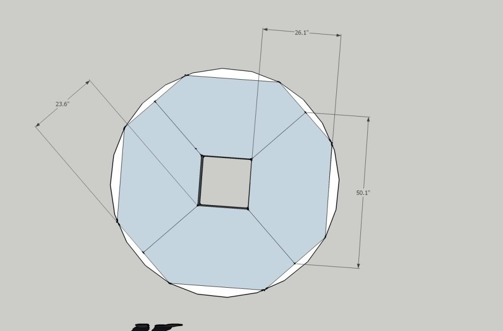

Fast sketchup of the basic module shape...
and 4 together in a circular shape
Sorry guys measures in mm programs that way here..

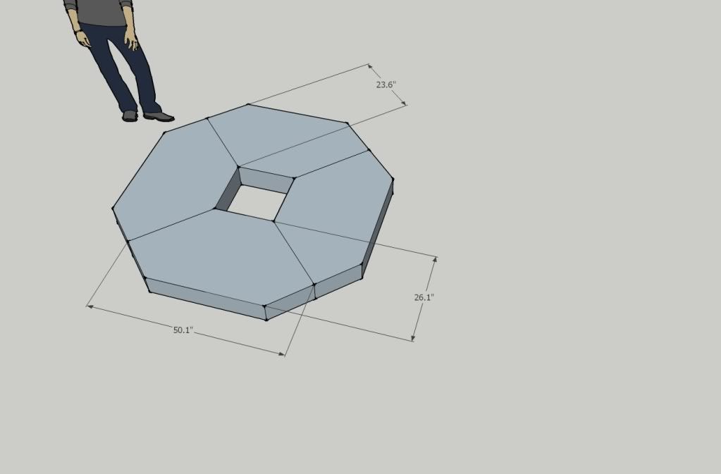

4971 Posts
Posted - 06/21/2012 :  11:49:38 AM  Show Profile  Visit milocomarty's Homepage  Reply with Quote
One more with all sizes...
Thing it's very easy to attach a few straight modules. These one are on the longest point about 4' and a bit..
8291 Posts
Posted - 06/21/2012 :  12:02:49 PM  Show Profile  Reply with Quote
You canucks can convert that....LOL...I had to go cheat
and find that 1272mm = about 50"....thanks Marty....good
start.....How bout one with 1/3rds? ;-)

!/3rds as in 3 modules ?
jcoop
999 Posts
Posted - 06/21/2012 :  1:52:28 PM  Show Profile  Reply with Quote
Martin sent me the Sketch Up files and I converted the dimensions
They are in 10ths of an inch not fractions, but I think we can figure that out.

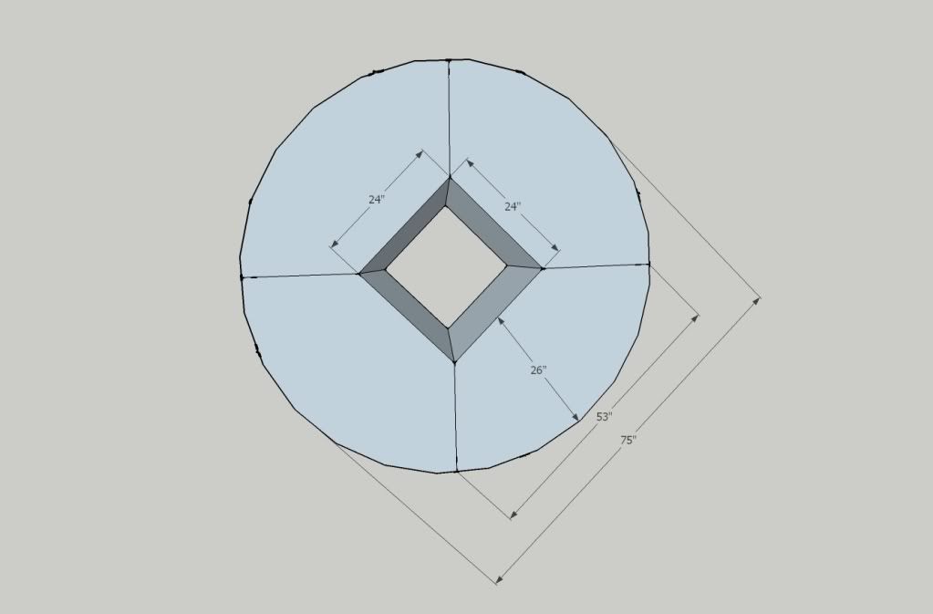

jcoop
999 Posts
Posted - 06/21/2012 :  1:59:02 PM  Show Profile  Reply with Quote
Here is my 2cents
What about making it a true circle?
It adds about 3" to the depth of the mod.
Edited by - jcoop on 06/21/2012 2:01:12 PM
Tommatthews
7357 Posts
Posted - 06/21/2012 :  2:18:20 PM  Show Profile  Reply with Quote
Marty and John,
The drawings and measurements are great.
My thought was a true circle with the inside square (opening) 24" x 24".
Sean_OBrien
151 Posts
Posted - 06/21/2012 :  2:28:26 PM  Show Profile  Reply with Quote
You know though - cutting a circle is much easier than cutting an octagon (or a portion of an octagon).
Find your radii - set a trammel with a jigsaw or router attachment - go to town. Router with a pattern cutting bit would let you cut all your sections to the exact same size as well. Should be able to do a sandwich sheet for the base and than just build a regular rectangular frame under that to hold flip down legs with self levelers. Brace the joining edges with straight pieces of hardwood or aluminum to allow for a peg and socket connection, which would allow you to make setting back up a breeze.
Also - don't forget that there is really no specific reason to limit it to 4 sections. In order to get through doors and what not - you can use a larger radius with more sections and still have roughly the same size for each component - though you would have more of them of course.
4971 Posts
Posted - 06/21/2012 :  2:34:51 PM  Show Profile  Visit milocomarty's Homepage  Reply with Quote
Just a quicky Tom..for a general idea..
jcoop
999 Posts
Posted - 06/21/2012 :  2:37:20 PM  Show Profile  Reply with Quote
How about this?
