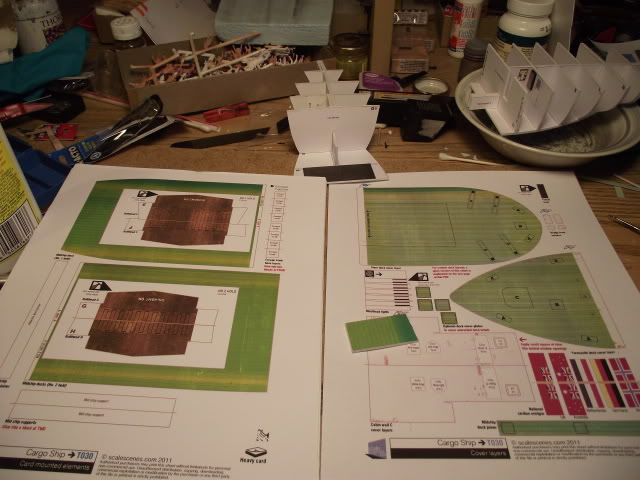

After finishing the Freebie Warehouse kit from Scalescenes: http://www.railroad-line.com/forum/topic.asp?TOPIC_ID=36362 I figured I'd try something a bit more challenging, their cargo ship: http://www.scalescenes.com/products/T030-Cargo-Ship I'll be calling it my Coastal Freighter. The kit cost about 10$ and it's a download from their website. It's comprised of 19 printed sheet of paper and 14 pages of instructions. It comes in OO scale (1/72) but I did manage to shrink it to 1/87 scale without much difficulty. It measures out to just under 2 feet long according to my estimates. After printing the pages out I had to laminate about half of them to different widths of card. I made most of the card by cutting and glueing posterboard sheets together. 2 sheets for the medium card, 4 sheets for the thick card. I used some 220 gsm (135lb.) heavyweight paper for the light card. Everything was laminated together with Elmer's spray adhiesive.
I sprayed all the sheets later with a clear matte finish to seal the colors of the paper.
Since there are 14 pages of instructions I put them all in a binder for safekeeping.

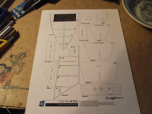

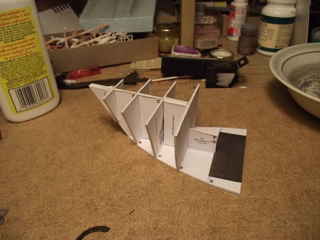

Thank's for your votes of confendence. I'm not sure how this model will turn out since it's considerably more challenging that the other card models I've built. I did start assembly tonight. I managed to turn this:
 Into this:
 This is the bow structure. It doesn't look like much but this took about an hour and a half due to having to cut all the parts out of 2mm thick card. I have a feeling I'll be needing more knife blades...... |

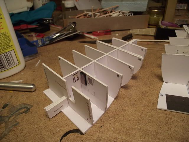

Posted - 04/18/2012 : 09:05:05 AM
I completed the stern structure last night.
 All the parts slide together with slots for easy assembly. There's an open door in the lower deck of the stern so there's some detail printed on the inside. To pass the time while cutting all these parts out I've started to watch a movies or TV. It seems to make the tedium of the job pass a bit better.
Now I've come to a small problem. My printer didn't want to print solid green so my decks are a faded look to them:
 I'm thinking of leaving them as is and calling it 'computer printer weathering' |
