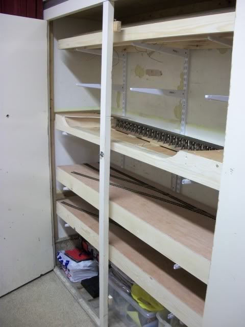

so the W.I. was ****ed of one of 4 cupards (they meet once a month and had 4 and only use one...) and FINALY we had something, and we set to work making it work for us with new shelving.
the largest we can fit, is 5 foot by 17inches so thats what we're working too.
time for some photos i think

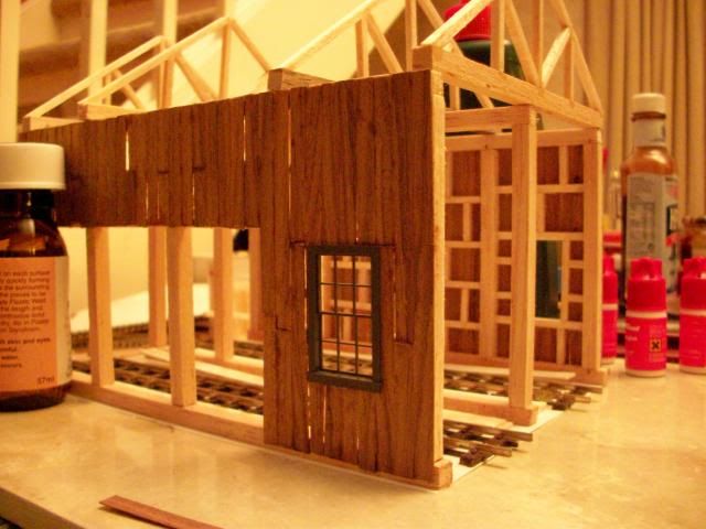

the egineshed im building, goes up the far end. depot in the middle of the loop, streets at 90' to the track with stores and buildings.
just to be different, in that rather random siding, we're having a pickle factory, maybe not quite southern, but different anyway, we've not seen one on a british(built) layout yet

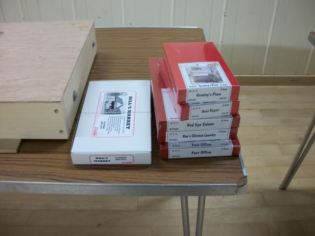

talking of stores and buildings

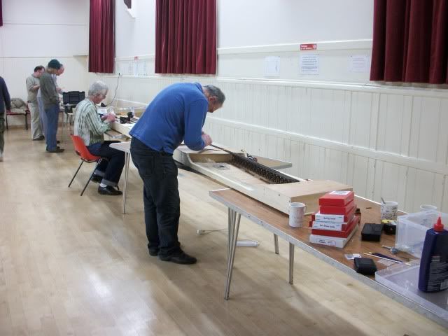

hereis our chairman working away on a board joint i think with other goings on in the back ground (sound fitting a connie, and mr king's HO layout) (worth pointing out he started before him, we have more boards, more track and have already run trains...)

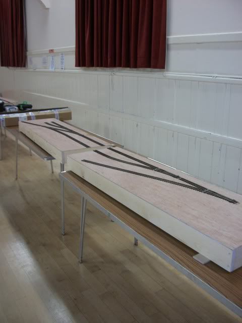

and over all (so far..)

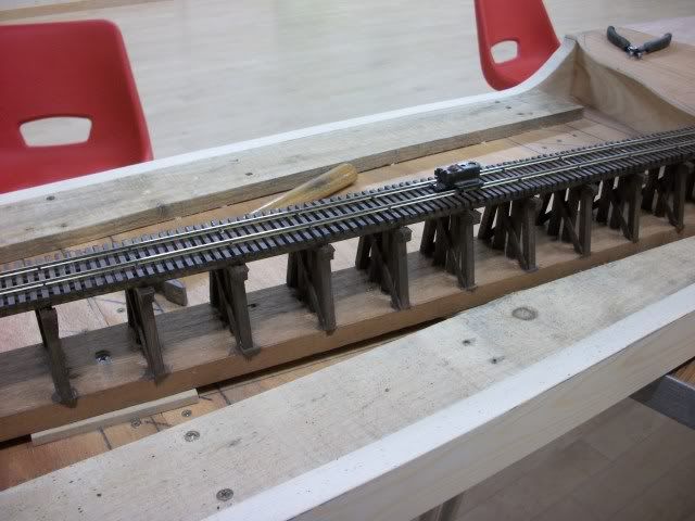

the bridge is the main feture of the layout, we wanted different, we where bored of layouts with short and tall trestle bridges, we went the other way, its coloured with creosote! pretty good match we think ;)

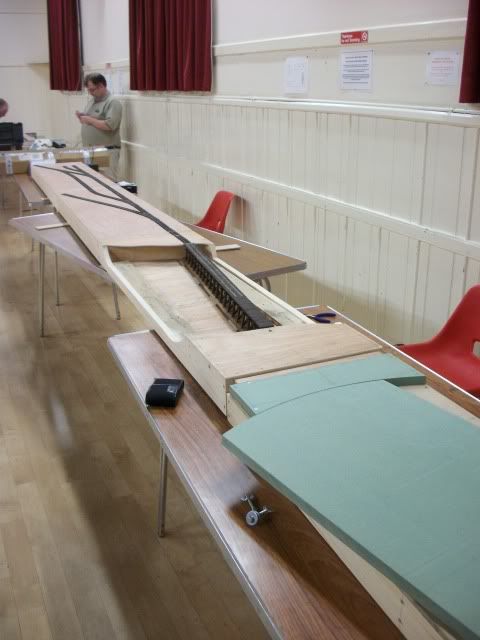

and what about the green bit? well thats the fiddle yard, save picking stuff up (and risking it being droped) the whole thing turns a full 360 allowing us to turn trains around, we think we can get 4 tracks on this.
i also got to try something ive always wanted too, hand laying rail
bit wobbly, but then so is most of the track, its ment to be... if anyone asks

If you want to fix the bit wobbly track, unless you want that narrow gauge charm, you can add more spikes.
Usually every third or fourth tie works well.

thanks rick, so are we too! we will go back with more spikes later, for the moment i've spike right on the bents we'll go back over next week we hope (and run a train over the bridge) however the wobble was where i left the centre line while trying to get to grips with handlaying. its not too noticable, you can kinda see it int he over all photo. at the far end it goes off to the left before comeing back to the centre at the start of the bridge! opps

Andy, Looks great, what is the sector plate / turn table thing made of? What is the green stuff? Looks cool.

peter, MDF, the guy who made it thinks its for outdoor use and hence the green, but MDF and MDF slides well so works for us

Nice ones Andy, good start...but don't try to use the green MDF outside, its moisture resistant for bathrooms and so on, indoor only !

How are you mating the ends of the modules? I'm interested in techniques for the joints in my pier.
3895 Posts
Posted - 01/26/2012 :  12:09:36 PM  Show Profile  Visit andykins's Homepage  Reply with Quote
basic nuts and wing nuts with a slightly oversized hole to allow adjustments works well and has worked well on most layouts we've built. track joints, like my layout and most newer layouts we have worked on, brass screws set at the edges with the rail soldered to them.
