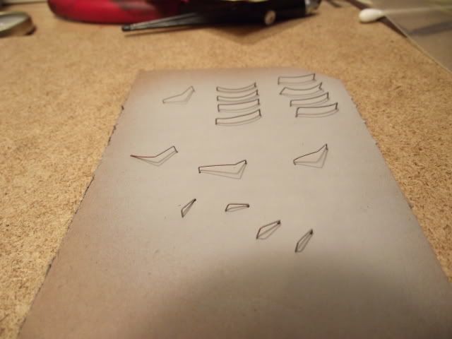

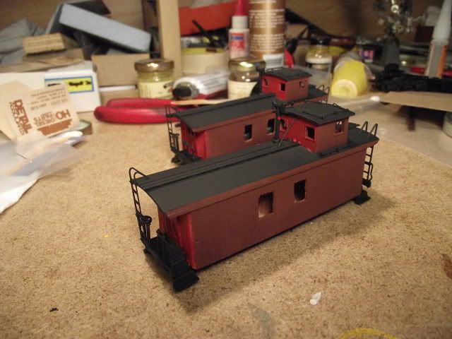

I finished painting the two cabooses today. I masked off the brown I painted yesterday and let them have it with a flat black. The Acrylic paint dries very quickly so masking and painting can be done alot sooner than when I used to paint with laquers or enamels.
I also primered alll the grabs before they will be painted yellow. I stuck them all in a piece or corrugated carboard so I could spray them easily.

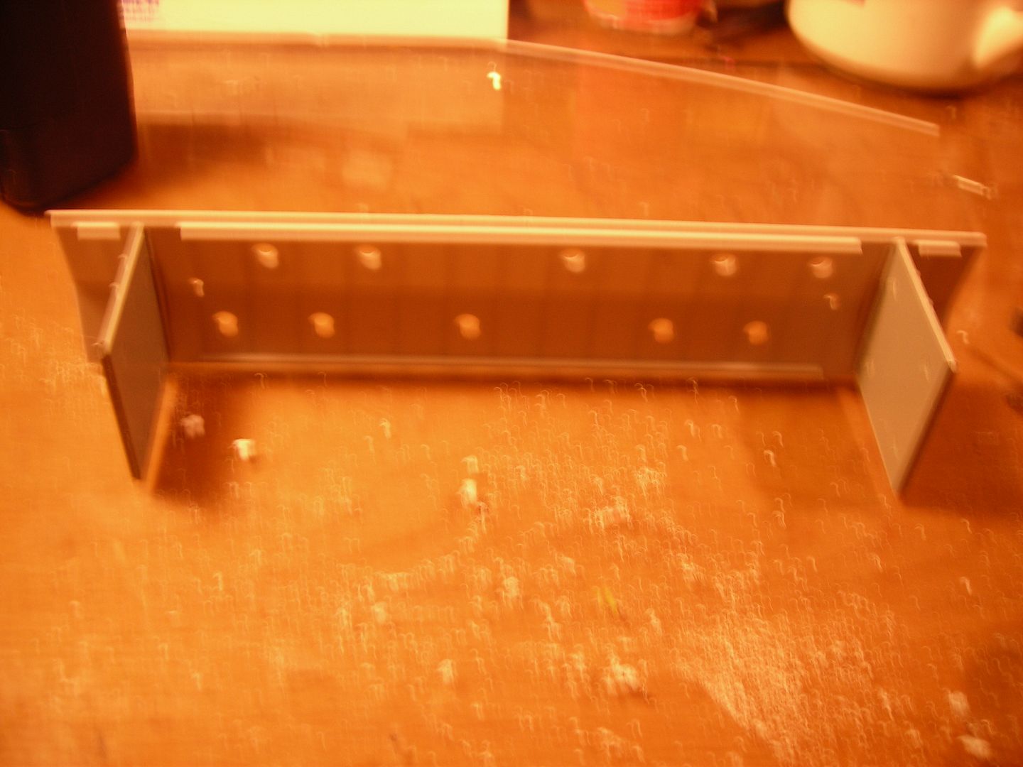

I have finally got my miter box and will be working overtime to get it done on time. Here is the start I made this weekend.
This is one of the sides in the miter box after I had started cutting. I chose each cut that I would get the best piece with the smallest amount of warp after the cuts were made.
Here are the completed sides, there is still some warping but not as great as some of the individual sides. The left over pieces are shown above the spliced sides.
These are the car ends and the rectangular pieces on the bottom of the end must be removed as they are something to do with the Airslide function and are not present on the Dry Flow car. The Dremel Moto Tool came in handy to quickly remove these with the high speed cutting bit.
Ends are glued to the roof casting.
Side are glued to the roof and ends, I first glued the very ends of the side and held the sides in place with clamps until dry. Then placed rubber bands around the ends and glued the sides to the roof casting. This helped straighten out the warp at the top of the car. When I put in the bottom casting and glue it, it should then straighten the warp in the bottom of the sides.
The trucks also have to be assembled, the two completed trucks are shown along with a set still on the sprue from another ECW kit.

Glen and Rick, I admire modellers who take on rolling stock kits rather than purchasing the RTR ones, so ubiquitous to the hobby. Glen, your cabeese will be handsome additions to the end of any train passing along your layout, and you will take great pride in knowing that you built them yourself. Rick, that mitre box sure looks like a valuable tool. I have an old metal one, but it does not offer me the angular choices yours does. I'll have to look into getting my hands on one!
