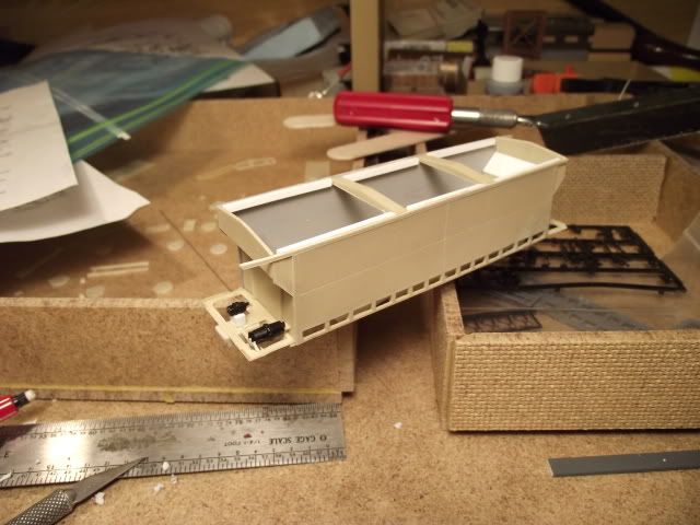

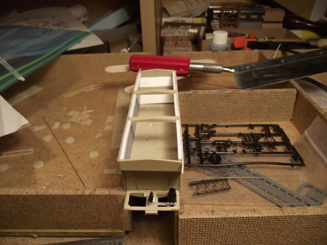

Meanwhile, I'm plodding along with the Hopper.
I started some brake work and added the bracing along the top
I had to replace the kit mount for the Air brake valve and the front mount to the auxillary reservoir due to broken parts. I'm lucky to have a good supply of styrene strip in my collection. The brake parts are Tichy parts the Sylvan supplies in the kit.
The kit gives you .080 X .080 styrene strip to stiffen the tops of the wall, then you notch it out to add the roof cross braces.

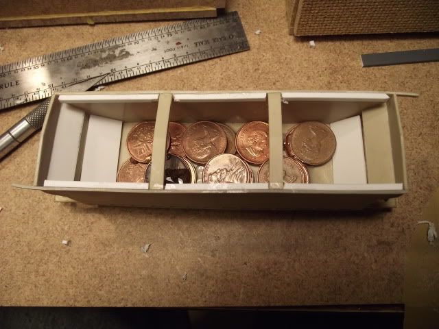

Thank you Mike, I'm learning a few things from your build for an upcoming project of mine.
Just one more pic before I call it a night. Before I add the roof pieces I installed the 'weights'.
Sylvan recomends (I'm not kidding) 16 pennies to be glued down as weight for the car.
