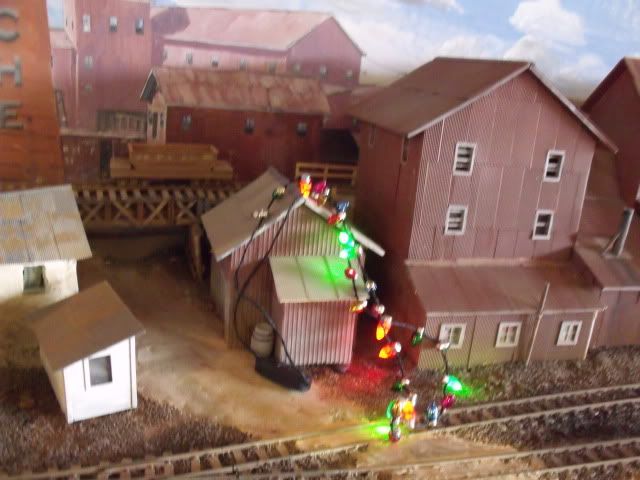

I picked this up today at the hardware store:
Its called "Lotsa Lights Flashing Holiday Necklace," and cost $2.99 at the checkout counter of the local hardware store. The cool thing about it is that it that the on/off switch has three settings, a fast blink, a slow blink and an "on." It also has two extra batteries. I see lots of potential uses, and like the Torre & Prietas management, very cheap.
