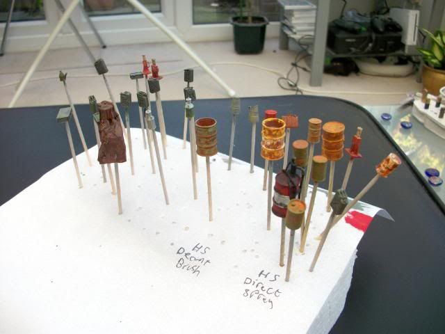

i painted a few details to put in storage untill needed nothing new here, smaller items like jerry cans and boxes where drybrushed the top colour over a black base, and anything rusty was done with rust base/hair spray/top coat/chipping then a wash of rust and brown colours

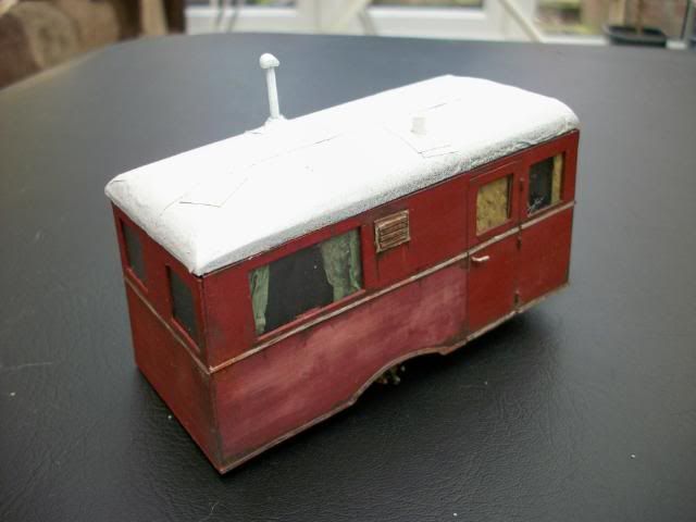

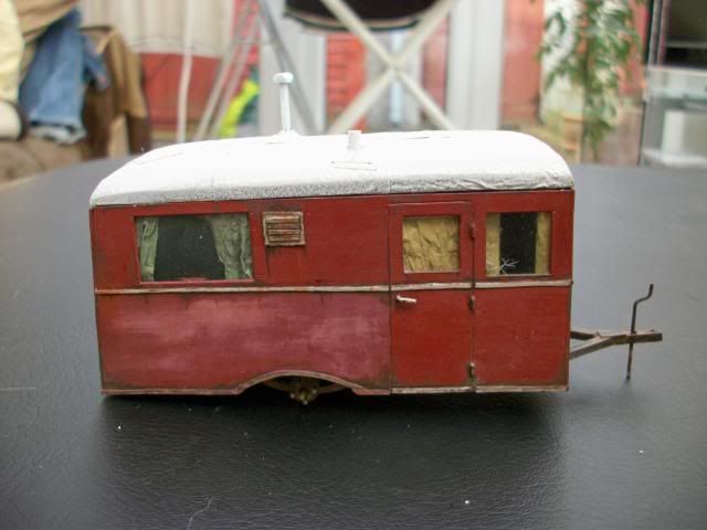

also made a start on the roof. i cut some pine down to just over size on the bandsaw, and shaped it with a sanding disc on my lathe
vents where added, the small one can be seen on the prototype photo, while the larger one was added once proped up on bricks, i would think for a small wood burning stove to keep the agent warm in the winters. then the whole roof was covered in a couple layers of shiny metal duct tape. this hopeful will look like new layers have been added over the years, i also added a patch towards the rear of the roof and cut out patches to sit around the vents. once painted and wathered these will show up more then they do in white primer.
you may have noticed the odd long hair in some of my photos, this is due tot he fact where i take pictures is where the cat chooses to sleep. and i often have to work around her. normaly she sleeps regardless of what im doing, however today she desided to have a closer look at the new roof

That's one good looking trailer Andy !!!

Trailer is a great sratchbuild. Hope the cat doesn't think its a mouse.

OH MY that is super... well done, I like the roof, the windows are great...well done, the little people are going to appreciate the living quarters. Glad you resisted the West Virginia state flower (yard size sat dish). Now it needs an outdoor frige or icebox.

Very nice model, Andy. And your capacity to leave it so close to the cat while you shoot the picture impresses me a lot!

Adny, I really like that trailer. An impressive paint/weathering job!

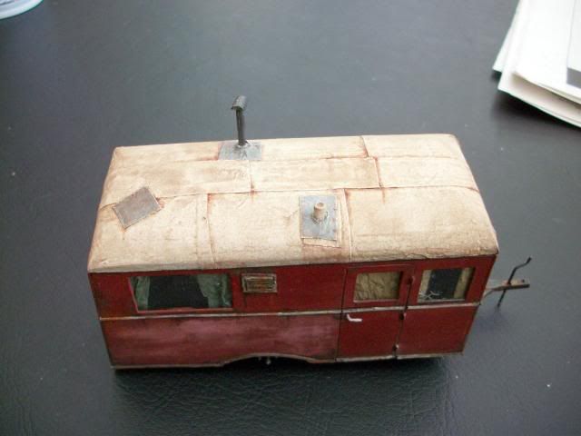

well i got the roof pretty much "done" maybe a few minor tweeks
ontp of the whte primer i have it two thin washes of tamyia deck tan, followed by one thin wash of earth brown, then picked out some of the corners and joins with flat brown. the patches where natural grey with a wash of grey mixed with white.
i cut a bit of plastic card to fit inside the trailer to that i epoxyed the roof in place, quite happy how it looks over all, pretty much "done" with it just want to work on the tounge a bit more, but all the other work, like brick supports, portch and the tarp cover i'll do once its on the layout.
think i'll tackle a outhouse next. not sure of these old trailers had WC's but even if it did i suspect the guy would rather have an outside loo

Awsome trailer Andy, top job on the roof, like it...

Well done I think you have a foreground quality model there. I like the roof, I think you solved that issue well. Looking forward to seeing it in the scene. Some out door chairs ...and details..

The trailer is really looking good.

les im really pleased how the roof came out, was a little worried it would look too "flat" but it seams to have kept a few wrinkles in the right places.

The roof came out great. A really nice looking model.

Andy, you nailed it!
