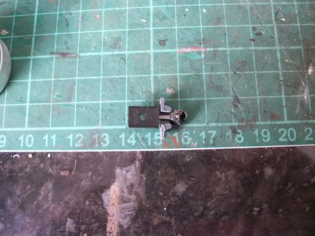

so i found a few moments to check out my grandtline coupler pockets, i was going to use them years ago on something, but couldnt figure out how to work them.
johns newer cars got me a-thinking about them again, and hearing how much trouble he went to cutting up kadee boxes thought id have a root around my collection.
i found the #146 (or whatever the long centre shank ones are with the whisker springs are) would fit, so long as the draft box is fitted with upto the edge of the car, and if the ends on the whiskers are trimmed, since they stick out when centre, also, i figured one could cut a box down to move the coupler out and leave the springs as is but resting agaist the sides of the grandtline part.
(looks like it does not fit in the photo, but the knuckle does clear the grandtline part)

Looks interesting Andy but is there enough lateral movement?

seems to be it can swing all the way to the side and the knuckle would just start to hit the edge of the grandtline part. but i have a loco with couplings fixed that dont swing and works fine because everything else does, so id gusee that a coupling that swings a bit should still be fine
