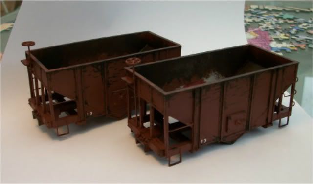

so here are the hoppers ive been working on think i need to re do the insides, i think it looks too rusty/beat up i cant imagen the cars would have been filled up righ to the rim enough times to chip all the paint off.
and the pair
i also tried the gouache for streaking on one side. not sure if i like it or not.

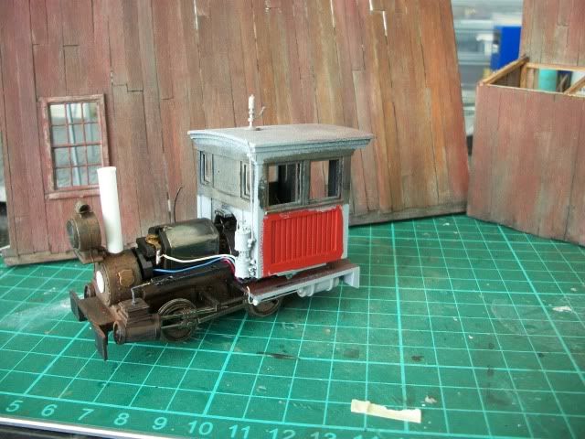

the porter Locomotive im working on now will hopefuly look like a more modern engine. id like to add a fair amount of outside plumbing, with an air pump and air tanks and a steam gen. im keeping the cab the same, but i may fill in the opening at the back and add a door. it would be nice to change the sand dome to a more modern looking one, however being cast metal and part of the tank, i cant be bothered, my story, the loco was modified after a prang. the end :D
going back to the air pump. im trying to find a place to put it. the best ive come up with is on the front of the cab. anyone got any ideas/photos? it dosnt quite fit at the front next to the firebox.

Hi there Andy,
I recently modified one of my Porters to a "Gypsy" style, courtesy of a famous conversion kit, the brand of which escapes me at the moment, and I mounted my air compressor against the cab front wall.
The RH side.
The air tank and feeder pipe.
The exhaust air pipe over the cab roof.
Hope this helps....

great job john, just what i had in mind! only on the firemans side (so i can also hide the wires for the DCC chip) :D a great help indeed

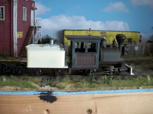

so. after all that fuss and bother with the tender kits own chassis i ordered one from ebay. a 3d printed one.
interesting to see something 3d printed in person, after seeing it on the forum a number of times. turns out the part came from teebeemodels, who has quite a range of stuff on shapeways (didnt know that at the time) and indeed i remember someone building an Hon30 boxcab from one of his print outs.
the texture is. well, yeah. works for O scale, and would work fine for larger scales, but i couldnt imagen it in anything small. quite felixble. rather annoyingly was pack in bubble wrap, and packed in a jiffy bag, so its a little tweeked and will take some fine bending to set it right, also came from thailand. strange since it was listed as france, so i can only asume that is where shapeways are bassed?
anyway onto the tender. with the kits wheels sits almost dead on with the porters footplate.(as shown in the photo) but looked strange with the small wheels, so swoped out for some HO 33" wheels and bingo, sits just under the hight of a bachmann on30 combine truck. spot on.
heres what it looks like.

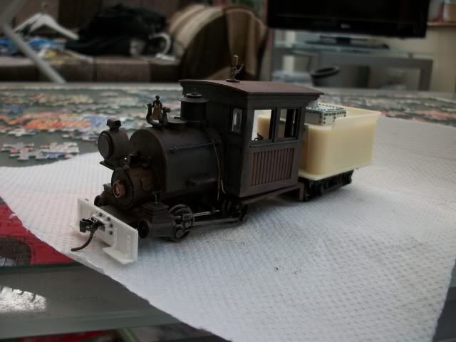

sooooo with the new chassis. i made another start. i added some end beams from plastic section. and cut down the chassis to fit between them. chassis was glued into place. im not sure of its the texture, or what ever the 3d printed stuff is, but the super glue kinda soaked up. still once glued in, it was very stiff and firm, i was worried it was going to be too flimsy. however, once glued in, i coulnt remove the wheelsets. whoops :P

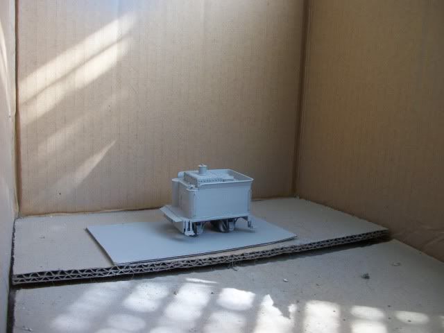

i added some steps, left overs from bachmann parts i got a while ago, made up a coupler box, added some shims of plastic for the kadee. some tube for the link between the engine and the tender, made the fall plate (im not sure what the term is in america for the plate between tender and loco? but then i keep calling pilots beams :P) and here she is in my state of the art paint booth
as for the loco, fitted a small air pump, did the pipe work, redid the pipe work when it hit the rods, and looked really bad when pushed out of the way. made a new chimey out of some tube and microd, removed the front number plate and replaced it with a grandtline one (i really like how flat they are, kinda suits porters) desided on number 4, since 8 is taken by my davenport.
also, i notice on the porter as i got it from larry, had a red-oxide colour in the panels of the cab, i quite liked that, and i remembered verne's 0-6-0 porter that had a brighter red panel and wanted the same for my little lokie :D not in the photo, i cut out a new cab roof that is slightly longer and fixed.
