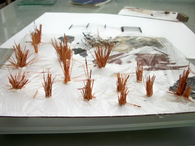

also started some bushes like martins
they need a trim and a thinning out before spreying and going from there, i didnt have any dry lube spray so i used some clingfilm (shrinkwrap) this works pretty well as it takes a little effort to remove it from the base, but firm enough to play around with the bushes.

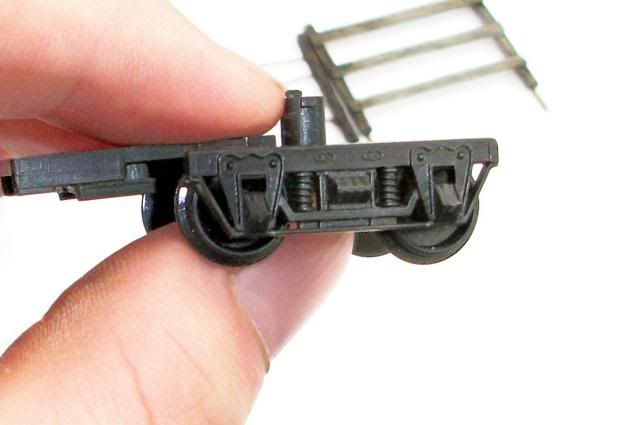

lastly i said a few weeks ago that i picked up some bachmann old time coachs just for the trucks, since they looked just like (oddly enough) like old passange car trucks
see.
the coupling bar will need to come off, as will the push fit bit, but theres already a hole in the centre ready for a screw

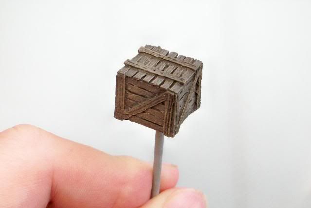

firstly, leo kindly sent me a box of bash fodder, with in where a handful of castings, some i have use for now so painted them over the weekend while we had such lovely weather, but i wanted to try useing only washes.
both started with grey primer, and worked over with layer after layer of very thin paint washes and A&I i think they look pretty good, the rust on the bands of the barrel where done with thin washes of gouache.

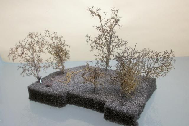

lastly before i go read the new gazette, i started another set of bushes.
just a short bit of wire with all the silly bits of seamoss that fall off and sit around in the bottom of the box, infact i think these would even work as full sized trees in z-n gauge :D however ive run out of the darker grey sprey i use, so these might be sitting for a bit, but the plan is to try some with grass fibers and then leaves/foam, and the rest with just foam/leaves to see what they look like, and lately around here we're starting to see trees with no leaves on so im kinda thinking about making a small tree with no leaves.

thanks martin, id take a photo of the 1st batch but im not 100% happy with them, far to dence, maybe when i can add some noch leaves tot hem they'll look better :P
