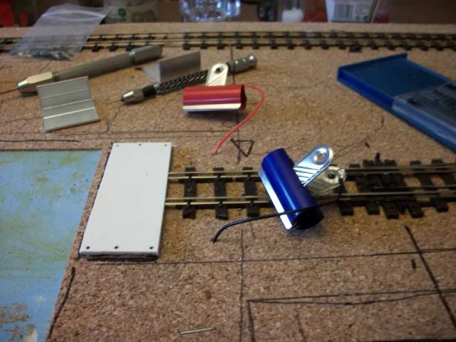

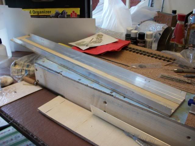

quick step-by-step

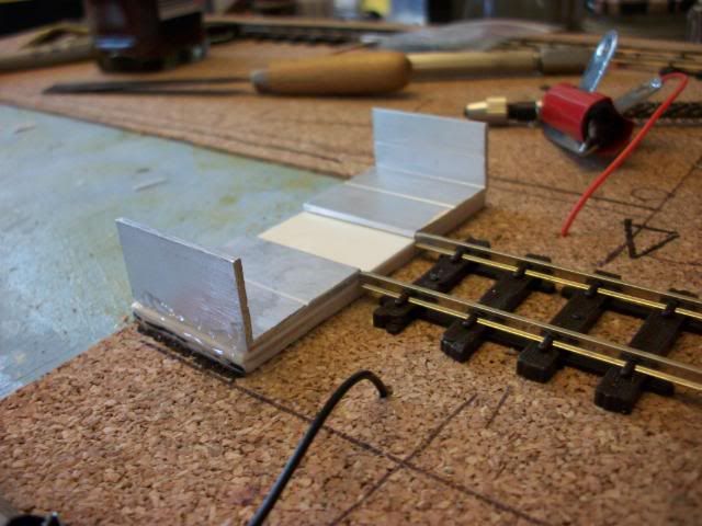

1st with the rail laid working out how much packing was need to get the angle upto rail hight, in this case some bass wood and plasticcard worked a treat. also find the smallest boston clips you can and soilder feeds to them, this will not only provide power, but hold the cassettes in line.
with the base packing epoxed and pined in plae the small parts of angle can be glue din place, and using a home made gauge set tot he correct gauge.

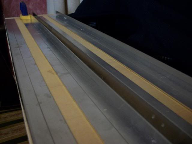

moving on tot he cassette, by luck with out the cork, and using the same 6mm plywood as used on the basebaorad top would make the anlge the same hight as the rail and so the same hight as the smaller sections of angle glued to the board

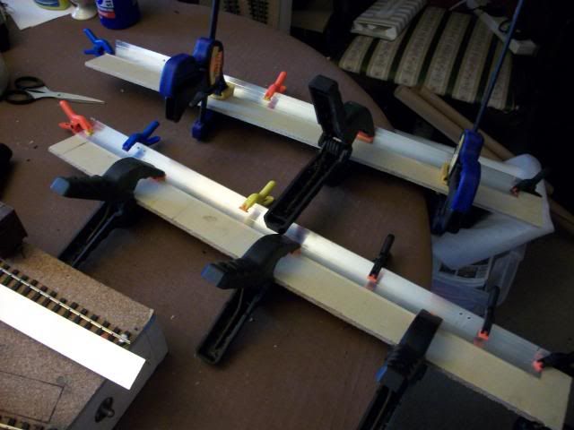

1st glueing on one side of the angle and clamping till set
and when set the other glued into place, again useing a gauge set to the correct gauge and clamped and left to set, once the ply has been trimed you'll have a cassette ready for use.

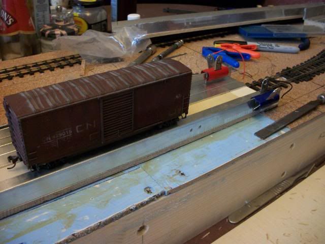

1st checking with a bit of stock that everything rolls well over the joints, so far so good

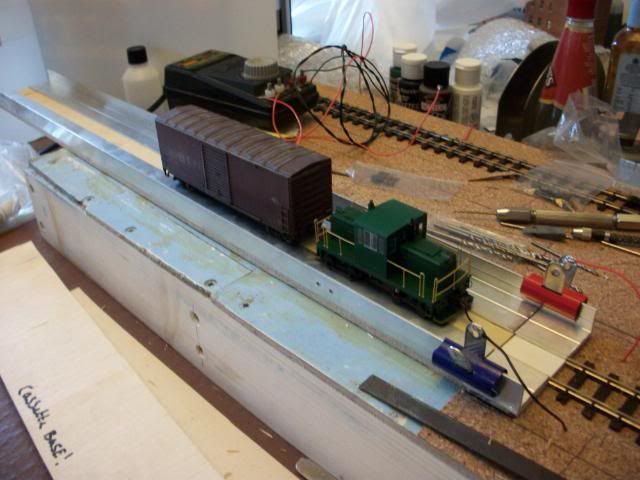

then testing with a loco
by feeding the clips power is right there and has no problems running on the angle, the only thing left to do is make some stops (slots already cut in the angle for these) and some handles (holes already drilled) and help lift the cassettes on and off the layout, also made a little bolt on shelf since the cassettes are 2 foot long and the fiddle yard is about 1.5feet.
cassetttes systems makes for eays and simple changing of trains as well as making of trains, because of the angle you just plonk some stock on, joggle it a bit and it'l fall into to place, so even if you dont plan on having a removeable cassette, metal strip could be used ina staging yad to make railing that little bit easier.

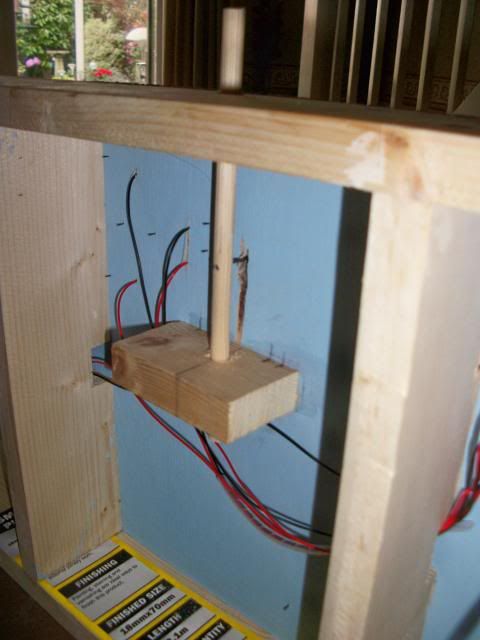

just a quick snap of the point control
quite simply a block of wood with a hole drilled in it, 55mm from one edge, with a matching hole in the side of the baseboard, inline with the hole under the points (made while track laying) and lengh of 9mm dowel is passed thought both holes and a small lenght of steel wire runs up and into the hole int he point switch blade. then the block is glued in place and weighted.
i got the idea from someone who has used dowel and steel wire to change his points on a home layout, and thought by drilling holes .5mm larger then the dowel would be strong enough to hold, and indeed it dose with little play, plus by the time ive trimed the ends and added the back board supports will be well protected.
hopfuly *touch wood* this will stay fool proof. and not to add to switch 4 points has cost me £1.50 id say its quite the bargin. and if i move them over slowly, and run a battery drill at the same time, people will think i have slow action point motors :D

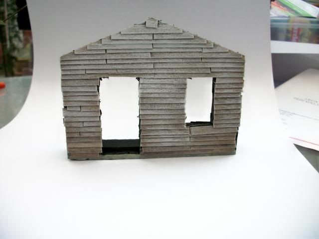

also yesterday i took a couple of my card mock buildings and cut them out in foamboard, (i think its the same stuff troels uses on some of his buildings?) its light, stiff and cuts well, i made a total of 3 flats so far with in 2 hours all parts where cut then glued at once, and it makes for a very solid base.
i also found some prestained wood i did a while ago, nothing good on telly so started to clad one building to get an idea of how it may look. and dry brushed it with white, its not a perfect match for pealing paint, but i like it so far,.
