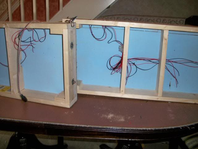

in under a week i have built the base boards (18mm x 70mm pine frame work, with 6mm ply top and 2"x1" to support joins in the ply and have laid and wired 90% of the track.

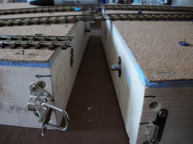

to get rid of the fumbly joints like on my HO layout i had desided to try loose pin hinges, however failing standards in the making of these ment they had far to much play in them, so pattern makers dowels, and over centre latches have been used.
the dowels are easy to fit, but laying th boards down on something flat, drilling a pilot hole, splitting the boards, and using a 25mm flat bit, drill in about 3mm, and on the female side, drill right through with a 9mm bit as well. and the boards will join the same way everytime, the latches just clamp the two together.

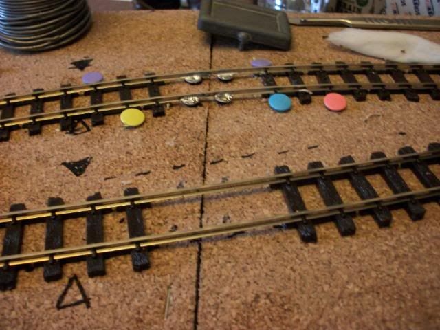

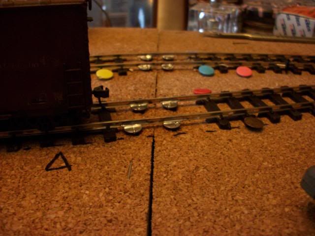

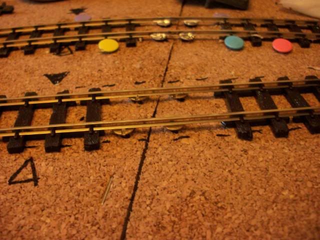

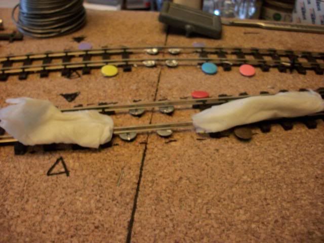

on my HO layout i did use copper clad sleeps (as they are called here) at the edges of the base board. the idea being that this will hold the track in place in case of a knock. however theses where an dogs bottom to get right, and didnt hold all to well, so ive gone back to a tried a tested mehod that i 1st saw use on a now defuct club layout i once belonged too. and a little step by step that might of use to anyone.
1st the track is laid across the join, and ties removed, mark for a pilot hole and drill.
next screw in solid brass screws down, and adjust so they fit just under the rail, tacking care that they dont life the rail. and tin with solder (took a while to get hot enough though)
once you are sure that the track is inline properly, use two bits of wet kitchen paper as heat sinks to stop the plastic chairs melting. and holding the rails firm with a track gauge solder the rails to the tinned screws.
then check with the gauge and a bit of stock to make sure everything is golden, then slit the rails in half and there you have it, solid as a rock track that should withstand a knock or two.

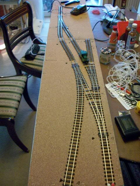

just to end, here is a pic from monday before track work started to give you an idea of over all size, the fiddle yard will be fed via a casset system. and as you can see, fits nicle on the dinner room table while being worked on.

Looking good, I like your rail joining method you have used at the end of the baseboards. I may have to do something similar on mine as some of the track springs up a little.
How do you plan to disguise the screws?

Andy, Fantastic start. Glad to see you decided to build a layout. I like some of you techniques, i.e., snap looks and mateing pins to keep the modules in alignment. Looking forward to your build. BTW, you are providing excellent explanations.

Off to a good start there Andy! I used the solder-to-screws method for my drop leaf bridge by the door, and it works a charm.

max, since thay are below rail hight, just a touch more ballest will hide them, not to add with track as base board edges i ballest alone the sides of the rails too. make sure you get solid brass screws. ive found plated to be an arse to solider too, also clean the tops off with a wire brush in a mini drill as some come with a coating to stop the brass coroding.

Very good ... I sure like the idea of the brass screws. I can think of a few applications where hand laid rail needs to be held solid to make it work.

Your first attempt at On30 looks good, and I like the brass screw method of aligning the track joins.
The plywood used in your baseboard construction is the blue layer in your pix, is it not? This then appears to be covered with a sheet of cork. Should be a quiet runner.

I can see that you Brits are ahead of us on the building of modules. I only found out about the pattern makers dowels a couple of weeks ago and I really like the idea of using the brass screws to hold the track at the module joints, very simple yet very effective.

anubis, yes the ply is the blue layer, any paint would have done to seal the ply and blue just happened to be what i grabed, makes seaing the wires easier too though haha

although it looks hectic. its as simple as i thought i could do, i had thought about bus wires and having the feeds tot he track join at the closest point, but that would increse the number of joints, and the number of placese where things can go wrong.
and the track work re; 4pm yesterday. i was also playing trains *cough* testing*cough* with just a old hornby controller everything works fine.
this morning the brass screws turned up, so the last bit of track, the line to the freight depot was finneshed and wired. and tested *cough* played trains *cough*
next task is to make a start on the cassettes. thats after lunch though.
also dug out an old o gauge building i made for the club, and the club have yet to ask for it back. and plonked it on and worked out a few sizes, and drew on the cork to give me a rough idea where i want buildings, and of what size. mostly just the "flats" at the back.
