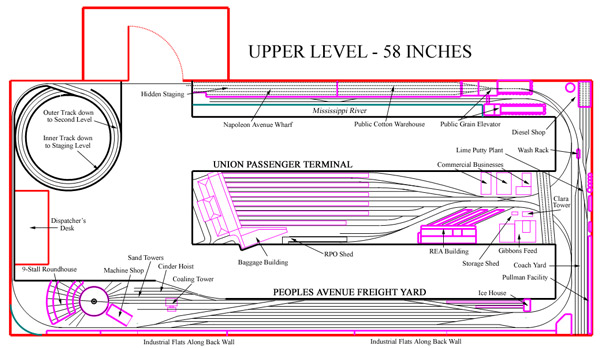

Originally posted by akimmons
Sounds like you have lots of structures to build. Do you have an overall view or trackplan of the facility so we can visualize where everything will go?
Arnold, I spent some time today putting the finishing touches on my updated track plan for the third level. I have labeled all of the major structures; particularly those connected with the NOUPT. This should help you visualize the overall plan as I move forward through construction.
Here is a close-up of just the NOUPT sections. The small writing should be a little easier to read.
As you can see, there are numerous structures left to build for this area alone. I'll probably re-post the plan photo from time to time for newcomers to the thread.

I have to ask - while I'm absolutely in awe of your modeling skills in creating the upper deck structures, aren't the big-time railroading upper deck and the more rural branchline middle deck a bit mis-matched?
Will a lot of the trains from the upper deck progress all the way down the helix to staging and vice-versa, with only a limited number of trains passing through the middle deck? Or am I missing the concept completely?

You are quite correct that the conventional wisdom in multiple deck design is to have yards and large switching areas on the lower level and the narrower, rural scenes on the top. In my case, however, this was not possible. NOUPT is huge, and it was going to require the entire 4-foot by 19-foot center peninsula to be reasonable. This would also require that the space be free from any obstructions; including those necessary to support a level above it. It became apparent that the only way to create such a space was to locate it on the upper level. Now that final construction is well under way, I am pleased with this decision. I enjoy having the large, imposing structures (especially those with full interiors) near eye level. Below the passenger terminal, the second deck is divided into two halves length-wise which worked perfectly for the narrow rural Mississippi scenes. The coach yard and diesel facility take up an additional 2 foot by 14 foot space along the back wall.
On the division I model, the MA&G meets the Southern and GM&O at Slidell, LA and uses their shared track across Lake Pontchartrain into New Orleans. In exchange, these two railroads have running rights on MA&G trackage between Slidell and Mobile, AL. The second level depicts a small section of this shared line. The helix represents the transitional run between Edna, MS and New Orleans.
Only MA&G locals will do any switching on the second level. Westbound Southern and GM&O through freights will negotiate the second level, ascend the helix, stop at Peoples Ave yard to drop off cuts of cars, and then continue to upper level staging. Since L&N traffic also comes from the east but does not share MA&G trackage, its freight traffic will skip the second level completely and go directly from the staging level to Peoples Avenue yard. As for passenger trains, only those from the Southern, GM&O, and MA&G will run through the second level. And of those, only certain MA&G consists will make station stops (some are “limiteds”). All consists from these three railroads, passenger as well as freight, will exit or enter the lower staging level.
The NOUPT served the Southern, L&N, IC, SP, MoPac, KCS, and T&P. My modeler’s license will permit me to include the GM&O and MA&G as well. My main design consideration dealt with the way the NOUPT relates to the rest of the upper level. In theory, the People’s Avenue mainline track facilitates passenger trains coming from the east (MA&G, SRR, GM&O and L&N). It would not look plausible to see the Southern Pacific’s Sunset Limited approaching from the same direction. To eliminate this problem, I designed a five track staging yard which is hidden in the waterfront warehouses on the opposite side of the layout. This staging yard will serve many purposes, including simulating the home freight yards for L&N, SOU and GM&O. During select op sessions, a “guest” switcher from the IC, SP, MP, T&P or KCS might transfer a cut of freight cars to Peoples yard from this hidden staging. More importantly, it provides a point for all passenger consists from the west to originate or terminate.
I realize that this seems like a lot of traffic for a 5 track staging yard. The solution lies in the creation of a Sequence Timetable which will choreograph and schedule the movement of trains in and out of this yard so that both “western” freight and passenger consists are accommodated. These will be pre-staged in the yard prior to the op session. In a typical six hour trick (2 hour op session), five tracks will be adequate for the 6 or 7 trains arriving and departing to “swap places”. Keep in mind that most of the passenger trains in this yard only make an appearance once every 4 tricks, which equals a 24-hour day. When not scheduled, they will simply remain stored on the lower staging level until their next session comes up in the rotation.
One last benefit of the 5-track staging yard is that it allows trains coming from the west to enter from the left side of the layout and trains from the east to enter from the right. While these points of entry would have been miles away from the wye itself, it gives the right visual cues to operators. This is also in keeping with the directionally sincere aspect of the entire layout; east is right and west is left.
The NOUPT will require an operator to assume the role of the station master and oversee the traffic in and out of the facility. Because NOUPT movements will sometimes infringe on the freight yard (for example, express reefers will be taken to the icing platforms), he will work in concert with the yard master on occasion. On the prototype, arriving trains would turn on the wye and back into the main terminal building. After the motive power had cut off and headed for the diesel shop, a blue and orange NOUPT SW8 would spot the head-end equipment on mail and express tracks. Then the remaining consist would be taken to the coach yard for servicing and layover until needed. As the departure time neared, the train would be backed through the wash rack to the main concourse for loading. The return of head-end cars and motive power would complete the process for departure. All of these procedures will be simulated during an operating session and supported by the structures featured in this construction thread. This “layover servicing” will be much more interesting and challenging than simply having trains back in and leave. Combining this passenger activity with local and run-through mainline freight should provide lots of activity for a crew of 6 or so.
I’m sorry for the long, complicated answer, but I hope it helped answer your questions. Hopefully, it clarified my operational goals for the other readers as well. I really appreciate your interest!
