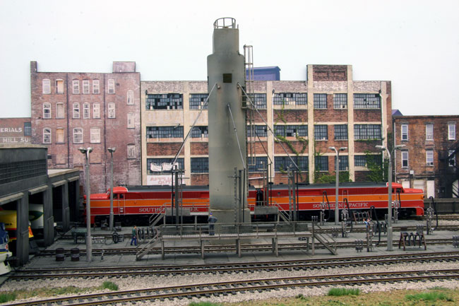

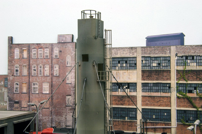

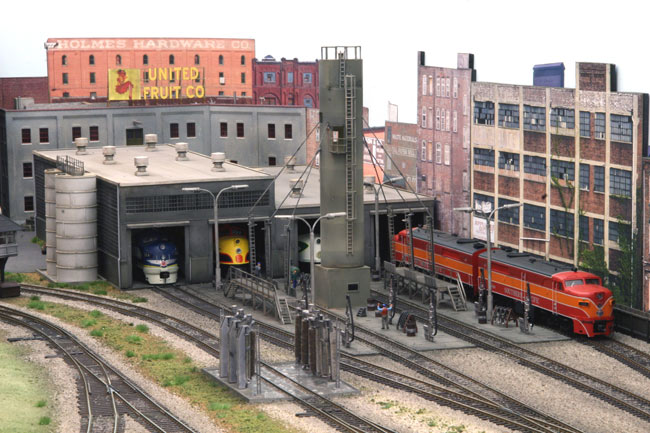

Welcome back! I have completed work on the diesel shop servicing platforms. On the prototype, the fuel and sand facilities were further down the tracks from the actual diesel shop, but due to space constraints, I opted to move them directly in front of it. Of particular interest to me was the very unusual concrete sanding tower. The prototype serviced only one track with platforms on either side. The actual concrete silo stood offset behind the rear platform. Here is a very nice photo of the facility in question.

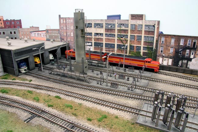

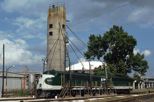

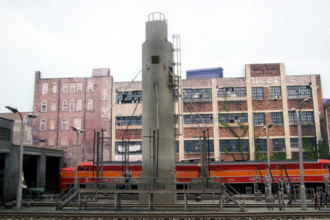

Notice the neat raised top, curved top railings, and frameless “window” openings. Again, space limitations forced me to alter the design so that the tower sits in between two tracks with the platforms on the far side of each. Here is my model of the tower.

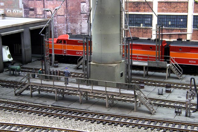

To make the concrete tower, I began with a silo from a Walthers Magic Pan Bakery. The top was cut to create the raised center, then finished with styrene. Openings for the windows and a door were cut based on prototype photos. The sand pipes and cage ladder are modified parts from three Walthers Sanding towers kits.

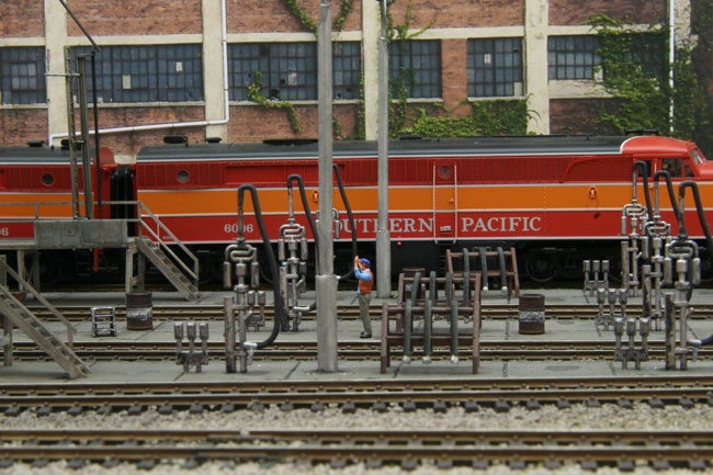

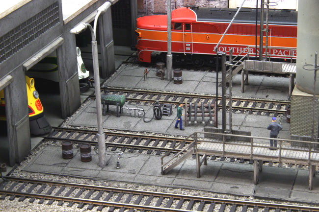

The platforms were kitbashed from two Walthers Oil Loading Platforms with stands from the Sanding Towers kits. The tower was supported by a small square building which I made from the chimney support structure from a Walthers Champion Packing Co. kit.
The fuel stands and hose racks came from a Heljan kit. The lamp poles are modified Model Power lights with styrene tube extensions to add height. Barrels and a few Diamond Scale details have been added as well.

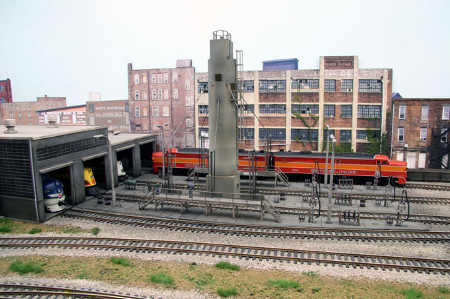

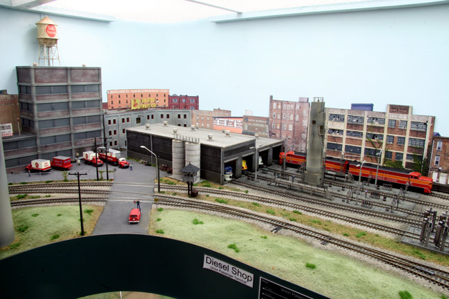

I extended the concrete base all the way up to the diesel shop to better accommodate the sanding tower platforms. I also added several new background buildings in this area. I was never completely satisfied with the steel mill because it looked out of place. I found these backdrop photos on eBay for a very reasonable price. The beauty is they come pre-cut and mounted on black foam board, ready to install. Here are several photos of the completed area.

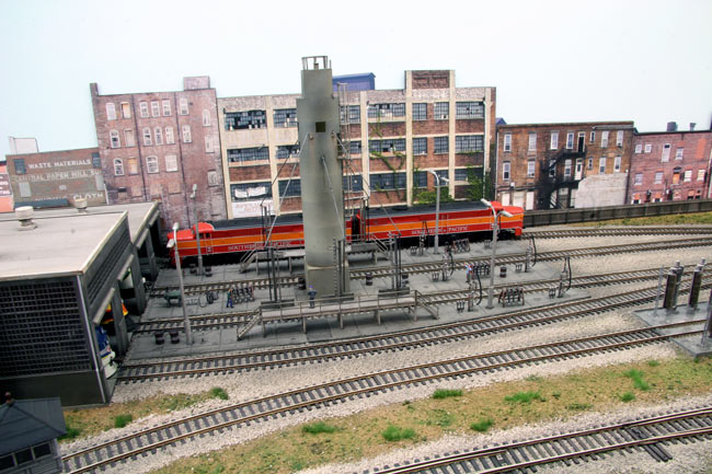

Finally, here is a last look at the completed corner of the layout. I’m very pleased with the finished scene.

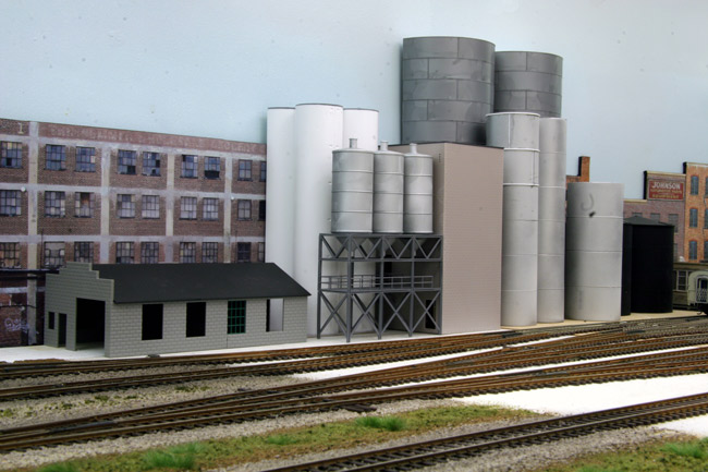

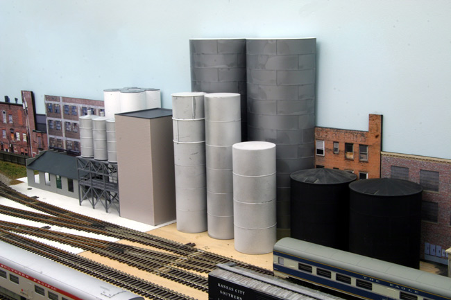

My next project will be the Lime Putty Plant which stood trackside behind the actual sanding tower location. I have already done most of the preliminary construction of the individual components. Painting, weathering, signage, and a multitude of elevators and pipes will make this an eye-catching, yet non-rail served industry. Here is a sneak preview…
If you compare these photos to ones in my last post, you will see that I have replaced several of the components. I plan on putting in some long hours over the Labor Day weekend, so I hope to have an update very soon. See you back then!

Well, once again you've nailed it Cliff! But I have to say what really compliments that scene are in fact the backround buildings. The more I see of these 'photo-buildings', the more I like them! The second photo in your post above had me going. I knew the first one was a prototype photo and at first glance, assumed the second was too. I had to take a second look to realize it was in fact a photo of your model. Well done!
