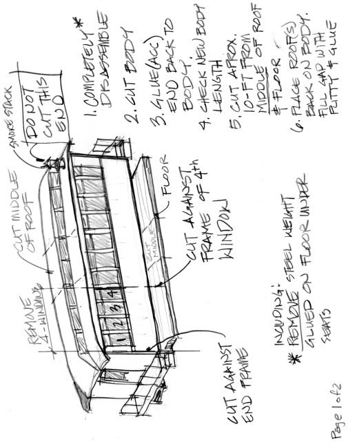

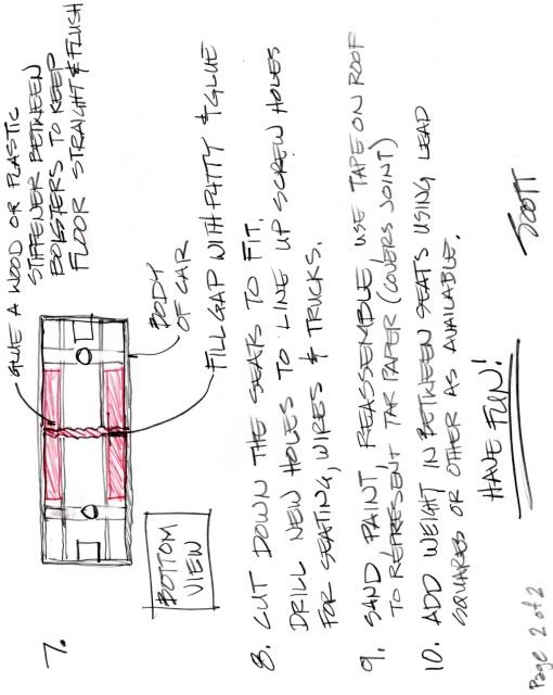

I received an email regarding how I created my short passenger cars. If interested, I have included the quick sketch study "how to" I sent Dave T. It is pretty brief, but I think the major points are identified. Hope this helps. Scott

Uh oh. I got a pulled muscle in my neck trying to read it.

That's why I bought a laptop. I just turned the Lappie on it's side and the instructions were fantastic.
Scott, Thanks for the how to.

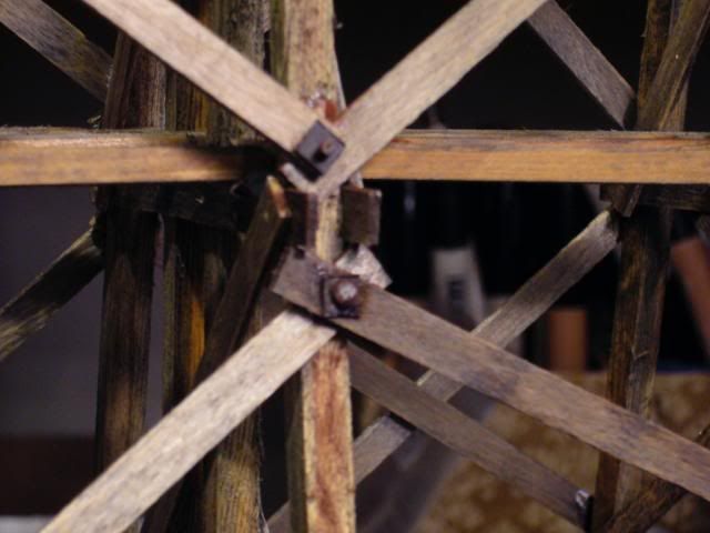

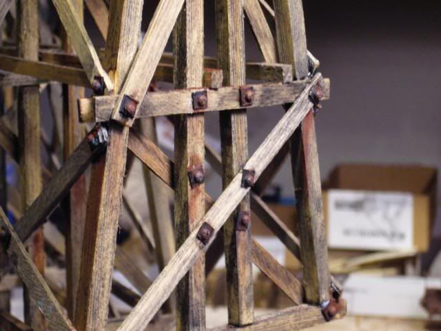

While fixing a damaged trestle for a friend, I decided to experiment and enhance the look by adding Nut/bolt/washer detail. I decided to try Troels technique of cutting solder and gluing to black cover-stock paper. However, I found it difficult to get a clean non-angled cut and to hold the little piece of solder while gluing. So I searched out another alternative and found a package of flat backed clear plastic stick-on jewels at a local craft store. Once I got the hang of sliding the jewel off of the plastic back the remaining glue residue allowed me to use an xacto knife to hold while I put a dab of glue on an already placed square of "plating" (paper). The following are pictures of the results. The first picture shows the solder method above the jewel method. The jewels cost about $2.29 per package of 192 jewels. All in all I think the results are satisfactory, especially when viewed from a normal distance. While not contest quality I think both methods work well. Something else to try! Scott
4525 Posts
Posted - 04/22/2010 :  4:02:18 PM  Show Profile  Reply with Quote
Scott, a neat variation to my solder! I cut the solder in very thin slices with an xacto chisel blade, and bring them to the glue dot on the "washer" on the point of a #11 blade. I agree this is super-realism, but it works very well in real life...

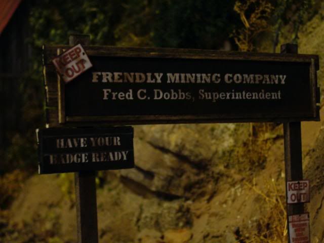

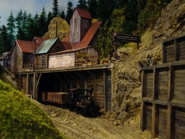

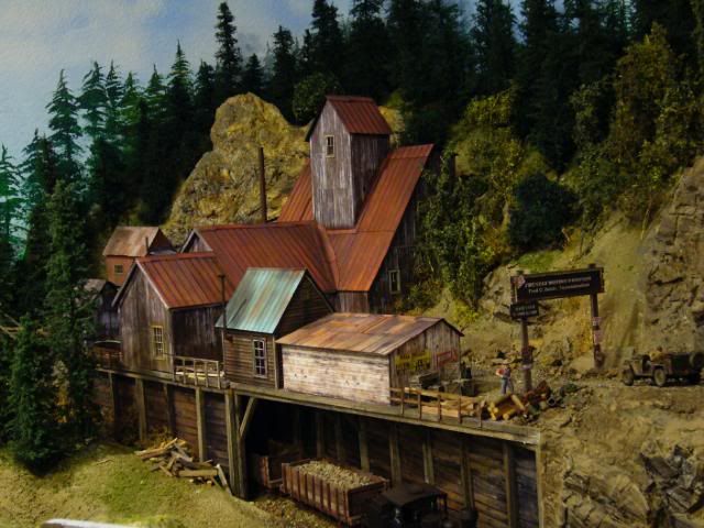

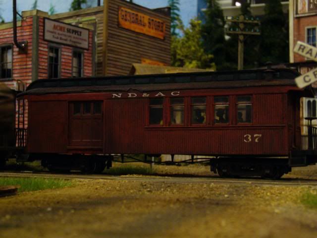

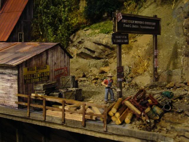

I finally got back around to working on the "Frendly Mine" complex (Fred C. Dobbs, Superintendent - make sure to have your badges ready to enter the area). The work is about 90% done. I plan to add a water tank near the top of the structure, a few more trees, and various other signs/detailing. Sorry the pictures are a little "warm", I was shooting at night under the "house" lights only. I also included a picture of the repainted combine. Scott
MinerFortyNiner
1992 Posts
Posted - 04/26/2010 :  02:23:45 AM  Show Profile  Visit MinerFortyNiner's Homepage  Reply with Quote
Very nice, Scott...I love the mine and the short combine. The Friendly Mining Company sounds like a bad place to trespass... ;o)
